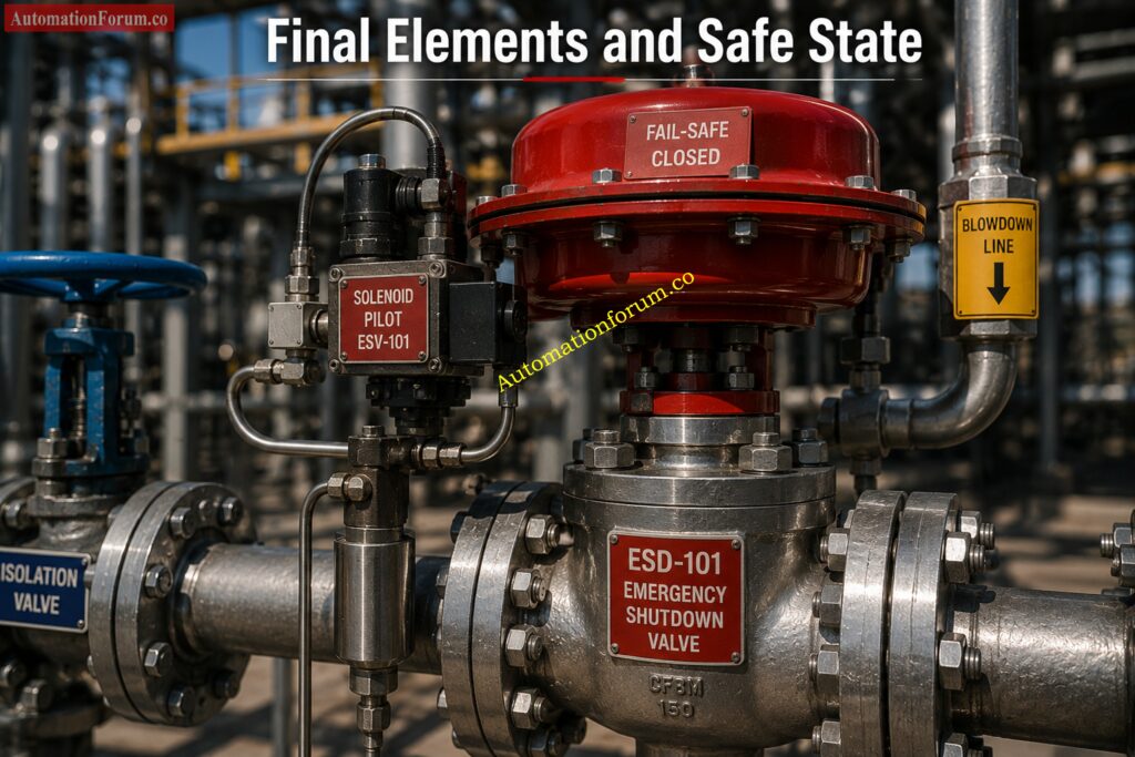

Typical Final Elements
Shutdown SystemTypical Final ElementsPurpose
PSDControl valvesReduce or control process upsets
Shutdown valvesIsolate part of the process when required
Motor startersStop motors connected to process equipment
Variable speed drivesReduce equipment speed during abnormal conditions
Recycle valvesProtect compressors or pumps from unstable operation
Vent or drain valvesRelease pressure or liquid safely
ESDEmergency shutdown valvesQuickly isolate hazardous process sections
Blowdown valvesDepressurize equipment or piping safely
Depressurization valvesLower system pressure during emergency
Fuel isolation valvesStop fuel supply to fired equipment
Master trip relaysInitiate shutdown of multiple equipment items
Solenoid operated valvesDrive fail-safe shutdown action
Critical contactors or breakersRemove power from essential equipment
Meet Functional Safety Obligations Before Compliance Audits Begin:  SIS functional safety requirements
PointExplanation
Final element conditionA shutdown function is only as reliable as the final device that performs the action.
Common failure risksValve sticking, solenoid failure, loss of air supply, or wrong fail-safe position can prevent shutdown.
Engineering importanceProof testing and valve testing are essential in shutdown system design and maintenance.
Explore The Final Safety Barrier Protecting Critical Assets: What is ESDV (Emergency shutdown Valve)? How ESD valve works?

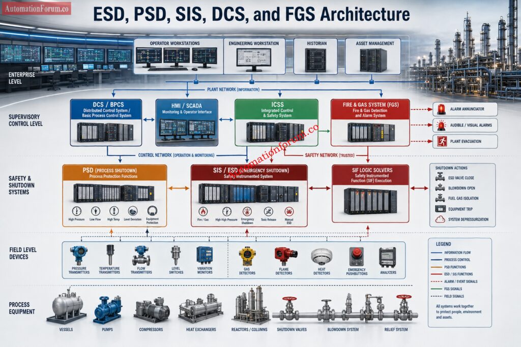

Relationship Between ESD, PSD, SIS, DCS, ICSS, BPCS, and FGS
This is one of the most important practical topics in ESD vs PSD discussions.
The Safety Instrumented System is the broader safety architecture. PSD and ESD functions may both sit inside the SIS depending on the project philosophy, risk assessment, and company standards. Some sites place PSD in the SIS. Others place certain PSD functions in a dedicated shutdown system while ESD remains in the SIS.
High Integrity Protection Explained For Modern Industrial Applications: What is HIPPS?
The Integrated Control and Safety System is often the platform that houses control and safety functions together, but with proper separation in hardware, software, or network architecture. In an ICSS based plant, both PSD and ESD logic may be implemented on the same vendor platform with strict segregation.
The DCS and Basic Process Control System manage normal operation. They are not the same as shutdown logic. A DCS can alarm, control, and sequence normal process actions, but it should not be treated as the final protection layer for hazardous shutdown functions unless the project philosophy explicitly defines a qualified protective architecture.
The Fire and Gas System often triggers ESD actions. This is where FGS and ESD become tightly linked. FGS detects the hazard. ESD executes the emergency response. In many plants, the relationship between FGS and ESD is essential for safe hydrocarbon processing.
Why this separation matters
The control system may try to keep the process running. The shutdown system may need to stop it. That is not a conflict. That is layered protection working as intended.
Discover Critical Shutdown Inputs Protecting High Risk Facilities: Signals for Emergency Valve Shutdown in Critical Processes
