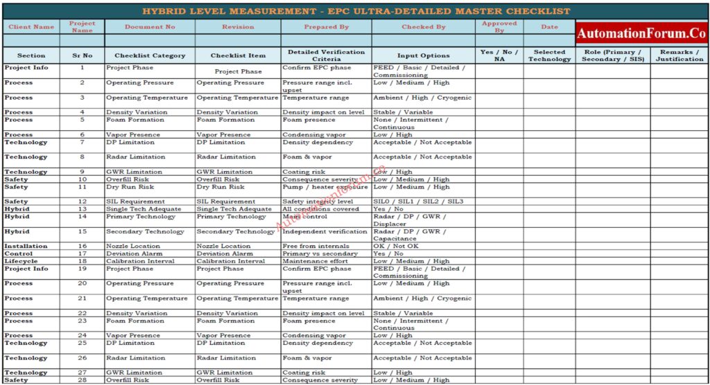

Hybrid Level Measurement Selection Checklist for EPC Engineers
In process plants, hybrid level measurement is necessary since a single level measurement system can’t always handle changing process conditions, safety threats, and operational uncertainties. This Ultra-Detailed Hybrid Level Measurement Selection Checklist helps EPC instrumentation engineers by giving them an organized and useful way to look at process conditions, technology limits, safety needs, and control strategies.
Hybrid Level Measurement Selection Checklist for EPC Engineers -1
The checklist comes as a single sheet Excel tool with built-in drop-downs, conditional formatting, SIL logic indicators, and document control fields. This makes it useful for FEED, engineering, HAZOP, SIL investigations, and commissioning.
