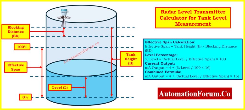

Blocking Distance (BD) is an important part of radar level measurement that people often forget about. It means the shortest distance from the radar antenna where measurements can’t be made properly. This dead zone is there because the radar sensor needs time to convert from sending to receiving after sending out the electromagnetic wave.
  • Typical Range: 0.1 to 0.5 meters (depends on the radar frequency and the maker)
  • Frequency Dependence: Compared to lower frequency units (6 GHz or 26 GHz), higher frequency radars (80 GHz) usually have shorter blocking distances.
  • Installation Consideration: The transmitter must be situated so that the blocking distance stays above the highest fill level that is expected.
  • Measurement Span: The effective measuring span is the height of the tank less the distance that blocks it.
  • Configuration: Always set the transmitter to the effective span, not the full height of the tank.

Radar Level Transmitter Calculator - Free Excel Tool - Visual Understanding
Referring to the tank diagram:
  • Top Section: Blocking Distance (dead zone) – can’t be measured
  • Middle Section: The Effective Span is where the 100% level is set.
  • Full Range: From 0% (the bottom of the tank) to 100% (the top of the effective span)
  • Empty Distance: The distance from the water’s surface to the bottom of the tank when it is empty.

Let’s make the math easier to understand by breaking it down into simple steps and using a real-world example.
Consider a water storage tank with:
  • Tank Height (H): 6 meters (total physical height)
  • Blocking Distance (BD): 0.3 meters (manufacturer specification)
  • Zero Point: Tank bottom (0% level)
  • Full Point: Top of effective span (100% level)
Calculate the effective span: Effective Span = Tank Height – Blocking Distance Effective Span = 6 – 0.3 = 5.7 meters
This 5.7 meters is your actual measurement range for calibration.
Find out the real water level from the bottom of the tank by using a dip tape or a reference measurement. For this example, let’s say the water level is 2.85 meters below the surface.
The formula for percentage calculation is:
% Level = (Actual Level / Effective Span) × 100
For our example: % Level = (2.85 / 5.7) × 100 = 50%
The standard formula for linear conversion to 4-20 mA signal is:
mA Output = 4 + (% Level / 100 × 16)
For our example: mA Output = 4 + (0.50 × 16) = 12.0 mA
Result: At 2.85 m water level in a 6 m tank with 0.3 m blocking distance, the transmitter will output 12.0 mA, representing 50% level.

Here are all the formulas you need for quick reference:
Effective Span Calculation: Effective Span = Tank Height (H) – Blocking Distance (BD)
Level Percentage: % Level = (Actual Level / Effective Span) × 100
Current Output: mA Output = 4 + (% Level / 100 × 16)
Combined Formula: mA Output = 4 + [(Actual Level / Effective Span) × 16]
