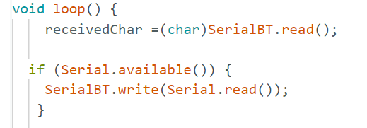

void loop() {
    receivedChar =(char)SerialBT.read();
  if (Serial.available()) {
    SerialBT.write(Serial.read());

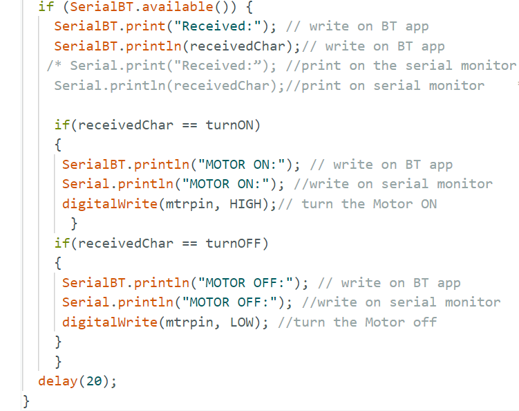

  if (SerialBT.available()) {
    SerialBT.print(“Received:”); // write on BT app
    SerialBT.println(receivedChar);// write on BT app
    if(receivedChar == turnON)
     SerialBT.println(“MOTOR ON:”); // write on BT app
     Serial.println(“MOTOR ON:”); //write on serial monitor
     digitalWrite(mtrpin, HIGH);// turn the Motor ON
    if(receivedChar == turnOFF)
     SerialBT.println(“MOTOR OFF:”); // write on BT app
     Serial.println(“MOTOR OFF:”); //write on serial monitor
     digitalWrite(mtrpin, LOW); //turn the Motor off
  delay(20);

  1. In the loop function, data is sent and received via Bluetooth Serial.
  2. The if statement checks to see if bytes are being received via the serial port. In this example, data will be sent from the computer to the ESP32 via serial communication.  If the data is available, send it to the connected device via Bluetooth. i.e., smartphones.
  1. SerialBT.write() sends data to the connected device via Bluetooth serial protocol.
  2. SerialBT.write() sends data to the connected device over Bluetooth serial.
  3. Serial.read() returns the data received via the serial port.
  4. The if statement determines whether there are bytes available for reading in the Bluetooth Serial port. If there are any, we will write them to the computer’s Serial Monitor.
  5. receivedchar receives input from the Android device. i.e. 1 or 2. The if statement executes the corresponding output. If 1 is received, the motor will turn ON, and 2 will turn it OFF.
