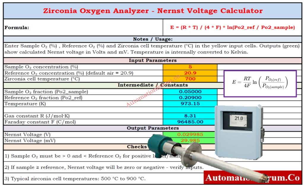

Introducing the Zirconia O₂ Analyzer Nernst mV Output Calculator
This Excel tool will tell you exactly how many millivolts a zirconia oxygen sensor will put out based on the temperature and the amount of oxygen in the air. This calculator gives you quick, accurate answers whether you’re constructing combustion control systems, calibrating analyzers, or learning about how to measure oxygen.
Key Features of the Calculator
- Automatically calculating the Nernst voltage for a set of process and reference conditions
- Quick access to preset settings including Air, Flue Gas, and Pure O₂
- You can set the oxygen fraction or temperature to whatever you want.
- Changing the temperature from °C to K in real time
- Easy-to-use user interface with clear formatting and fields that are automatically calculated
- No macros or add-ins are needed; it works in regular Microsoft Excel.
- Excellent for engineers, technicians, and students that work with process and combustion control

How the Calculator Works – Step by Step
The Zirconia O₂ Analyzer Nernst Calculator has a clear and logical approach. This is how to utilize it:
1. Input Gas Selection
- Air (21% O₂)
- Flue Gas (5% O₂)
- Pure O₂ (100%)
For easy setup, each preset automatically fills in the correct oxygen partial pressure.
If the amount of oxygen in your process gas is different, just overwrite the cell and type in your own value.
2. Set the Temperature
For example, 700°C, 800°C, or 900°C, enter the operating temperature in °C. The calculator automatically converts this to Kelvin (K) internally using the formula:
T(K)=T(°C)+273.15
3. Reference Gas Input
The reference gas is set to air (0.2095 atm O₂) by default, however you can change it if your analyzer uses a different reference atmosphere, like controlled calibration gas.
4. Get Instant Results
After the data is supplied, the calculator uses the exact values for R, F, and temperature correction to figure out the Nernst EMF (mV) output. The answer is the voltage output that the zirconia cell should give under the given conditions.
Tips for Selecting the Right Sensor System: 6 Factors to Consider When Choosing an Oxygen Analyzer for your Application
Practical Examples of Zirconia Analyzer Calculations
Here are some real-life instances of how this calculator can help:
Example 1: Measuring Flue Gas Oxygen
Conditions:
- Reference Gas = Air (0.2095 atm O₂)
- Sample Gas = Flue Gas (0.05 atm O₂)
- Temperature = 800°C (1073 K)
Calculated Output:
The calculator says about +46 mV, which means that the flue gas has less oxygen than the reference air. This helps operators get the air-to-fuel ratio just right for good combustion.
Example 2: Process Gas with 10% Oxygen
Conditions:
- Sample Gas = 0.10 atm O₂
- Temperature = 750°C (1023 K)
Calculated Output:
The mV output is positive but smaller (around 29 mV), which is what you would expect since the difference in O₂ partial pressure is also less.
Example 3: Pure Oxygen as Sample Gas
Conditions:
- Sample Gas = 1.00 atm O₂
- Temperature = 700°C (973 K)
Calculated Output:
The calculator shows a negative mV result (-48 mV) because the sample gas has more oxygen than the reference gas.
These outputs are what a genuine analyzer would do, and they can be used to check calibration data or field measurements.
