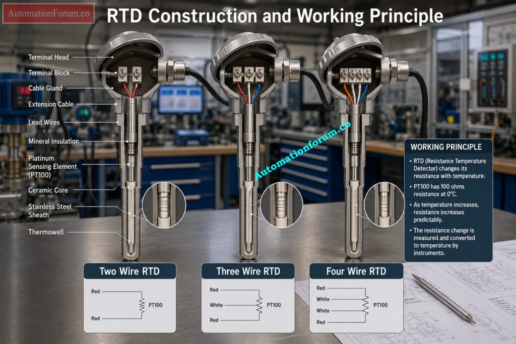

A Resistance Temperature Detector (RTD) is a temperature sensor based on the change of electrical resistance of a metallic sensing element.
Platinum RTD Working Principle
Platinum is the preferred material because its resistance changes in a highly predictable manner over a wide temperature range.
The most widely used industrial sensor is the PT100, which has a resistance of 100 ohms at zero degrees Celsius. PT1000 sensors are also common where higher signal sensitivity is required.
Industrial RTDs are generally available in three wiring configurations.
Two Wire RTD
The simplest arrangement where lead wire resistance directly affects measurement accuracy. It is normally used only for short cable runs.
Never Misconfigure Temperature Transmitters During Critical Plant Commissioning: How to Calibrate RTD transmitter?
Three Wire RTD
The most common industrial configuration. It compensates for lead resistance and provides accurate measurements for PLC, DCS, and temperature transmitters.
Four Wire RTD
Used for laboratory measurements and critical industrial applications requiring the highest possible accuracy by eliminating lead wire resistance errors.
