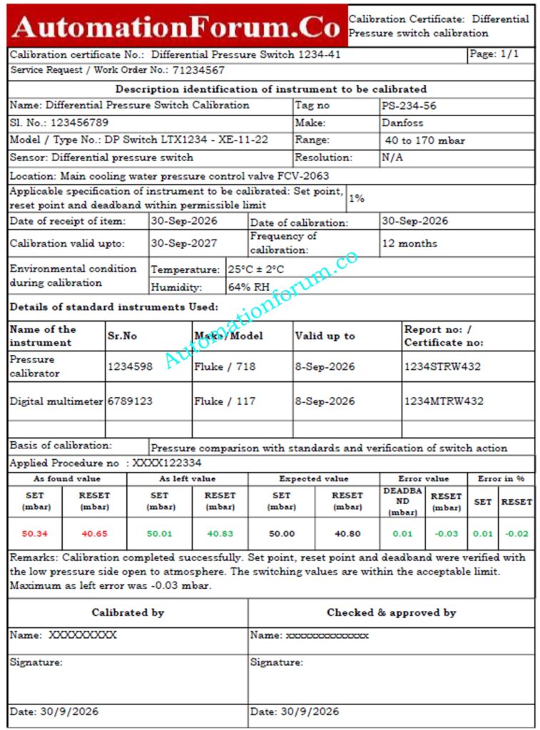

Adjustment steps
  • Find the screw for adjusting the set point
  • Make tiny changes progressively.
  • Repeat the calibration cycle.
  • Check the new set point
After making an adjustment, you should always check it.

Do a final check after making changes.
Steps
  • Do the whole calibration cycle again.
  • Check the accuracy of the set point
  • Check the reset point
  • Confirm the deadband
Calibration is only complete after successful verification.

The image that follows represents a typical differential pressure switch calibration report, which includes set point and reset point recorded during calibration.
Sample Differential Pressure Switch Calibration Report
The calibration report generally includes
  • Instrument tag number
  • Range of the DP switch
  • Set point value
  • Reset point value
  • Deadband calculation
  • Tolerance limits
  • As found and as left readings
Calibration results must be documented properly to ensure traceability and compliance with standards.
