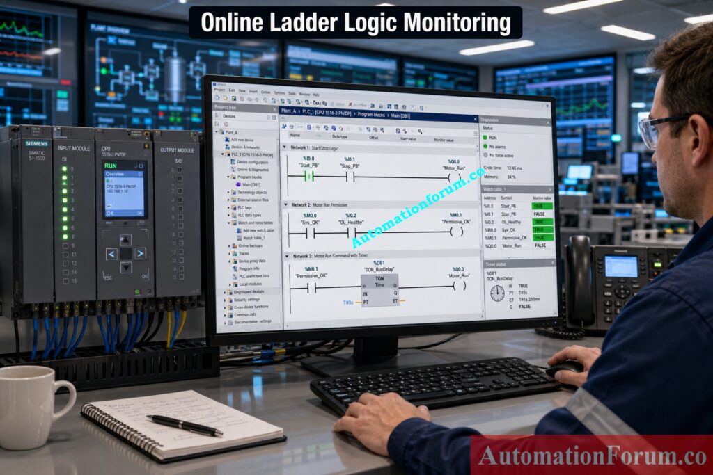

Step 3 Monitor Ladder Logic Online
One of the fastest ways to determine the cause of a PLC output failure is to employ online ladder monitoring. Follow the logic rung that controls the output and observe which instruction is preventing the output coil from energising. A single open contact can stop the entire sequence. Monitoring the program in real time allows engineers to pinpoint the exact condition that is blocking the output.

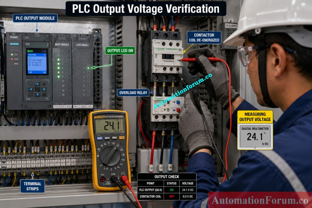

Step 7 Inspect the PLC Output Module
If the software instructs the output and the Output LED is OFF, check the output module. Check module diagnostics, check output power supply and check any built in fuse protection. If the output channel is broken or if the supply voltage is lacking, the module will not switch appropriately.
Check the relay contacts for wear or burning for relay outputs. For transistor outputs, measure the output voltage with a calibrated multimeter and compare it with the standard given by the manufacturer.

If the PLC Output LED is ON but the equipment is not responding, investigate in the field. Measure the output voltage at the PLC terminal, the interposing relay and the final actuator. Check for continuity of cables, loose connections, damaged connectors, junction boxes. Measure resistance of contactor coils, solenoid valves and relay coils for open or short circuits.
Where pneumatic or hydraulic actuators are used, verify that adequate air pressure or hydraulic pressure is available. A healthy PLC output cannot operate an actuator if the utility supply is missing.

How can online ladder monitoring help during troubleshooting?
The current condition of contacts, coils, timers, counters and memory bits are shown in real time via online monitoring, enabling engineers to determine the particular instruction that is stopping an output from energizing.

Why are voltage measurements important during PLC troubleshooting?
LED indications by themselves cannot verify that the field equipment is receiving the right voltage. Taking a voltage reading at each point helps you identify open circuits, blown fuses and bad components.
