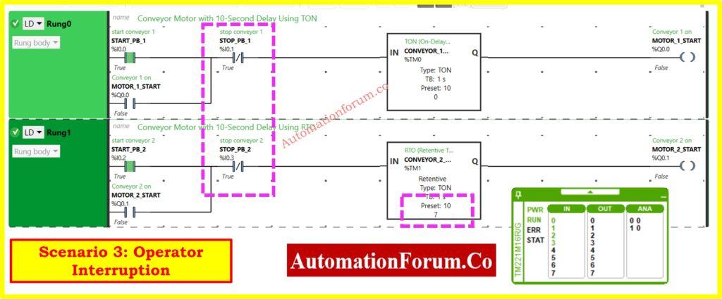

Ladder Logic Implementation in EcoStruxure Machine Expert
The practical implementation shows two conveyor systems that run at the same time but use different types of timers. This side-by-side comparison shows that TON and RTO clocks work in quite different ways.
Rung 0: TON Timer Configuration
The first rung uses the TON timer to add a typical delay to the start of the conveyor:
- Input Logic: START_PB_1 (%I0.0) sends the signal to start.
- Safety Interlock: STOP_PB_1 (%I0.1) makes a normally closed stop control for the safety interlock.
- Timer Block: %TM0 configured as TON with 10-second preset
- Output Control: Timer Q output directly energizes MOTOR_1_START (%Q0.0)
The series connection makes sure that both starting and stopping the timer are necessary for it to work.
Rung 1: RTO Timer Configuration
The second rung is like the first, except it has a retentive time feature:
- Input Logic: START_PB_2 (%I0.2) mirrors the start function
- Safety Interlock: STOP_PB_2 (%I0.3) provides identical stop control
- Timer Block: %TM1 configured with retentive capability enabled
- Output Control: Timer Q output controls MOTOR_2_START (%Q0.1)
The same circuit configuration makes it possible to fairly compare how timers work..

Timer Properties Configuration
The timer configuration table shows the main difference between the two implementations:
- %TM0 (CONVEYOR_1_TIMER): Standard TON configuration, non-retentive
- %TM1 (CONVEYOR_2_TIMER): TON with retentive checkbox enabled
The retentive checkbox changes the way ordinary TON works into RTO functionality, which makes the system behave very differently when there is an interruption.

Scenario Analysis: Stop Button Activation
Visual Analysis of Stop Button Impact
The simulation clearly depicts how the two groups reacted differently:
- Both motor outputs go to False state, which means the motors have stopped.
- The way timers respond is very different between TON and RTO implementations.
TON Timer Response to Stop Activation
When STOP_PB_1 activates during the timing sequence:
- Immediate Reset: Timer accumulated time resets to zero
- Output Deactivation: Motor output immediately goes false
- Memory Loss: All timing progress is lost
- Restart Requirement: Full 10-second cycle needed on restart
RTO Timer Response to Stop Activation
When STOP_PB_2 activates during the timing sequence:
- Time Preservation: Accumulated time remains stored
- Output Deactivation: Motor output goes false (motor stops)
- Memory Retention: Timing progress preserved for resume operation
- Resume Capability: Timing continues from stored value on restart

- Teach operators why one conveyor starts up quickly and the other takes longer to do so.
TON vs RTO – Side by Side Comparison
Here’s a quick comparison recap:
| Feature | TON Timer | RTO Timer |
| Accumulator Behavior | Resets to 0 on input OFF/power loss | Retains elapsed time until reset |
| Power Loss Recovery | Always restarts from 0 | Resumes from last stored value |
| Reset Required? | No | Yes (explicit rung) |
| Best Suited For | Simple delays, alarms, interlocks | Critical processes needing continuity |
| Example Application | Motor start delay, buzzer alarms | Conveyor sequencing, batch processing |
Choosing the Right Timer for Your PLC Application
A side-by-side comparison of TON and RTO timers using a real conveyor shows that they work in quite different ways, which has a big effect on how efficient and reliable the system is.
Choose TON timers for applications that need guaranteed fresh start behavior, simple delay actions where a restart is okay, and implementations that are sensitive to cost and want programming to be as easy as possible.
Choose RTO timers for applications that are crucial to production and need timing continuity, high-frequency start/stop operations, and manufacturing environments where delays in production have a direct effect on operational efficiency.
Engineers may make smart choices that improve both system dependability and production performance in industrial automation applications when they know these basic differences. Choosing the right timer and following the right configuration and maintenance procedures will make sure that it works reliably while also fulfilling the needs of the application and the priorities of the operation.
Test your knowledge with our PLC Timers Quiz
Refer the below link to Test your knowledge with our PLC Timers Quiz
