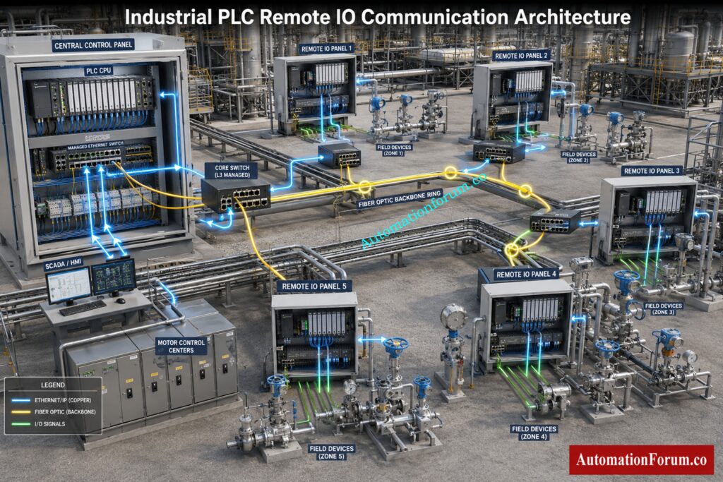

Remote IO refers to distributed input and output stations installed away from the main PLC cabinet and connected through an industrial communication network. Instead of routing hundreds of field cables back to the control room, signals from transmitters, switches, control valves, motor starters, and analyzers are terminated at local Remote IO panels installed near the process equipment.
The remote rack converts field signals into digital communication packets and exchanges them with the PLC CPU over an industrial network. From the controller’s perspective, remote inputs and outputs behave almost identically to local IO modules, even though they may be located several hundred meters or even several kilometers away.
This dispersed architecture allows for plant scalability, reduction in installation costs, ease of maintenance and reduction of the voltage drop associated with long cable runs. Remote IO is commonly utilized in oil and gas facilities, refineries, chemical plants, pharmaceutical production, water treatment systems, power generating, LNG terminals and major manufacturing facilities.
Instantly communicates with each configured remote I/O station. The controller may have an inbuilt connection port or may need a discrete communication module for network connectivity depending on the manufacturer.
Industrial Ethernet switches or fieldbus networks provide the communication path between the controller and remote racks. In larger facilities, managed switches, fiber optic cables, media converters, and redundant communication rings are commonly used to improve network availability.

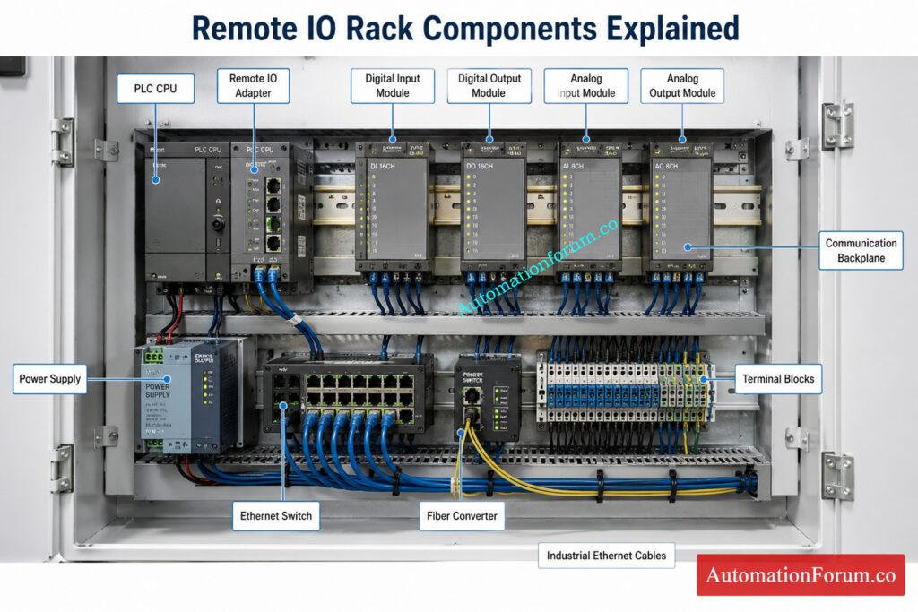

Components of a Remote IO Communication System
Each Remote IO station includes a communication adapter, backplane, power supply, and multiple input and output modules. The data from the PLC is fed to the communication adapter which distributes it across the backplane and receives updated field signals from every installed module before returning to the controller.

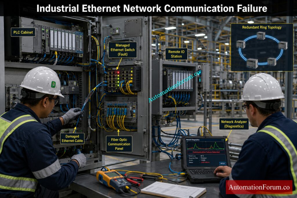

Ethernet IP is one of the most widely used industrial Ethernet protocols in manufacturing and process industries. It exchanges cyclic input and output data using producer consumer communication while simultaneously supporting device diagnostics, configuration, and messaging.
Typical communication failures include duplicate IP addresses, excessive multicast traffic, switch configuration problems, cable damage, firmware incompatibility, and communication timeout events. Engineers should verify IP settings, network topology, switch diagnostics, and controller error logs before replacing hardware.
Profinet supports high speed deterministic communication between PLCs and distributed field devices. Each device is assigned a unique device name and IP address during commissioning.
Communication failures frequently result from incorrect device names, network interruptions, duplicate addresses, configuration mismatches, or damaged connectors. Most engineering software provides device diagnostics showing whether communication is established, interrupted, or degraded.

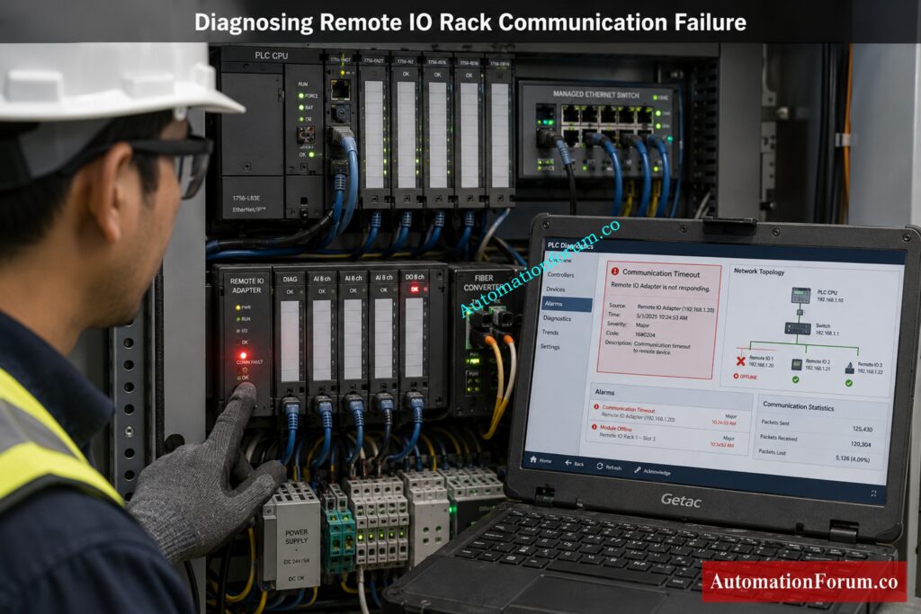

Symptoms of PLC Remote IO Rack Communication Failure
Several symptoms help engineers identify communication problems before replacing hardware.
A communication alarm generated by the PLC usually indicates that the controller has exceeded the configured communication timeout while attempting to exchange data with the remote rack. This alert is commonly observed before to complete IO loss and gives useful diagnostic information.
Discover the PLC Redundancy Strategy Every Reliable Plant Depends On: Understanding PLC Redundancy: Cold, Warm & Hot Redundancy
If all inputs from a remote rack are lost, it is more likely that communication has been lost than that all field instruments failed at the same time . Engineers should instantly test rack power and network connectivity before questioning individual emitters.
Output Modules have the ability to automatically switch to their configured fail safe mode upon loss of communications. Depending on process requirements, outputs may hold their last value, de-energize completely, or move to predefined safe positions.
Intermittent communication failures are particularly difficult to diagnose because the system repeatedly disconnects and reconnects. Usually these faults are caused by things like loose connections , vibration , unstable power supply , moisture , faulty switches or broken fiber optic connections .
Repeated retries, network faults, or communication timeout events often cause communication LEDs on an adapter, a network switch, or a communication module to flash. Understanding LED patterns can save you a lot of time when you are troubleshooting.
Slow controller response, increased communication retries, watchdog timeout warnings, unavailable modules, rack faults, and unusual CPU diagnostic messages also suggest a network performance degradation that must be addressed before total.

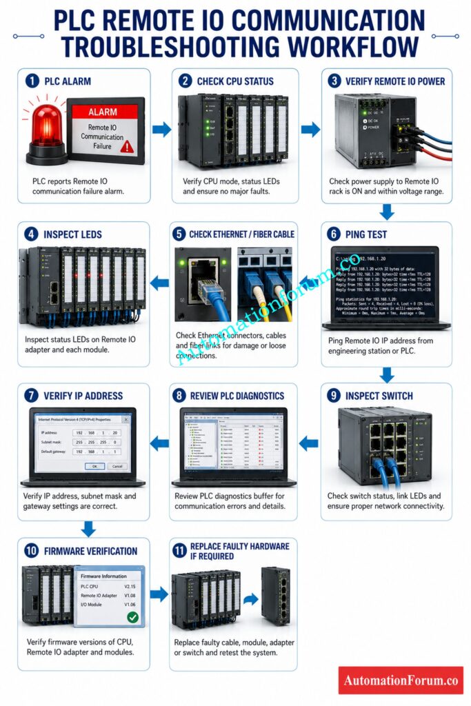

PLC Remote IO Communication Failure Troubleshooting Workflow
This systematic troubleshooting process allows an engineer to find the exact cause of a Remote IO communication failure without changing good components. The flowchart below illustrates some of the most typical procedures used in commissioning and in-service maintenance in process industries.
Begin with the controller alert message in the PLC engineering software or HMI. Note Remote IO rack, communication module, fault code and timestamp. This information helps to evaluate if the failure is localized to one station or to several network devices.
Make that the PLC CPU is in RUN mode and is working normally. Look at the controller diagnostics for watchdog problems, scan time warnings, memory errors, or communication exceptions. If the CPU itself is at fault, you may need to correct the controller problem before Remote IO connectivity can be restored.
Measure the incoming power supply to the Remote IO Panel with a calibrated multimeter. Verify that the voltage is within the working range indicated by the manufacturer and that there is no power supply overload or fuse failure. A healthy communication network will not function properly if the remote adapter is not receiving power correctly.
Find Hidden Logic Faults Before They Stop Production Completely: PLC Permissive Logic Troubleshooting Procedure for Instrumentation Engineers
Check the status LEDs on the PLC communication module, Remote IO adapter, Ethernet switch, fiber converter and power supply. Solid green indications usually indicate normal operation, but flashing red or amber LEDs often signal connectivity retries, hardware issues, or configuration errors. A fast way to narrow the problem area is to match LED patterns to the equipment documentation.
Look at the control panel for loose modules, damaged connectors, bent communication pins, overheated components, dampness, corrosion or evidence of vibration. Most intermittent failures are caused by physical issues, not by software setup errors.
Verify that all industrial Ethernet switches are powered on and functioning appropriately. Check the port LEDs to see if there are any unplugged devices, or if the error numbers are too high. If several of the Remote IO stations go down at the same time, check the network switch before replacing individual racks.
Never Miss Critical PLC Inspection Points During Routine Maintenance: Running Inspection Checklist of PLC Components in Control Panels
Ping test the Remote IO adapter using the engineering workstation. When you get good answers, you have fundamental IP communication. If you get no answers or just some answers, your cable is damaged, your switch is having a difficulty, you are addressing things wrong, or the network is congested.
Check the IP addresses, subnet masks, Gateway settings, Profinet device names, Profibus addresses or EtherCAT node configurations against the authorized project documents. Communication issues are often caused by small configuration errors established during maintenance.
Open the controller diagnostic buffer in the PLC software and check the history of communication faults. Check for timeout failures, unavailable modules, retry counters, lost connection and watchdog events. Often, these logs will specify the particular rack or communication line in which issues occur.
Boost PLC Performance with Proven Speed Optimization Techniques Today: How to Increase PLC Speed: 7 Optimization Tips + Advanced Programming Guide
Check that the Remote IO modules installed are the same as the configuration downloaded to the PLC. Even if the physical network is healthy, wrong module types, slot assignments or firmware updates could prohibit proper communication.
Remove power securely before you inspect the Remote IO backplane. Look for bent connectors, contamination or mechanical damage that would prevent communication between the adapter and individual IO modules.
Disconnect nonessential network segments one at a time if plant processes permit. By isolating parts of the communication network it is possible to identify a particular switch, cable or Remote IO station as the cause of the failure.
Compare firmware version of PLC CPU, communication module, Remote IO adapter and engineering software. Communication issues might occur following system upgrades due to incompatible firmware combinations.
Repair the issue and demonstrate steady communication during a longer observation period. Check diagnostic counters, make sure update rates are normal, and check data exchange with all field devices with no communication retries or occasional disconnects.

The PLC is often not to blame for the problems in industrial communication but the network infrastructure.
  • A Ping test confirms basic IP connectivity between the engineering station and the Remote IO adapter. Failed answers mean errors, broken cables or failures of network equipment.
  • Look at the Address Resolution Protocol ( ARP ) table for duplicate IP addresses or devices that shouldn ‘t be there . Intermittent communication caused by duplicate addresses leads to random controller malfunctions.
  • Packet analysis tools like Wireshark can detect communication retries, excessive broadcast traffic, multicast floods, protocol failures, and anomalous communication delays. Not every defect will require extensive analysis, but it might be useful where intermittent network faults cannot be repeatedly recreated.
  • The network latency should be stable throughout regular operation. Unanticipated increases may be a sign of switch overload, too much traffic or network loops that cause a degradation in controller performance.

One Remote IO rack connected with an Ethernet IP network had recurrent communication failures on a refinery. Operators reported sporadic loss of pressure transmitters and valve feedback signals. The PLC issued random communication timeout alerts many times every shift.
First checks indicated that the Remote IO adapter, communication wires and power supply were all in normal condition. Replacing the module did not address the problem.
Assigning a unique IP address quickly brought back reliable operation. The incident pointed out the need for an approved registration of IP addresses, and for checking the network setup before new equipment is put into service.
Lesson Learned: Always check network addressing before swapping out communication gear.

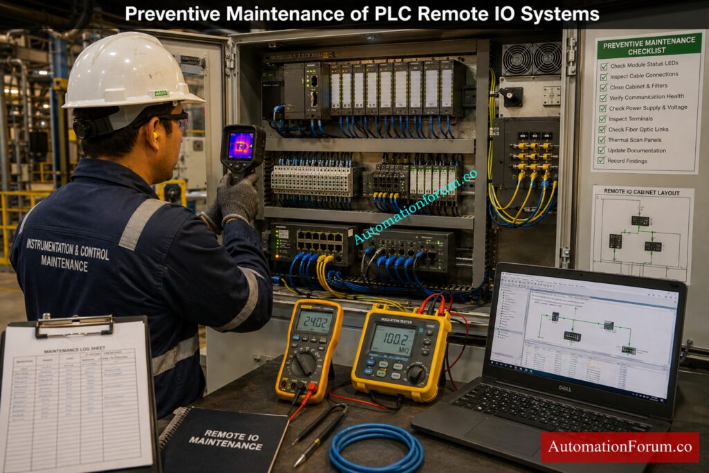

Preventive Maintenance Checklist for Remote IO Systems
A proactive maintenance program can lessen the likelihood of unplanned communication failures.
Daily inspections should confirm that communication alarms are absent, network switches are powered, and controller diagnostics show normal operation.
Monthly maintenance should involve inspecting the cleanliness of the panel, the state of the cable, grounding connections, communication LED status and the voltages of the power supply. Finding loose connectors or degrading cables early saves future failures.
Annual shutdown actions should encompass cleaning fiber optic connectors, tightening communication terminals, checking backplanes, testing redundant communication channels, updating documentation, and validating controller backups via restoration testing.

A failed Remote IO adapter may show error LEDs, frequent connection dropouts, or remain offline even with a good network. PLC diagnostic software can be used to verify adapter problems.

The local IO modules are housed within the main PLC cabinet while the remote IO modules are situated near the field equipment and are linked using an industrial network. Remote IO minimizes wire costs and makes plant expansion easier.

Remote IO systems should be visually checked daily and more completely reviewed during monthly, quarterly and annual maintenance programs. Routine preventative maintenance helps reduce unplanned communication failures and downtime.

A systematic troubleshooting strategy starting with controller diagnostics, power verification, LED inspection, network testing and configuration validation allows engineers to rapidly locate errors and save wasteful hardware replacement. Modern PLC software, controlled switches and network diagnostic tools give useful information that should be always checked before replacing communication components.
