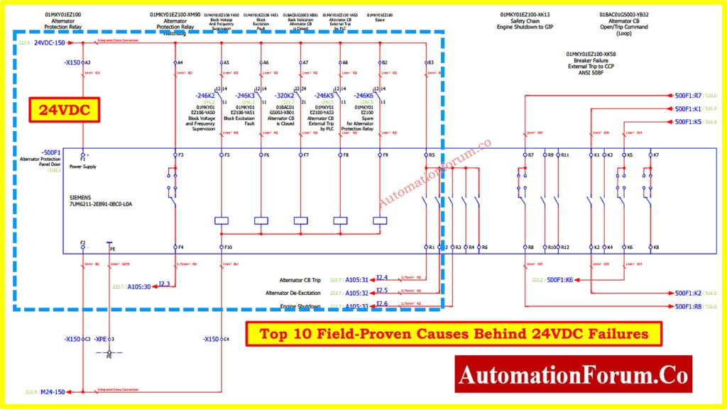

In the field of instrumentation and control systems, 24VDC is the backbone powering everything from analog transmitters and digital sensors to actuators, solenoids, and field I/O modules. In design documents and datasheets, it’s a constant. But in the real world? It can be surprisingly unstable.
One of the most common mistakes during commissioning or fault-finding is assuming that “If my multimeter shows 24VDC, then everything must be working.”
Unfortunately, this is far from true. The presence of voltage does not guarantee performance. A transmitter may still refuse to respond, a digital input may not toggle, or a solenoid may fail to actuate even when the power supply shows 24VDC.
The secret? You must measure under real load conditions.
Top 10 Field-Proven Causes Behind 24VDC Failures
Cause 1. The Illusion of No-Load Measurements
Let’s be clear voltage without current means very little. You can measure 24.2VDC at a terminal with a multimeter, but the instant the device demands power, the voltage can dip sharply. That dip, often invisible to standard checks, is enough to make the equipment malfunction.
This is especially dangerous with smart field devices like HART transmitters, flow meters, or analytical instruments. They might appear powered up, but behave erratically or drop communication if they are underpowered.

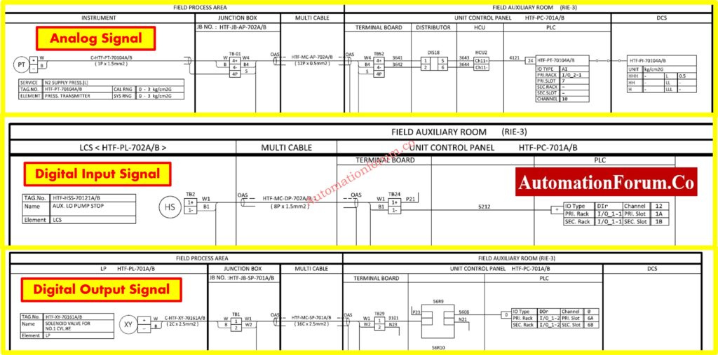

Cause 6. Analog vs Digital Signal Sensitivities
Different I/O types react differently to voltage issues.
Analog (4-20mA):
- Transmitter current accuracy drops with low voltage.
- Some devices stop transmitting entirely below 19VDC.
Digital Inputs:
- Logic level thresholds may not recognize low signals.
- Optical isolators inside DI modules may not activate.
Digital Outputs:
- Output may latch ON, but the load (e.g., solenoid) doesn’t activate due to insufficient voltage.
Pro Tip:
- Use a true RMS multimeter to check voltage ripple.
- For analog signals, ensure loop resistance and voltage remain within device specification (usually >12V at the transmitter terminals).
