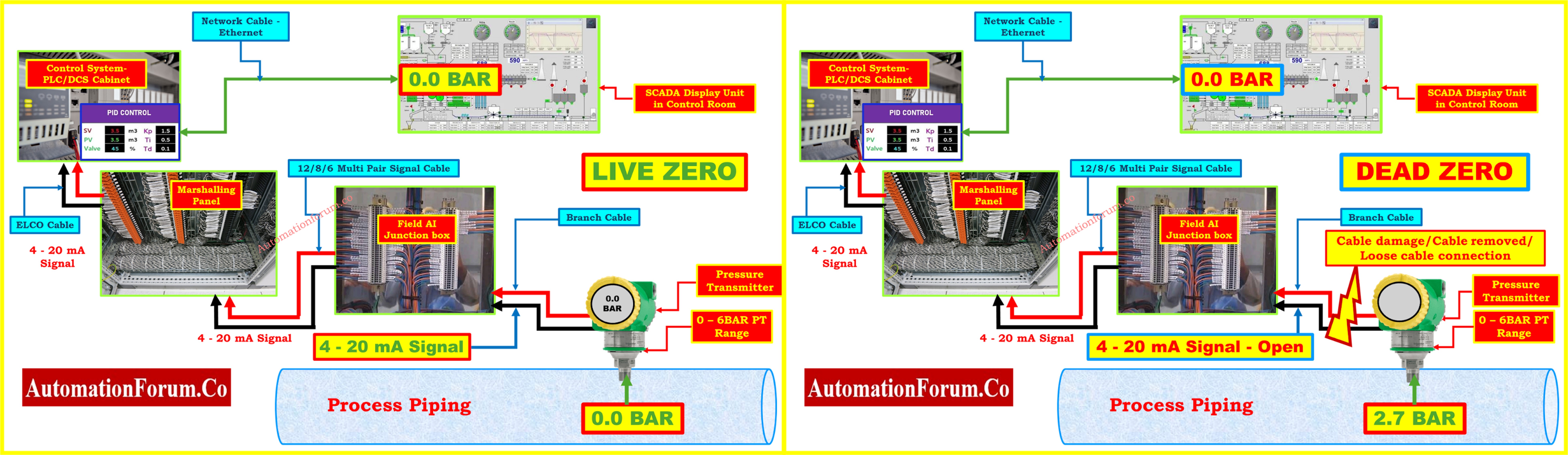

Live Zero Illustration
The pressure transmitter in the above shown live zero image is measuring 0 bar and mounted on process pipes. Still, it is actively producing a 4 mA current that finds the Field AI Junction Box, the Marshalling Panel, and ultimately the PLC/DCS system. The clearly reflecting process state shown on the control room SCADA display is 0.0 BAR.
All components in the signal chain are connected properly:
- Field transmitter is energized.
- Signal cable is intact.
- 4 mA is flowing, indicating 0 bar pressure but a working loop.
Live Zero has been perfectly demonstrated here. 0 process value accompanied by a valid current signal.

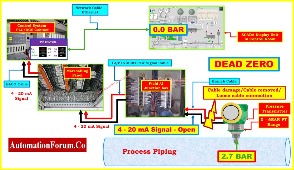

What is Dead Zero?
Dead Zero is the state when the current in the loop is exactly 0 mA, therefore indicating a signal failure or open loop condition. It is a signal of something gone wrong in the loop rather than a real process measuring tool.
In practical scenarios, a current of 0 mA can mean:
- Cable damage
- Transmitter is powered off
- Disconnected wiring
- Blown fuse
- Bad terminal connection
Dead Zero Illustration
The process pressure in the above displayed dead zero figure is 2.7 BAR, which should equate to roughly 10 mA of current in the loop. But the signal wire is disconnected for a problem maybe a loose cable, rust, or physical damage.
The loop thus becomes open.
- The loop becomes open.
- The current drops to 0 mA.
- The controller receives no signal.
- The SCADA display presents misleading 0.0 BAR, which does not represent the true process value.

Assume for a moment that a fire starts in a field area and harms the wire running between the transmitter and junction box. There is still intact the transmitter, and the pressure is 2.7 bar. But the signal cable breaks:
- Current in the loop becomes 0 mA.
- SCADA screen reads 0.0 bar (as shown in the above dead zero image).
- Control room assumes there is no pressure.
- This could result in incorrect control decisions or delayed shutdowns.
This kind of scenario shows the need of knowing the idea of Dead Zero and including signal validation or diagnostics systems.

Both images provided serve as powerful educational tools to reinforce this concept visually:
- The LIVE ZERO image shows a healthy loop operating at 4 mA = 0 bar.
- The DEAD ZERO image shows a broken loop where the actual process value is 2.7 bar, but the control system reads 0.0 bar due to signal loss.
Always remember: Live Zero = Process Zero, Dead Zero = Fault.
