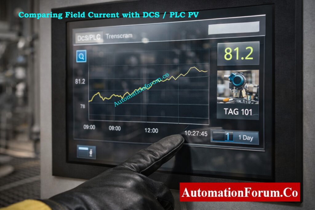

Baseline DCS/PLC Trend Observation
- Pull up the live trend for the tag and observe for at least 3–5 minutes (longer if signal is known to be intermittent).
- Take a screenshot or print the trend and note the start and end times of the observation.
- Record the PV, engineering units, any alarms that are going off, and the input quality/status bits that the DCS/PLC shows.

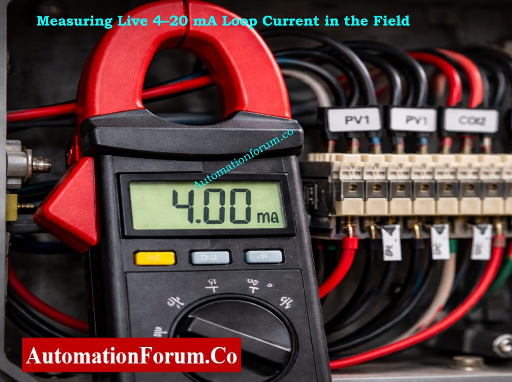

Preferred Non-Intrusive Measurement Using DC Clamp Meter
- Set the clamp meter to DC mA mode (or µA if required). Confirm the clamp can measure DC current for the loop range.
- Separate or spread the conductors so the clamp surrounds only the single positive signal conductor clamping both conductors will read near zero.
- Place the clamp on the positive conductor only, wait for the reading to stabilise, then record: measured mA, time, meter model/ID, and meter calibration date.
- Note any visible cable damage, loose terminals, or corrosion while the cover is off.

Simultaneous Field Current and DCS/PLC PV Observation
- While measuring field current, have an operations person or colleague read and record the DCS/PLC PV and input quality flag at the same instant (synchronise timestamps).
- If you cannot observe both simultaneously, take time-stamped meter readings and immediately capture the DCS PV screenshot with the same timestamp.

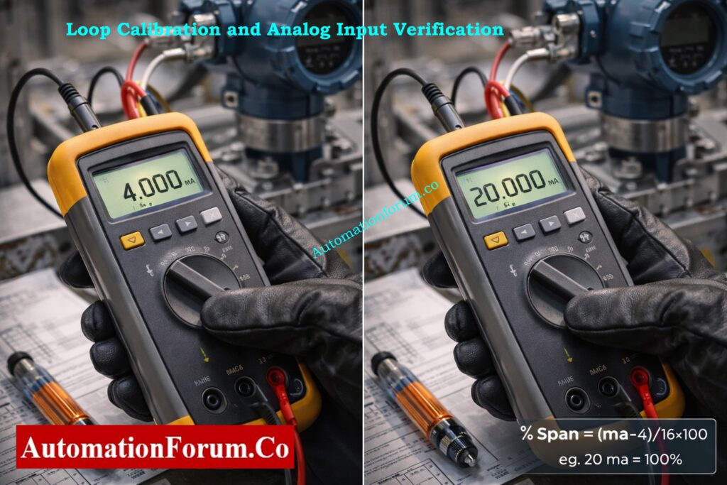

Conversion of Measured mA to Engineering Units
- Convert measured mA to %span: %Span = (mA − 4) / 16 × 100.
- Convert %span to PV: PV = LRV + (%Span/100) × (URV − LRV). Record calculated PV and compare to DCS PV.
- Compute Δ (difference) and Δ as % of span; record whether it is within site tolerance.

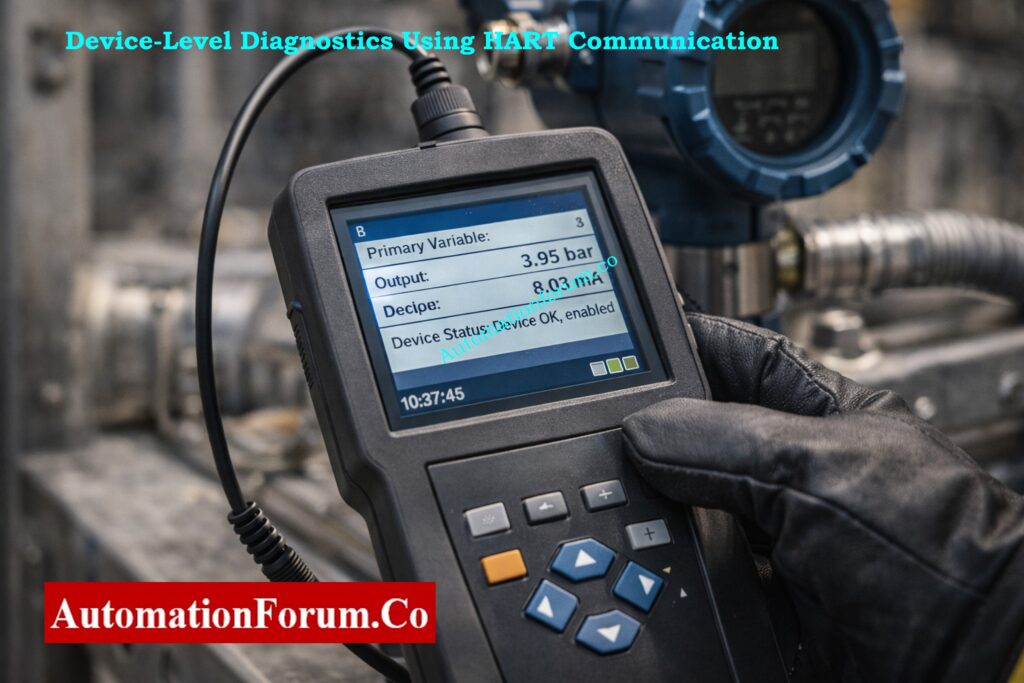

Preparation for HART Communication
- Make sure that the transmitter supports HART and that you have a communicator or interface that is safe to use.
- Find the HART connection point (terminal block, local connector) and make sure that safe connection procedures are followed in dangerous regions.
Reading and Recording HART Parameters and Diagnostics
- Query and log the following: primary variable, output current, device status text, device revision, sensor temperature, diagnostics counters, and last calibration date.
- Get HART event logs, warnings, and any maintenance or problem codes that the device shows.
Interpretation of HART Data Versus Measured Loop Current
- Check the output current that HART reports against what your clamp/meter says; write down any differences.
- If HART says there is a sensor error, offset, or saturation, write down the specific code or text and follow the manufacturer’s instructions for fixing it.
Saving Diagnostic Logs and Evidence
- Take screenshots of the communicator or export a device description log (DD) and add it to the verification record.
