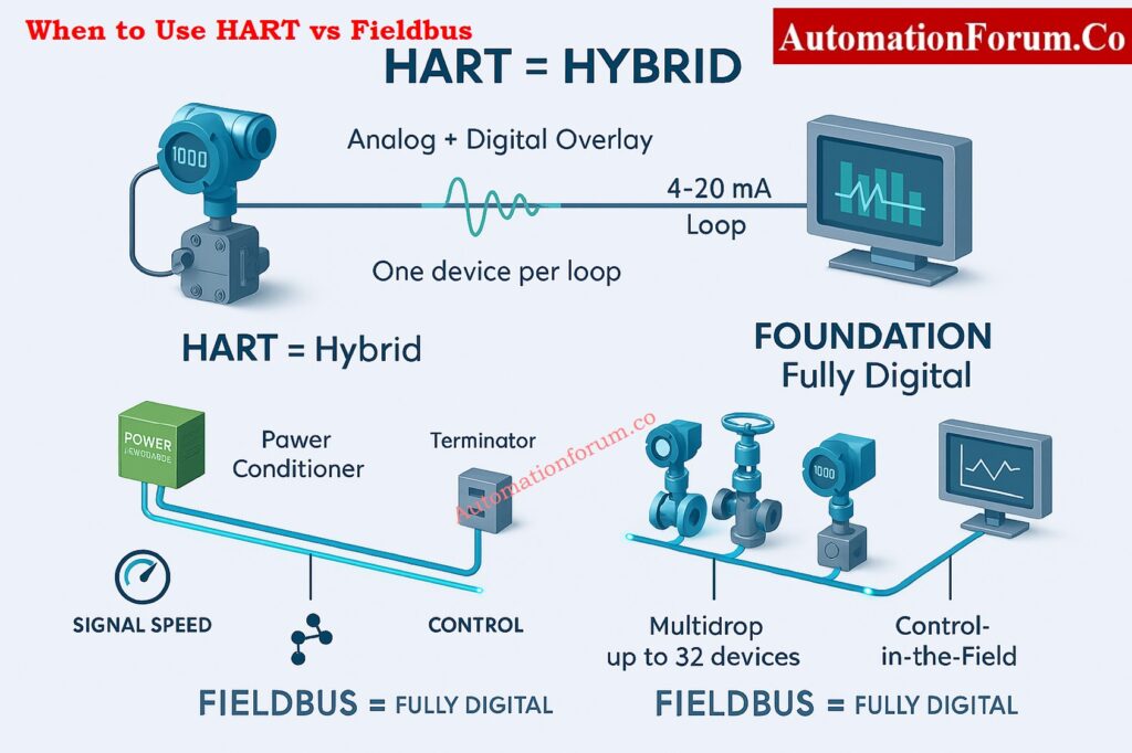

When to Use HART and When to Choose Fieldbus
HART for Brownfield Projects (Plants that are Already There)
For incremental upgrading of old process facilities, HART communication is still the best and most affordable option. It works perfectly with the old 4–20 mA analog infrastructure, so factories may get the benefits of digital data without having to replace their existing wiring, junction boxes, or I/O cards.
HART helps maintenance teams enhance dependability and cut down on manual calibration work by supporting SIS (Safety Instrumented System) upgrades, device diagnostics, and remote configuration. Most plant technicians already know how to use HART portable communicators, so there is no need for a lot of retraining or software changes.
In brief, HART provides a low-risk modernization path that delivers enhanced insights while keeping proven analog reliability.

For new installations and automation methods that put digital first, FOUNDATION Fieldbus is a good investment for the long term. As a totally digital, two-way communication protocol, it cuts down on the need for wire, control cabinet space, and marshalling hardware by a lot. This can save up to 40% on installation expenses.
Fieldbus lets you operate things in the field, so smart transmitters and positioners can run control loops locally. This reduces the strain on the DCS and speeds up the system’s reaction. It also allows condition-based maintenance and has built-in predictive diagnostics. This cuts down on unplanned downtime and maintenance expenses.
From design to commissioning, Fieldbus simplifies loop documentation, device calibration, and troubleshooting. It is ideal for plants that want integrated digital communication across the entire control hierarchy—forming the foundation for smart plants, Industry 4.0, and IIoT (Industrial Internet of Things) architectures.
