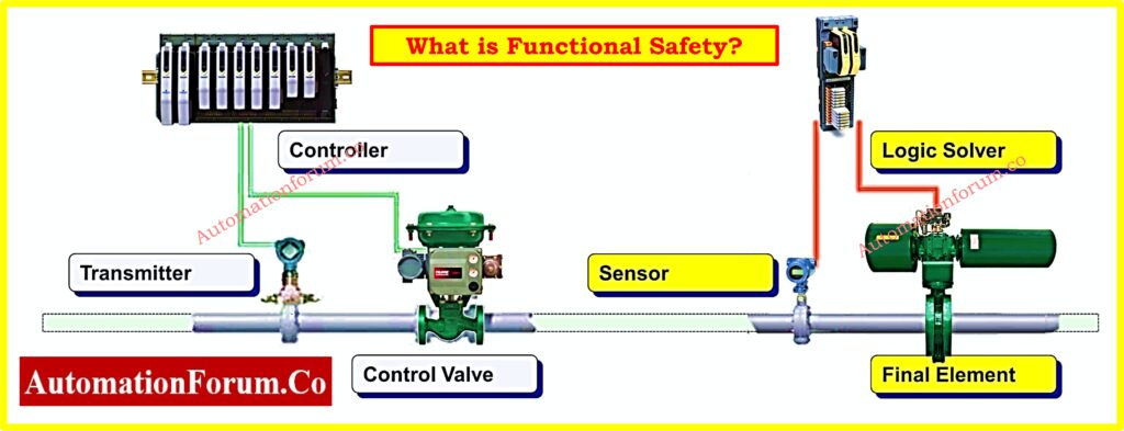

What is Functional Safety?
Functional safety is an aspect of a system’s overall safety that depends on the system responding correctly to its inputs. In particular, it makes sure that if a harmful situation comes up, the system will securely control, stop down, or bypass the process to keep people safe.
If a pressure transmitter finds that a vessel is under too much pressure, the safety system must make sure that the right relief valve opens or the compressor stops working to keep the vessel from breaking.
Functional safety systems are designed to:
- Find unsafe situations.
- Do automated things to resolve items.
- Reduce risk to levels that are acceptable.

1. Safety Instrumented System (SIS)
When risky process conditions are found, a SIS is a layer of protection that is meant to do certain safety tasks. It has sensors in the field, logic solvers, and final control elements like ESD valves and breakers.
SIS works on its own and is made to be fail-safe, unlike basic process control systems (BPCS).
