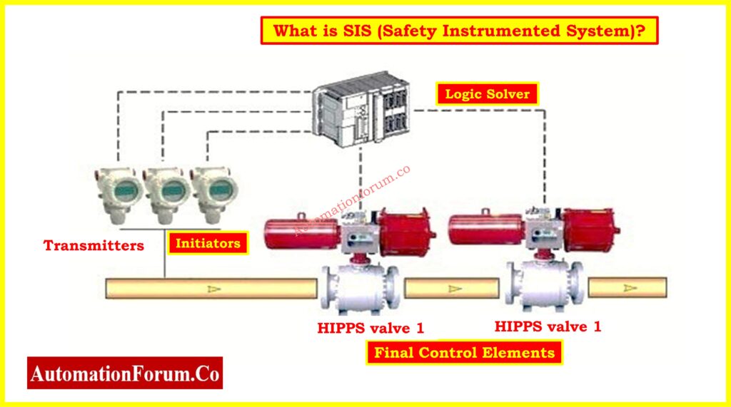

What is SIS (Safety Instrumented System)?
Specifically meant to monitor critical data and start corrective operations in the event of potentially hazardous circumstances, a Safety Instrumented System (SIS) is a separate system. SIS automatically provides the process back to a safe state to protect people, environment, and assets.
Understand the Standards: SIS functional safety requirements
Components of SIS:
- Devices such as gas detectors, flame, and pressure.
- Usually a safety-certified PLC, the logic solver
- Last control components like shutdown valves, solenoid valves, etc.
For instance, the SIS turns off the feed pump and opens a relief valve to prevent an explosion if a reactor’s pressure increases beyond the safe limit.

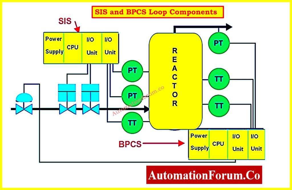

Why Segregate SIS from PLC and BPCS?
A transmitter utilized in both a control loop and a safety loop, for instance, could fail quietly and endanger both systems. SIS components are thus built and certified to high standards, with diagnostics and redundancy to avoid such situations.
Human reliability research also reveals that if they have less than one minute to act, people make the incorrect judgment 99% of the time during crises. SIS automation hence has to run without human involvement.

Reducing Common Cause Failures
To lower the possibility of systematic or common-cause failures:
- Employ various technologies, such as transmitter plus mechanical switch.
- Keep SIS and BPCS wiring and hardware physically apart.
- Select SIL-certified logical solvers including diagnostics.
- Use several architectures.
SIS Loop Components
A SIS is more than simply a controller; it comprises:
- Transmitters (e.g., pressure, level)
- Safety Logic Solver (SIL-rated PLC)
- Last Elements (e.g., shutdown valves, SOVs)
- Additional Devices (e.g., relays, splitters, solenoids)
Every part has to satisfy specified diagnostic and dependability criteria.

Why are SIS and BPCS Separated?
With regard to the following reasons, the separation of SIS from BPCS is absolutely essential:
- Stay clear of software flaws or power loss among other typical cause failures.
- For safety integrity, keep system independence.
- Minimize cyber security threats.
- SIS makes Management of Change (MoC) more strict.
- Avoid incidents caused by human error or defective modifications.
- Guarantees that changes in BPCS do not endanger safety logic.
