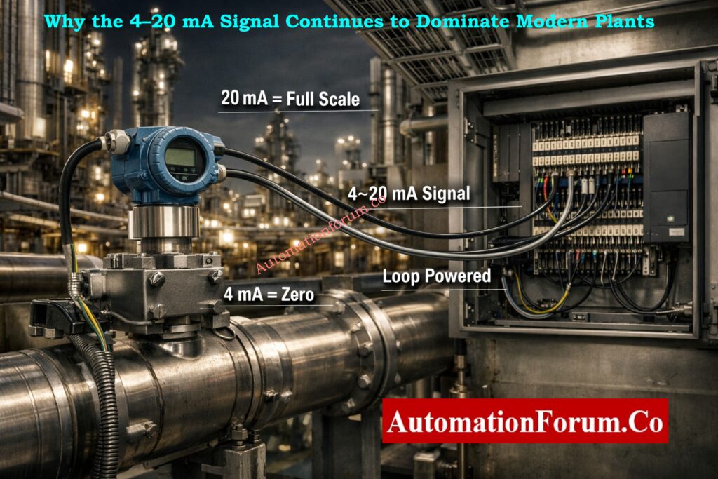

Why the 4-20 mA Signal Continues to Dominate Modern Plants
Technologies change quickly in the field of industrial automation. Every year, new communication protocols, smart instruments, and digital control platforms come forth. Even with all of these improvements, one signal has lasted the test of time and is still the most important in the field. The 4 to 20 mA signal is still the most dependable way to measure and control things in many businesses throughout the world.
The 4 to 20 mA current loop is still the most reliable way to send process data, whether it’s from oil and gas refineries, chemical plants, water treatment plants, or power production units. Engineers and technicians still use this basic but effective signal, even in modern factories with smart gadgets and digital networks.
It’s not because of past. The reason is performance, dependability, and usefulness in real-world industrial settings. This article talks about why the 4 to 20 mA signal won’t go away and lists 10 important elements that every technician should know in order to work with this industry standard safely and confidently.
Understanding the 4 to 20 mA Signal
- The 4 to 20 mA signal is an analog current signal that shows a physical process variable like pressure, temperature, flow, or level.
- A field transmitter takes a process value and turns it into a current that is proportionate to that value, between 4 mA and 20 mA.
- In this system, 4 mA is the lowest process value and 20 mA is the highest process value.
- There is a linear relationship between the measured variable and any value between these two boundaries. In a pressure transmitter that goes from 0 to 10 bars, 4 mA means 0 bars and 20 mA means 10 bars.
- The signal is based on current, not voltage, which makes it much more accurate, immune to noise, and able to be sent over long distances.
- These traits are what have made it so successful in industrial automation for so long.

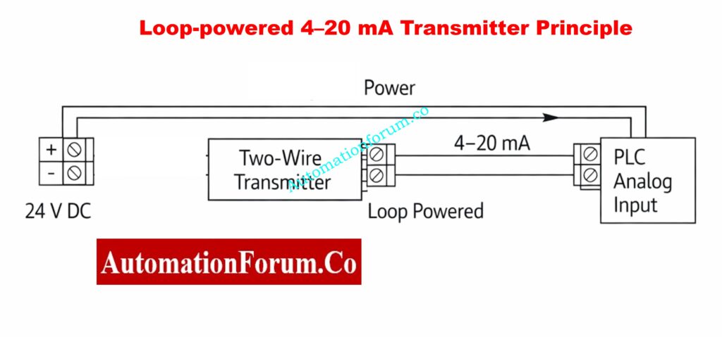

Loop Powered Transmitter Principle
- The loop-powered transmitter idea is one of the best things about the 4 to 20 mA system. The transmitter gets its power and the measurement signal travels over the same two wires in this configuration.
- The loop provides power to the transmitter, which then adjusts the loop current based on the detected process value.
- Technicians should know the following benefits of loop-powered systems.
Benefits of Loop Powered Transmitters
- The wiring is easier because the transmitter doesn’t need a separate power supply cable.
- Costs of installation go down, and the system is less complicated.
- Safety is better, especially in dangerous places where lower power levels are better.
- It can work safely in explosive situations since it works with intrinsic safety barriers and isolators.
- The 4 to 20 mA signal is so popular in many fields, in part because of its attractive appearance.Â

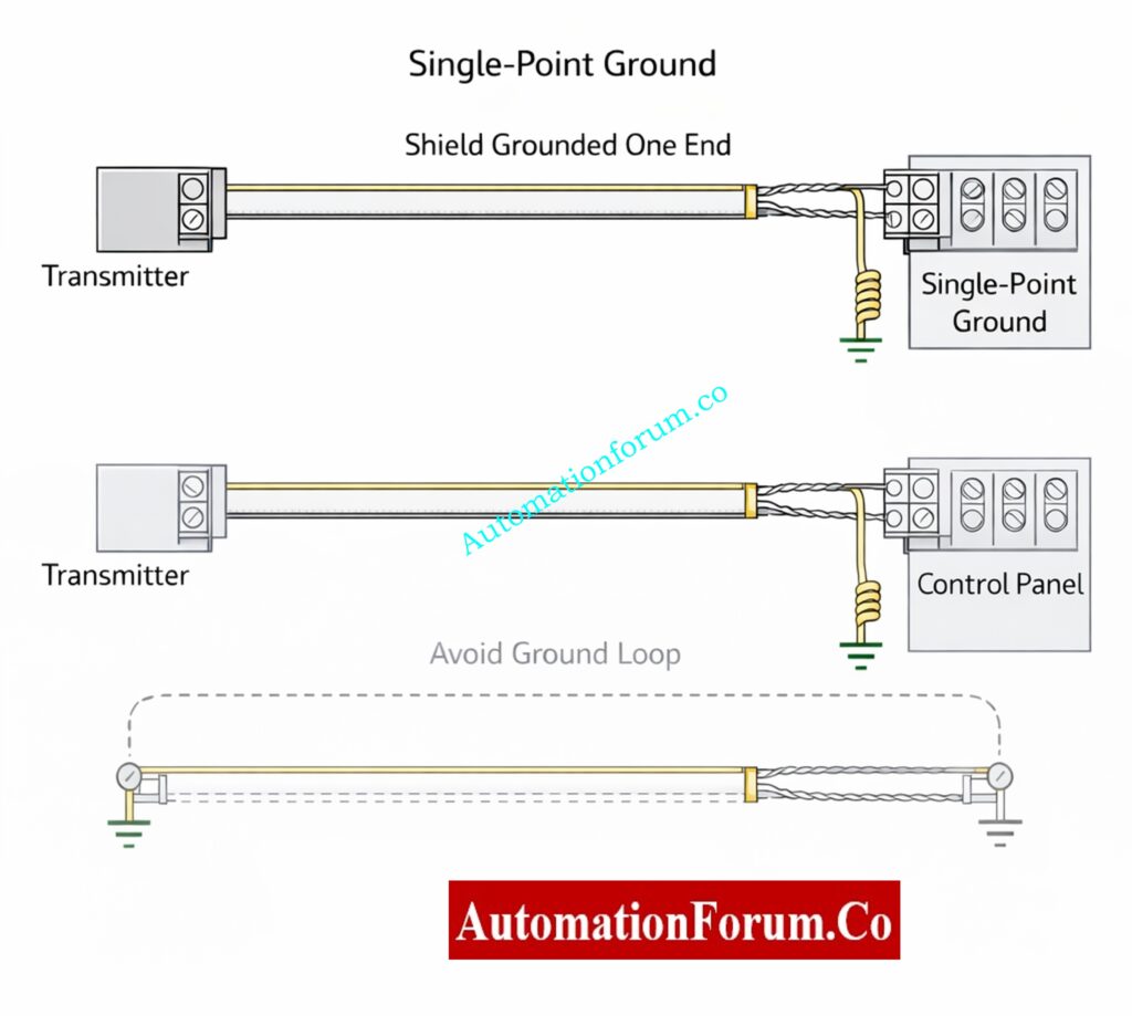

Correct Shielding Practices for 4 to 20 mA Cables
- People often use shielded cables for 4 to 20 mA signals to keep electromagnetic interference from happening. But shielding won’t work if it’s not done well.
- The most crucial guideline is to only ground the cable shield at one end, usually the control panel side.
- Technicians should keep the following important considerations in mind.
- If you ground both ends of the shield, you can make a ground loop through the shield itself.
One-End Shield Grounding Rule
- A single point shield ground keeps noise out without causing interference.
- The shield should stay in place all the way down the cable line.
- Using the right shielding techniques makes signals much clearer and systems much more stable.
