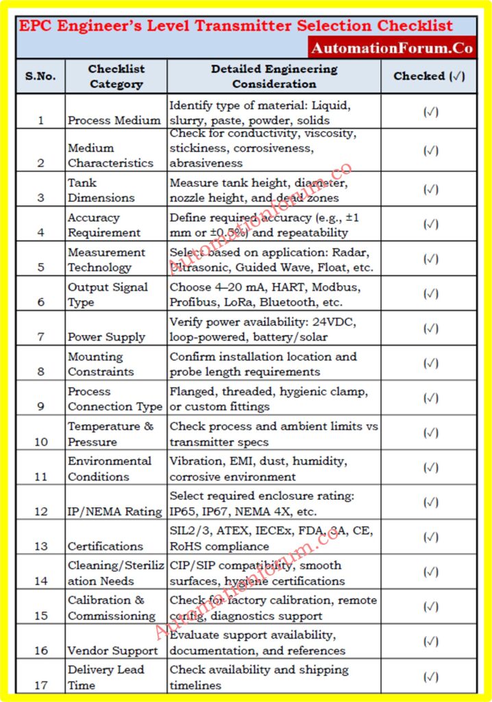

Level Transmitter Selection Checklist – EPC Instrumentation Engineer
This checklist supports instrumentation engineers working in EPC projects during FEED, detailed design, procurement, FAT, and commissioning stages to evaluate and select appropriate level transmitters. It ensures comprehensive assessment across process compatibility, safety, compliance, and installation requirements.
Refer the below link to download the Level Transmitter Selection Checklist – EPC Instrumentation Engineer
