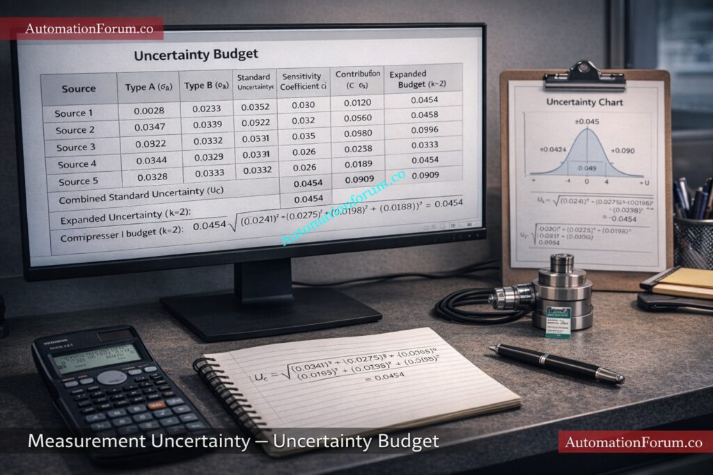

Measurement Uncertainty In Calibration Practical Guidance
Test Uncertainty Ratio TUR and Acceptance Criteria
Test Uncertainty Ratio TUR is the ratio of allowable tolerance to calibration uncertainty. A common guideline is the four to one rule which suggests calibration uncertainty should be at least four times smaller than device tolerance. This rule reduces false accept risk but is only a heuristic Use a risk based decision that accounts for safety and quality consequences when setting acceptance rules.
Manual tracking of calibration data increases audit risk: Best Calibration Management Software
Step By Step Measurement Uncertainty Evaluation Process
- List all significant uncertainty components including instrument noise reference standard uncertainty environmental effects and resolution.
- Quantify type A components by statistical analysis and type B components by reasoned estimates or manufacturer data.
- Combine standard uncertainties by root sum square to generate combined standard uncertainty.
- Multiply by coverage factor to produce expanded uncertainty and document the method.
Provide uncertainty budgets for critical measurements and reference them in calibration certificates or in linked laboratory documents.
