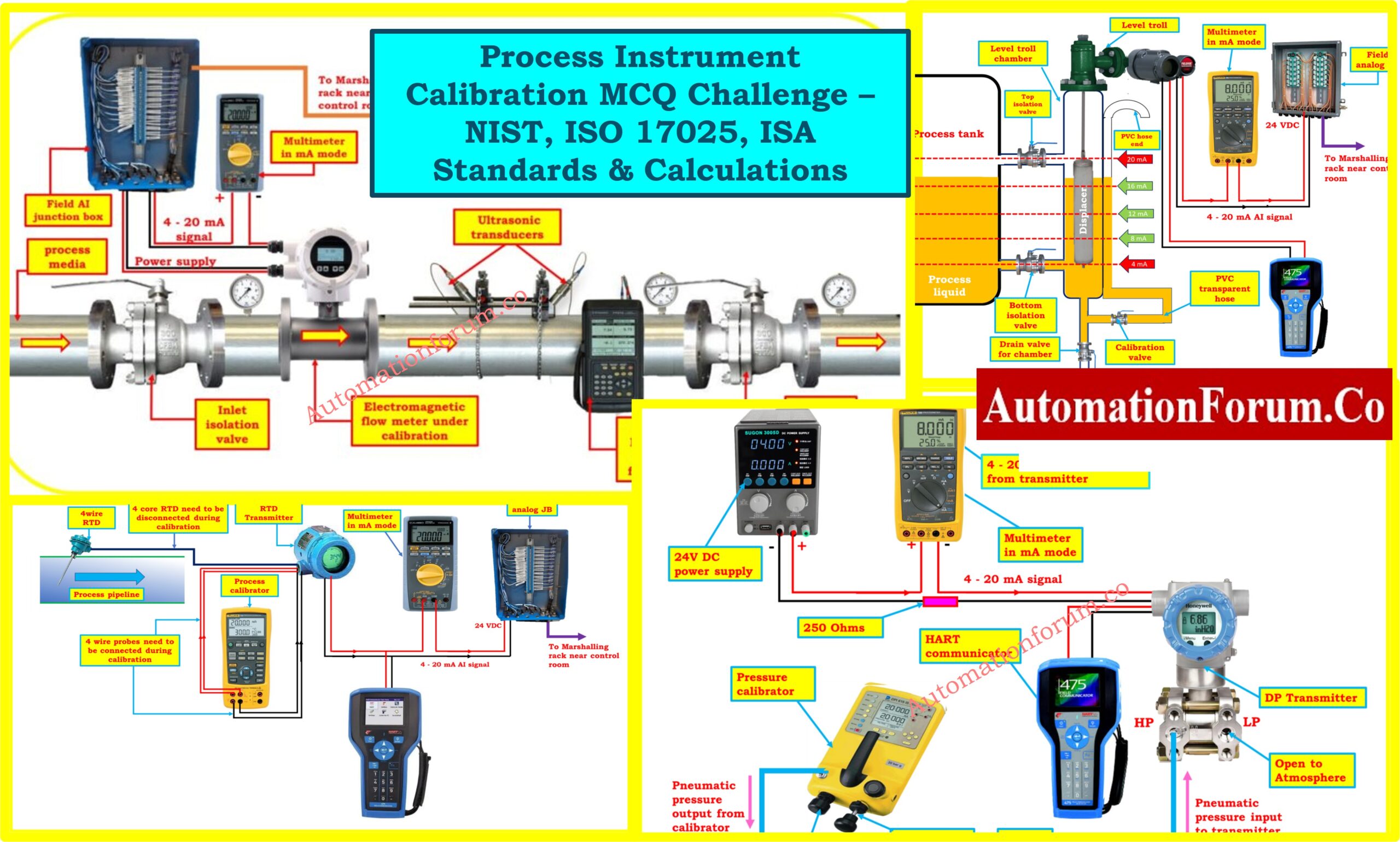

In industrial settings, mastering process instrumentation calibration is very important for making sure that everything is accurate, reliable, and compliant. This exam tests how well you know how to calibrate pressure, flow, level, and temperature. You’ll work on challenges from the real world, as well as formulas, methodologies, and industry standards including ISO 17025, ISA, and NIST traceability. These 25 advanced multiple-choice questions cover topics including calibrating methods, calculating errors, verifying loops, setting tolerance limits, and following standard procedures. This quiz is great for instrumentation engineers, maintenance workers, and QA/QC specialists. It helps find areas where technical skills are strong and weak. This quiz will help you learn more about calibration and give you more confidence in using it in the real world, whether you’re getting ready for audits, certifications, or practical fieldwork.

In industrial settings, it is very important to know how to calibrate process instrumentation to make sure it is accurate, reliable, and meets all standards. This exam tests how well you know how to calibrate pressure, flow, level, and temperature. You will work on real-life situations, calculations, methodologies, and industry standards like ISO 17025 and ISA. Get ready to think critically and test your understanding of modern instruments used in process facilities.
