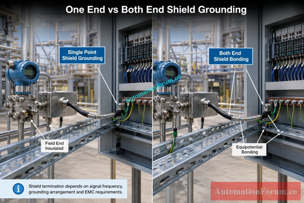

Should Cable Shields Be Grounded at One End or Both Ends?
The answer depends on the application.
When Should a Cable Shield Be Grounded at One End?
Single point shield grounding is commonly used for some low frequency analog instrumentation circuits. Connecting the shield at one designated location reduces the possibility of circulating shield current caused by a ground potential difference between two locations. The unused shield end is normally insulated so it cannot accidentally contact another grounding point.
Avoid Hazardous Area Gland Mistakes That Create Serious Risks: Cable Gland Selection for Hazardous Area Installations – Complete  Guide
When Should a Cable Shield Be Grounded at Both Ends?
Both end shield bonding can provide better performance against high frequency interference because it can provide a low impedance path for unwanted high frequency current. It is commonly used for certain communication and EMC applications when the grounding and bonding system is designed to support it.
Why Is Both End Shield Bonding Used for High Frequency EMC?
The important point is that both end bonding should not be applied blindly. If two grounding locations have a significant potential difference, shield current can flow through the shield.
Therefore, the decision should be based on the complete system design rather than the simple rule that shields must always be grounded at one end or always at both ends.

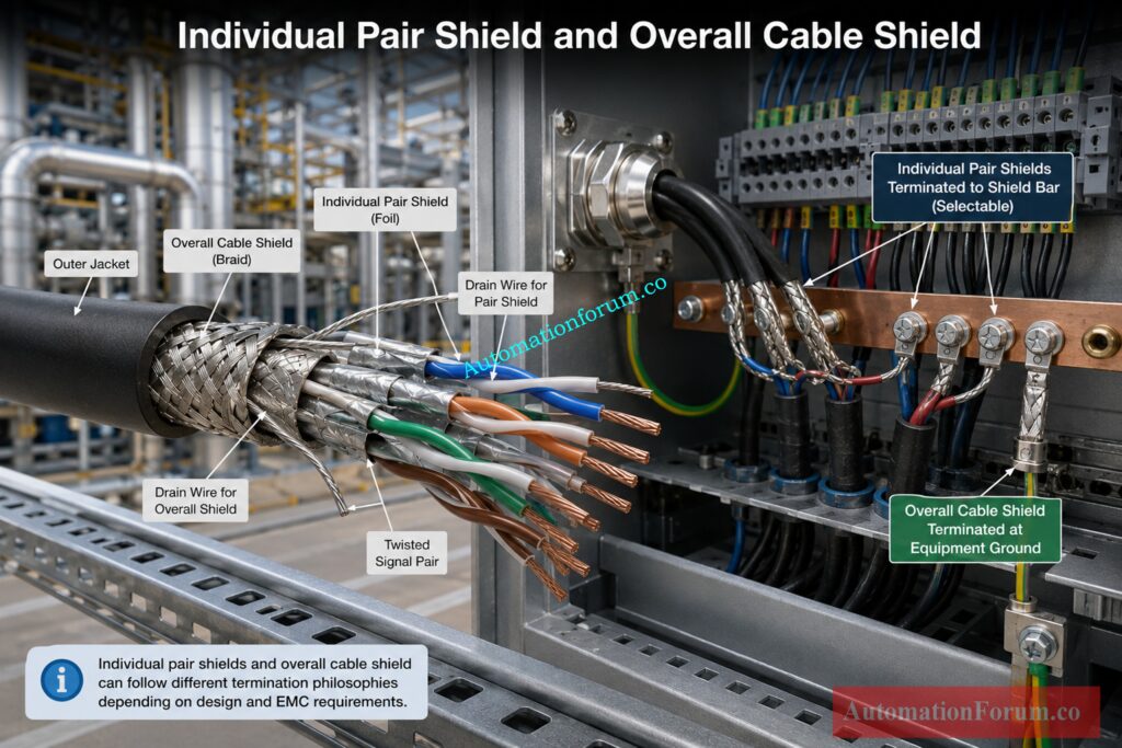

Individual Pair Shielding and Overall Cable Shielding
A multicore instrumentation cable may contain several twisted pairs, with each pair having its own shield. The cable may also have an overall shield around all the pairs. Both shield you from electrical interference. But they aren’t necessarily one and the same.
One signal pair within the cable is individually shielded. This helps safeguard that particular transmission from electrical noise and reduces interference between surrounding signal circuits.
This is especially handy if you have to run numerous sensitive analog signals through the same multicore cable. The individual shield prevents undesired electrical noise in one circuit from impacting another circuit.
The entire set of conductors or separately shielded pairs is enclosed by an overall cable shield. It provides an additional layer of protection from electromagnetic interference from outside the cable.
For example, if the instrumentation cable is located near power cables, motors or variable frequency drives, the overall shield can provide additional protection if appropriately terminated and bonded.
Troubleshoot 4 to 20 mA Loops Faster With Confidence: How to do troubleshooting of a 4-20mA loop?
Yes. The individual pair shields and the overall cable shield do not always have to be terminated in the same way.
In some instrumentation installations, the individual pair shields may be connected at one designated point, while the overall shield may have a different bonding arrangement. This depends on the cable design, grounding philosophy and EMC requirements of the installation.
Do not assume that every shield inside a multicore cable should be connected to the same grounding point. First check the cable manufacturer’s instructions, project grounding philosophy, wiring drawings and equipment requirements.
This small detail can make a significant difference when troubleshooting noisy analog signals or communication problems in the field.

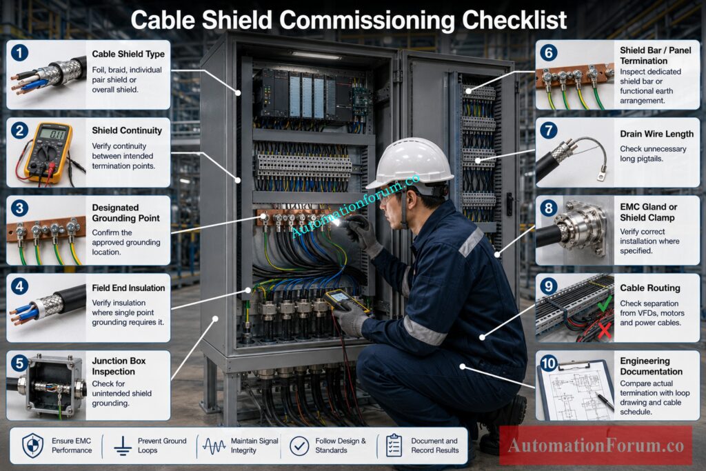

When a shielded instrumentation cable passes through a junction box, shield continuity is normally maintained when the design requires a continuous shield path.
The shield should not automatically be connected to the local junction box earth.
For a single point grounding arrangement, the shield may pass through the junction box using suitable shield continuity terminals while remaining isolated from the junction box earth.
This prevents the junction box from becoming an unintended grounding point.
Good documentation is important. The cable schedule, termination drawing and junction box wiring drawing should clearly identify how each shield is handled.

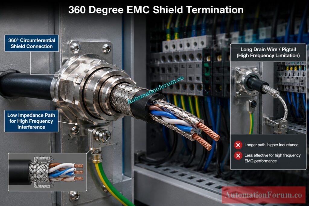

Inside control panels, marshalling cabinets, PLC cabinets, DCS cabinets and SIS cabinets, shields may be connected to a dedicated shield bar or specified functional earth arrangement.
For low frequency applications, a short drain wire may be suitable when the project design permits it.
For high frequency EMC applications, a 360 degree shield termination or suitable shield clamp can provide a much lower impedance connection than a long drain wire.
A long pigtail can behave inductively at high frequencies. This means a connection that appears electrically adequate at low frequency may become much less effective when the interference frequency increases.
The shield should also be stripped back only as much as necessary. Maintaining the shield as close as practical to the equipment entry helps preserve shielding effectiveness.

360 Degree EMC Shield Termination
A suitable EMC cable gland can bond the shield around the cable circumference. This provides a low impedance path and is particularly useful for high frequency interference control.
In communication and electronic equipment, the shield can be connected to a conductive connector backshell. This maintains shielding close to the equipment entry.

This method connects the shield to ground at one designated location. It is commonly considered for suitable low frequency analog applications where ground potential differences are a concern.
Both end bonding can provide strong high frequency EMC performance when the grounding system provides suitable equipotential bonding.

  5. Using long pigtails where high frequency EMC performance is required.

  5. Check the cable construction.
  6. Determine whether the cable has individual pair shields, an overall shield or both.

What Should You Check During Cable Shield Commissioning?
A practical shield termination inspection should include the following checks.
  1. Confirm the cable shield type.
  2. Confirm whether the cable has individual pair shields, an overall shield or both.
  3. Continuity of shield from intended points – Check
  4. Verify the assigned ground position.
  5. Ensure that the field end is insulated if necessary.
  6. Verify that there is no incidental shield contact inside junction boxes.
  7. Inspect control panel shield bar or termination fixture.
  8. Check length of drain wire.
  9. Check EMC gland or shield clamp installation if applicable
  10. Check cable routing around VFDs, motors and power cables.
  11. Verify the actual termination against the loop drawing and cable schedule.
  12. Review manufacturer requirements before making any modification.

For many suitable analog circuits, this is one designated grounding point, often at the receiving equipment end.
There is no universal rule because the correct method depends on signal frequency, grounding arrangement and EMC requirements.
Single point grounding may suit some analog circuits, while both end bonding can improve high frequency EMC performance.
Single point grounding can reduce circulating shield currents caused by ground potential differences between two grounding locations.
This approach is commonly considered for suitable low frequency analog instrumentation circuits.
