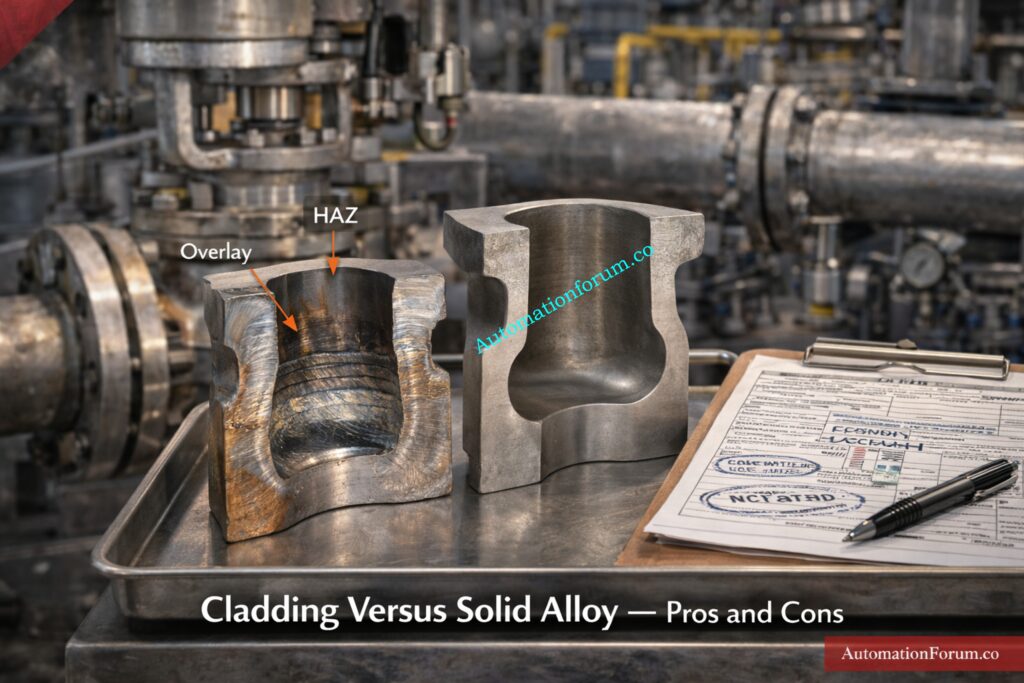

Cladding Vs Solid Alloy Bodies Selection Guidelines
- Cladding (weld overlay) can provide corrosion resistance inside a lower-cost base metal body when mechanical loads are moderate.
- Limitations: cladding delamination, porosity, HAZ susceptibility, and potential inability to meet sour-service SSC requirements if HAZ affects base metal. For severe sour or high-mechanical loads prefer solid alloy bodies.

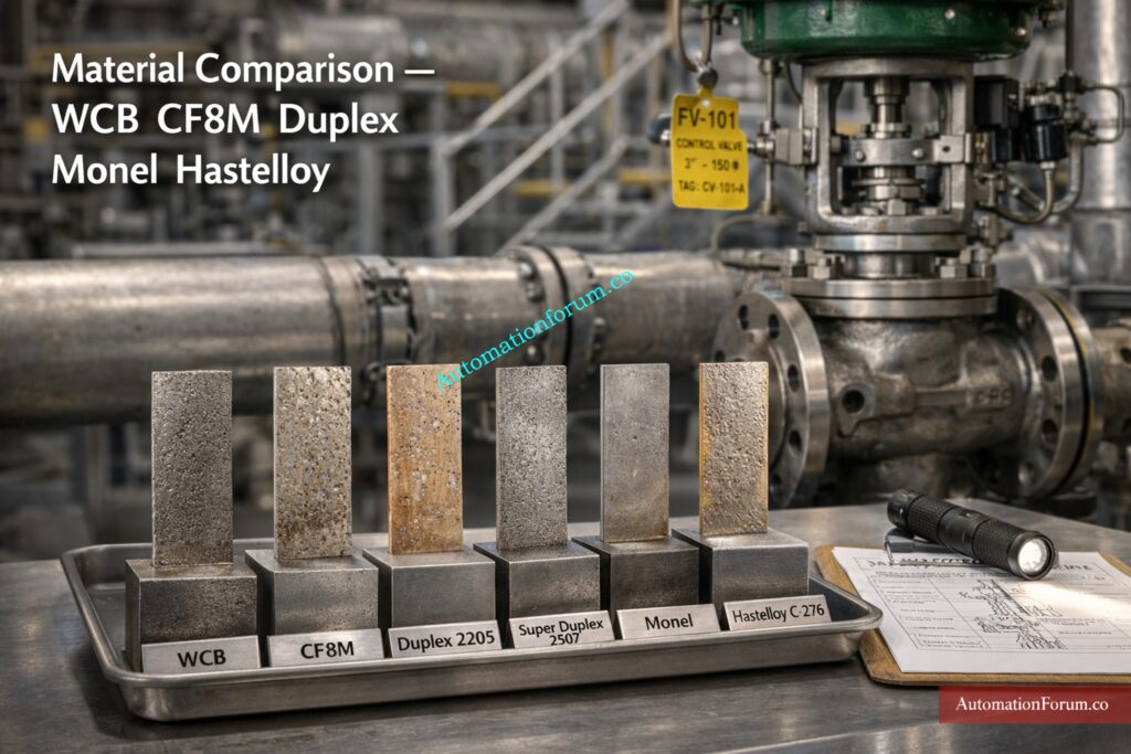

Detailed Material Comparison For Control Valve Bodies
| Material | Typical application | Temperature range | Corrosion resistance level | Cost level | Limitations | EPC design / procurement notes |
| Carbon Steel (WCB) | General service, non-corrosive process lines, utility isolation valves | Cryogenic (with appropriate grade & testing) up to ~425°C (grade dependent) | Low – requires corrosion allowance or protective coating in corrosive services | Low | Poor resistance to chlorides, seawater and sour environments; not suitable for H2S unless fully qualified | Use where economy is priority and process chemistry is benign. Specify MTC, PMI for forgings, and consider internal cladding if moderate corrosion expected. |
| Low Alloy Steel (WC6 / WC9) | High-temperature steam applications, hydrocarbon services at elevated temperature | Up to ~540°C (depending on grade and thickness) | Moderate better high-temperature strength than plain CS but limited chemical resistance | Moderate | Limited chloride and H2S resistance; susceptible to scaling/oxidation at high T | Select for elevated-temperature service where creep strength is needed. Require PWHT and strict heat-treatment records (MTC + PWHT report). |
| Stainless Steel 304 / 316 / 316L | Clean water systems, mild chemicals, general corrosion-resistant applications | Cryogenic to ~400°C (316 often preferred at higher T and chloride tolerance) | Moderate – 316/316L > 304 for chlorides; susceptible to localized attack in aggressive chloride environments | Moderate | Vulnerable to pitting/crevice corrosion in warm chloride environments; SSC risk in sour service | Use when moderate corrosion resistance and weldability required. For chloride/seawater service, evaluate duplex or higher alloys. Specify hardness limits and SSC qualification if H2S present. |
| Duplex Stainless Steel (2205) | Seawater systems, chloride-bearing streams, many oil & gas wetted services | Approx. -50°C to ~300°C (good low T toughness and higher strength) | High – excellent pitting and crevice resistance vs 304/316 | High | Requires controlled welding practices and experienced fabrication; limited availability for some sizes | Good balance of strength and corrosion resistance for offshore and chloride environments. Specify PWHT avoidance, qualified WPS, PMI and heat traceability. |
| Super Duplex (2507) | Aggressive seawater, high chloride CO₂/Cl⁻ environments, high integrity oil & gas applications | Similar to duplex but often with slightly narrower service limits due to fabrication constraints | Very high – superior pitting/crevice and chloride resistance | Very high | More difficult to fabricate/weld; longer lead times; requires experienced suppliers | Use where highest chloride/pitting resistance is needed. Ensure supplier capability for forging/casting and fully documented NDE and MTC. |
| Alloy 20 | Service with acid chlorides and certain sulfuric acid applications; specialty chemical lines | Application dependent (moderate to elevated temperatures per alloy datasheet) | High for specific acidic environments (selected chemistries) | High | Not a universal solution – best for particular acidic chemistries | Specify based on detailed process chemistry. Require vendor corrosion data and MTC confirming composition. |
| Monel (Alloy 400) | Seawater systems, some acidic environments and mixed media where cu-nickel is desirable | Wide range; consult alloy data for exact limits | High resistance to seawater and many acids | Very high | Costly; magnetic and fabrication considerations | Consider where seawater corrosion plus occasional acid exposure exist. Specify PMI and fabrication experience. |
| Hastelloy (C-276 / C-22) | Highly corrosive chemistries, oxidizing and reducing acid mixtures, aggressive process chemistries | Broad service ranges per alloy – selected for severe chemical resistance | Excellent – one of the best for mixed acid/oxidizing environments | Extremely high | Very expensive; long lead times; special fabrication/welding practices | Use only when process chemistry justifies cost. Require supplier corrosion test data, full MTC, and tight welding controls. |

What is WCB Material For Valves?
WCB is cast carbon steel that meets the standards of ASTM A216 Grade WCB. It is often used for valve bodies in normal duty applications.
It has good mechanical strength for moderate pressure and temperature, but it doesn’t resist corrosion very well.
