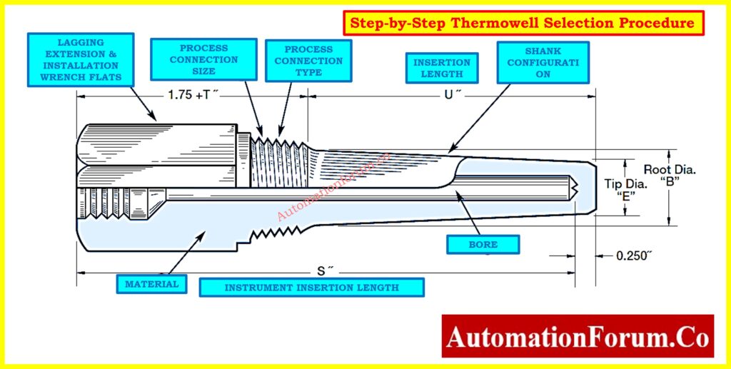

Basic Components of a Thermowell
Every thermowell has important dimensions and features that affect how well it works (see Figure – Thermowell Parts).
- Bore Diameter (B): The inside diameter that was bored to fit the sensor probe. For ¼″ RTDs, the most common size is 0.260″, while for ⅜″ thermometer bulbs, it is 0.385″.
- Bore Depth (S): The total depth that the probe can go into.
- Insertion Length (U): This is also known as immersion length. It is the distance from the process connection to the end of the thermowell.
- Lagging Extension (T): Extra length above the process connection to make room for insulation or jackets.
- Extension Length (E): A longer length that moves the connecting head away from the heated surface.
- Shank Construction: The shape of the stem that is submerged—straight, stepped, or tapered.
- Base Diameter (Q): The thickest point on the outside of the shank.
- Tip Diameter (V): The diameter of the thermowell tip’s outside edge.
- Tip Thickness (E): The thickness of the closed end that keeps the process and the sensor tip apart.
- Process Connections: The way the thermowell connects to piping or vessels depends on whether it is threaded, flanged, or welded.

Step-by-Step Thermowell Selection Procedure
When choosing a thermowell, measuring performance and mechanical integrity must be taken into account. The methodical process that follows guarantees precise and secure selection.
1. Define Process Connection Size and Type
Finding out how the thermowell will connect to the process machinery is the first step.
- Threaded (NPT): Frequently used in utility services; simple to set up.
- Flanged: Complies with the face type (raised, flat, or ring-joint) and piping flange rating (150#, 300#, etc.).
- Weld-In: Selected for long-term installations when preventing leaks is essential.
- Socket-Weld: Strong and small, socket-weld pipes are ideal for high-pressure applications.
- Sanitary Clamp: Food, beverage, and pharmaceutical systems all need sanitary clamps.
Get RTD Commissioning Checklist: RTD Commissioning Checklist
2. Select Insertion Length (U)
The U-dimension, also known as the insertion length, indicates how far the thermowell penetrates the process. This element is essential for mechanical stability as well as measuring accuracy.
- In Pipelines: To obtain a representative fluid temperature in pipelines, the thermowell tip should preferably touch the pipe’s centerline. The insertion depth should, at the very least, be at least one-third of the internal diameter of the pipe.
- In Tanks and Vessels: In tanks and vessels, 6 to 12 inches of penetration depth is usually adequate. Baffles, agitators, and other interior features should not be interfered with during placement.
- Standard Lengths: Depending on the needs of the process, thermowells can be inserted into the following standard lengths: 2.5, 4.5, 7.5, 10.5, 13.5, 16.5, and longer.
Design Note: AWhile an excessively long thermowell may experience vibration, resonance, and even mechanical failure, a thermowell that is too short may result in inadequate heat transfer and erroneous temperature readings. Always check the insertion depth against the relevant standards and process circumstances.
Discover Types of Thermowells: Thermowells & types of thermowells
3. Determine Lagging Extension (T)
If there are jackets or insulation, lagging extension is necessary.
- Standard values: 2″ or 3″.
- Customized to match insulation thickness.
- For simpler access, make sure the sensor head is outside the insulation.
4. Decide on Extension Length (E)
The sensor connection head is moved away from hot process surfaces by the extension length.
- Standard values: 3″ or 6″.
- Beneficial for high-temperature applications like as furnaces or steam pipes.
- Gives maintenance workers a safer working distance.
5. Match Sensor Length (X)
The temperature probe’s complete engagement with the thermowell is guaranteed by the sensor length, also known as the X-dimension. The sensor tip needs to be firmly in touch with the thermowell bore’s bottom in order to measure accurately. Slow response times and measurement mistakes might result from heat resistance introduced by any space between the sensor and the bore tip.
Simple calculations that change based on the type of process connection are used to determine the necessary sensor length:
- Threaded / Socket-Weld Thermowells:
X=U+T+E+1.5″ - Flanged Thermowells:
X=U+T+E+2.0″
Example:
If the insertion length (U) is 7.5″, lagging extension (T) is 3″, and extension length (E) is 0, for a threaded thermowell:
X=7.5+3+0+1.5=12″
Thus, a 12″ sensor probe is required to ensure proper contact with the bore tip.
Read Temperature Transmitter Datasheet Guide: How to Read a Datasheet of a Temperature Transmitter ?
6. Choose Bore Diameter
The bore diameter is the size of the hole within the thermowell where the sensor probe goes. Getting the right size for the bore is important for both accuracy and ease of installation.
- 0.260″ bore: The 0.260″ bore is made for ¼” RTD or thermocouple probes. This is a typical choice for precise instrumentation.
- 0.385″ bore: Works with ⅜″ thermometer stems or bulbs, which are usually used in bimetallic thermometers.
Engineering Note: To reduce air gaps, which function as insulators and slow down heat response, the space between the sensor and the bore should be as narrow as feasible. But there needs to be enough space for the probe to be put in and taken out easily.
Learn How to Specify a Thermowell: How to specify a thermowell?
7. Select Shank Style
The shape of the stem has a direct effect on strength and response time.
- Straight: Same diameter all the way around; basic design for low-pressure use.
- Stepped: The smaller tip makes the response time better, but it also makes the mechanical strength weaker.
- Tapered: The tip gets smaller smoothly, which gives the optimum mix of strength and responsiveness.
- Built-up: Used for wells that are longer than normal on big ships.
Recommendation: Use tapered shanks for services with a lot of speed or vibration.
8. Select Material of Construction
The choice of material relies on how much pressure, temperature, and corrosion it can handle.
- Carbon Steel: For general use, it doesn’t rust.
- SS304, SS316, and SS316L are good for processing chemicals and food and are very compatible.
- Monel and Hastelloy: These metals don’t rust easily in seawater or acidic environments.
- Titanium and tantalum are very resistant to chemicals.
- PTFE/Teflon: Not very strong but can handle corrosive tasks.
Before you finish, always check the compatibility charts and piping specs.
Before making a final decision, check the manufacturer’s corrosion compatibility charts.
Refer the below link tot Explore Why Install Thermowells at a 45° Angle? Engineering Logic Explained
