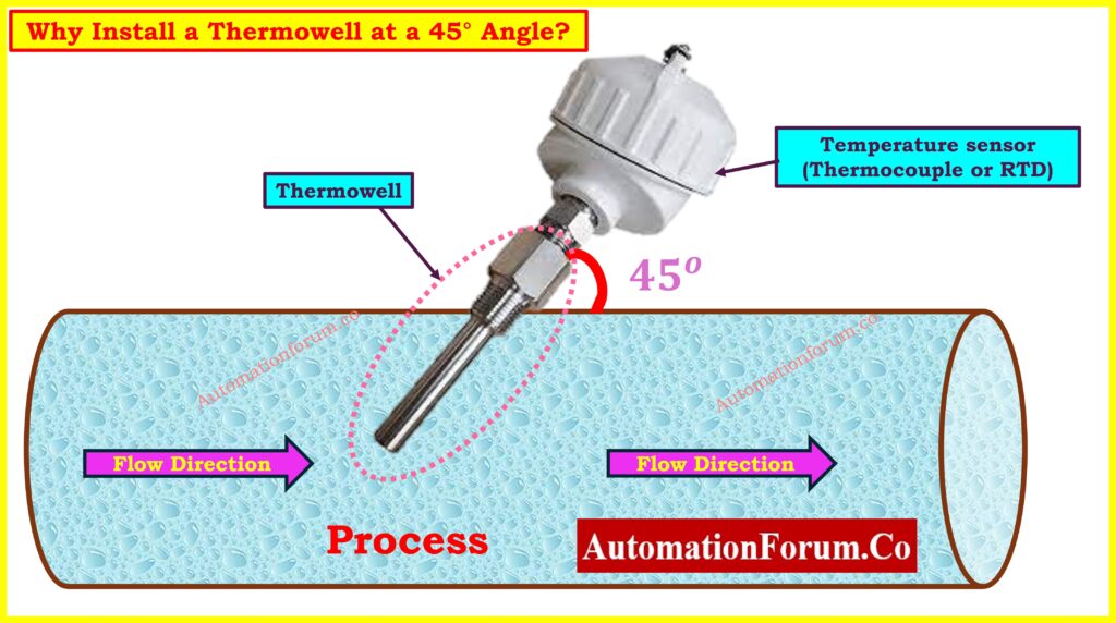

Why Install a Thermowell at a 45° Angle?
Installing thermowells at a 45° angle to the flow of fluid has a number of important engineering benefits:
Reduced Flow-Induced Vibration
One of the most important reasons to put a thermowell at an angle is to cut down on flow-induced vibration. This happens when fluid flows around a bluff body (in this case, the thermowell) and creates alternating vortices. Resonance happens when the shedding frequency (also called the Strouhal frequency) is the same as the thermowell’s natural frequency. This can cause vibration-induced fatigue and possible mechanical failure.
The ASME PTC 19.3 TW-2010 standard, which sets rules for designing thermowells, stresses the need of avoiding resonance by looking at the thermowell’s in-line and transverse frequencies. Installing the thermowell at a 45° angle makes the cross-flow velocity much lower, which makes the vortex shedding less intense. This lowers the amplitude of the vibrations caused by the thermowell and makes it last longer.

Improved Temperature Response and Accuracy
When the sensor is installed at an angle, the tip is better immersed in the fluid stream, which:
- Improves heat transfer to the sensor
- Reduces thermal lag
- Delivers faster and more accurate temperature readings
Gives temperature readings that are faster and more accurate
This is very critical in processes that are changing or moving quickly, when response time is quite vital. The sensor picks up accurate temperatures without delay or insulation from stagnant zones because it is deeper in the active flow channel.

Lower Pressure Drop and Better Flow Dynamics
Installing thermowells at an angle makes it easier for flow to happen than installing them straight up and down. This leads to:
- Reduced pressure drop
- Less turbulence and energy loss
- Improved flow profile integrity
In procedures where the flow is sensitive, such custody transfer, it is very important to keep the flow’s integrity. Changes in fluid velocity or turbulence can cause measurement errors or system inefficiencies.
Easier Maintenance and Accessibility
A 45° angle typically makes it easier to get to things physically, especially in:
- Overhead pipe runs
- Insulated or jacketed piping
- Tight or congested areas
This simplifies removal, inspection, and calibration of the temperature sensor, making it easier and safer for technicians to work on the system especially under time-critical maintenance schedules.
