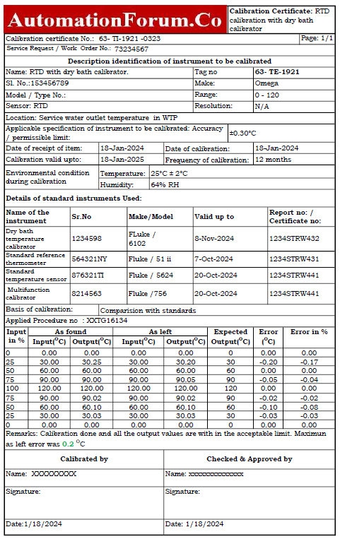

Step 6: Recording Calibration and Verifying Linearity
- Include inputs in both the upscale and downscale temperature directions from the dry block calibrators, corresponding to the output values indicated on the RTD in the multifunction calibrator.
- Recalibration is necessary if the RTD output value falls outside the tolerance specified by the manufacturer. In case of further deviation from the permitted range, replace the RTD with a new one.
- If every output value (+/- %) of the RTD is within accepted limits, no additional calibration is required.
- Fill in the “as found/as left” column of the blank calibration report with the RTD output values.

Step 8: Calibration Report Preparation
The calibration of the RTD is demonstrated in the sample report using a thermometer and a dry bath temperature calibrator, with a standard thermocouple serving as the reference.
For an Excel template used in creating the RTD calibration report, you can access it through the link provided.

What should an RTD calibration report contain?
Include the instrument tag, sensor type, range, reference equipment, test points, as found and as left readings, calculated error, acceptance limits, calibration result, and corrective action.
