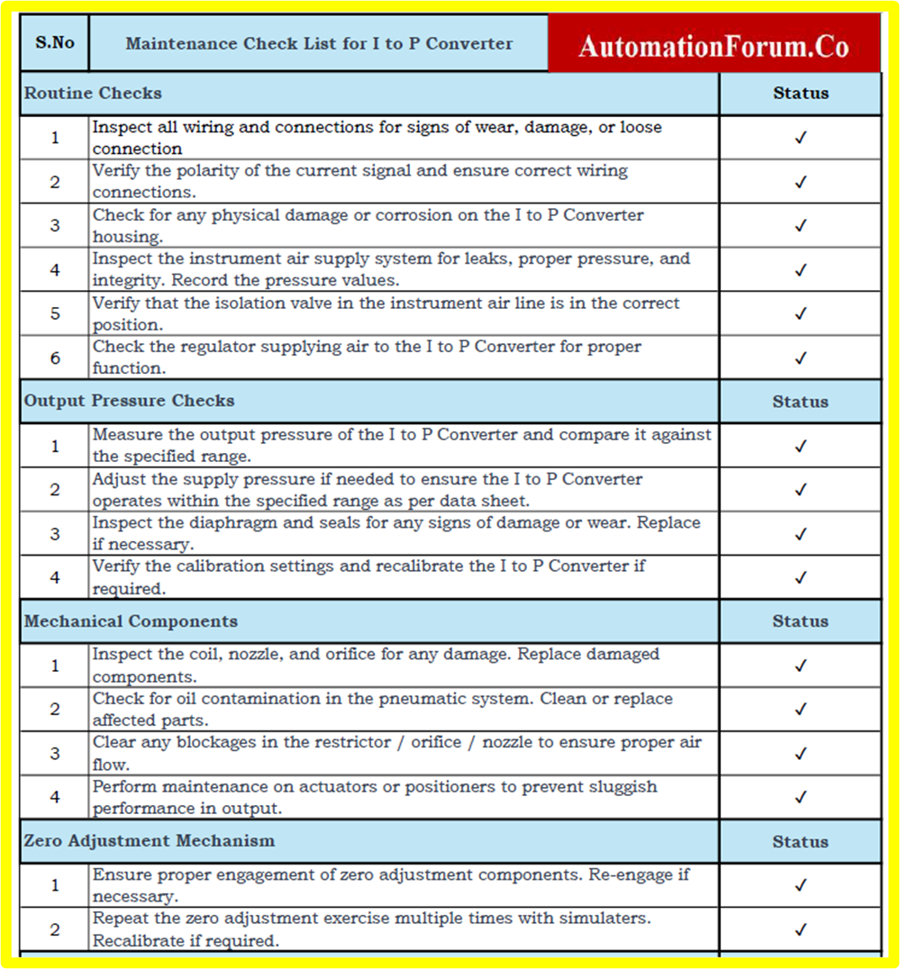

Checklist For Troubleshooting Maintenance of I to P Converter
Refer below link for the downloadable checklist for troubleshooting maintenance of I to P Converter.
Click here for Procedure for Calibration of I to P ConverterÂ
