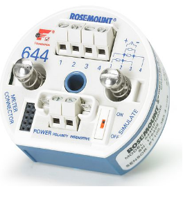

The main difference between a Fieldbus transmitter and conventional transmitters is that the output signal is a fully digital Fieldbus signal. Change the output signal does not change the need for periodic calibration
Procedure for calibrating Fieldbus transmitters
Beamex MC5 Fieldbus Calibrator,is a combination of a multifunction process calibrator and a Field-bus configurator, which can be used with both industrial standards Foundation Field-bus H1 and Profi-bus PA. It also houses HART
configuration and calibration facility
1. 2 persons needed for calibration
2.Make connections
3.Calibrate and document automatically – Simulate or generate the input and read the digital output of the Field-bus instrument
4.Trim (adjust) if required and perform As Left calibration automatically or manually
5. Upload calibration results to calibration software and print the calibration certificate
