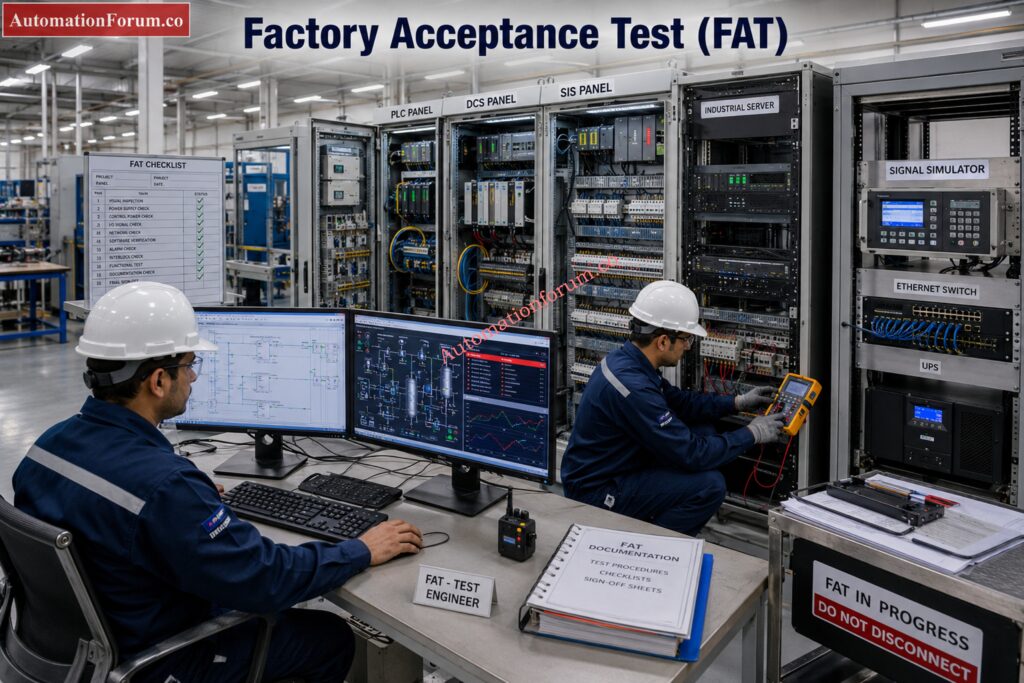

What is Factory Acceptance Test (FAT)?
A Factory Acceptance Test (FAT) is the first formal verification of an automation system before it is delivered to the project site. This is done at the equipment manufacturer or system integrator’s location once the panel has been fabricated, the software configured, the hardware assembled and internal quality checks performed.
Never Skip These Critical Control Valve Inspection Activities: Inspection and Test Plan (ITP) for Control Valves
The purpose of FAT is to demonstrate that the PLC, DCS, SIS or SCADA system supplied has been designed, built, programmed and tested in accordance with the approved Functional Design Specification (FDS), Cause and Effect Matrix, I/O list, control philosophy and contract requirements.
Since the actual process equipment is not available during FAT, engineers use signal simulators, software emulators and test benches to simulate field instruments like pressure transmitters, temperature transmitters, flowmeters, control valves, level switches, motor feedback signals and emergency shutdown inputs.
A comprehensive FAT typically verifies:
  • Control panel construction and wiring quality
  • PLC, DCS, or SIS hardware configuration
  • Power supply and redundancy operation
  • Analog and digital I/O functionality
  • Alarm generation and acknowledgment
  • Interlock logic and permissive sequences
  • Human Machine Interface graphics
  • Historian data collection
  • Industrial communication protocols
  • Controller redundancy and failover performance
  • Software backup and restoration
  • Network communication between controllers and operator stations
For example, an engineer doing a PLC FAT on a boiler control system will simulate a low drum water level signal to verify that the PLC starts the burner trip sequence, activates alarms at the operator workstation, logs the event in the historian, and implements the shutdown logic as per the approved Cause and Effect Matrix.

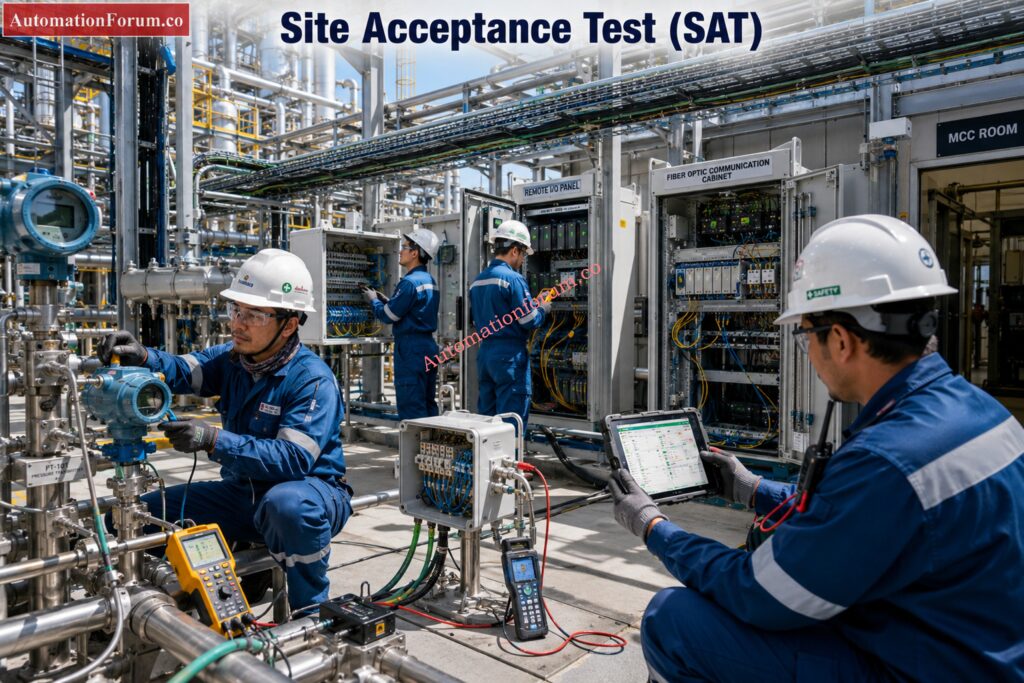

What is Site Acceptance Test (SAT)?
The Site Acceptance Test (SAT) is performed after the automation system has been delivered to the plant site, installed, wired, powered and prepared for commissioning. FAT ensures the quality of the product at the manufacturer; SAT checks that the equipment is still functioning appropriately after it has been transported and installed.
The main goal of SAT is to verify that the installed automation system performs as specified in the real plant environment. FAT is based on simulated signals, SAT tests the system with real field devices, real communication networks, genuine installed power systems and real plant infrastructure in operation.
In SAT, commissioning engineers check that the installation works have been performed following authorized engineering designs and construction standards.
Avoid Costly MOV Testing Errors Before Site Installation: Motor-Operated Valve (MOV) Factory Acceptance Test (FAT) Procedure
Typical SAT activities include:
  • Inspection of control panels for transportation damage
  • Verification of cable termination and labeling
  • Earthing and grounding inspection
  • UPS and power supply verification
  • PLC and DCS controller health checks
  • Remote I/O communication testing
  • Instrument loop verification
  • Field transmitter calibration confirmation
  • Control valve functional testing
  • Motor starter feedback verification
  • Industrial Ethernet and fiber optic communication checks
  • Alarm and event verification
  • Operator graphics validation
  • Network redundancy testing
For example, a pressure transmitter that passed FAT may fail in SAT because of faulty cable polarity, broken field wiring, loose terminal connections or grounding difficulties caused after installation. Before the plant goes in commissioning, various difficulties relating to installation are identified by SAT.
SAT also monitors the connectivity between field devices and higher automation systems. Protocols such as Modbus TCP, PROFINET, EtherNet/IP, FOUNDATION Fieldbus, HART and OPC UA test the integrity of data exchange across the entire plant.
All remaining observations at the conclusion of SAT are documented as punch list items. The project should not be moved to the integrated system testing phase until these issues have been resolved.

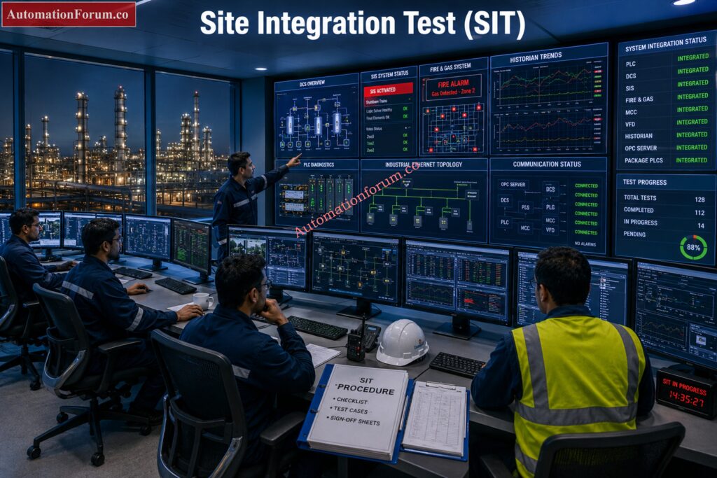

What is Site Integration Test (SIT)?
A Site Integration Test (SIT) is the final acceptance stage before cold commissioning and plant startup. SIT differs from FAT and SAT in that it tests all automation subsystems working together as one comprehensive process control solution, instead of individual equipment and installed systems.
Modern industrial facilities rarely rely on a single automation platform. Instead, they integrate multiple PLCs, DCS controllers, Safety Instrumented Systems, Fire and Gas Systems, package equipment, Motor Control Centers, Variable Frequency Drives, analyzers, electrical protection systems, historians, asset management systems, and operator workstations supplied by different vendors.
Each subsystem may pass FAT and SAT individually, but when the systems begin to exchange real process data, integration problems often arise.
Instead of individual input and output signals, engineers assess full plant running scenarios in SIT.
Typical SIT activities include:
  • PLC to PLC communication testing
  • PLC to DCS interface verification
  • DCS to SIS shutdown communication
  • Fire and Gas System integration
  • Emergency Shutdown sequence testing
  • Motor Control Center communication
  • Variable Frequency Drive control verification
  • Package equipment interface testing
  • Historian data collection validation
  • OPC server communication
  • Alarm management verification
  • Automatic startup sequence testing
  • Automatic shutdown sequence testing
  • Cause and Effect Matrix verification
  • Industrial network redundancy testing
  • Controller recovery after communication failures
For example a gas detector detects a hydrocarbon leak, then SIT checks that the Fire and Gas System sends the alarm to the DCS, the Safety Instrumented System initiates the Emergency Shutdown sequence, the isolation valves close automatically, the ventilation systems start, warning beacons activate and all the events are correctly logged in the historian. This confirms that every subsystem responds together exactly as defined in the project control philosophy.
If successful, a SIT demonstrates that the complete automation architecture is ready for safe plant start-up.

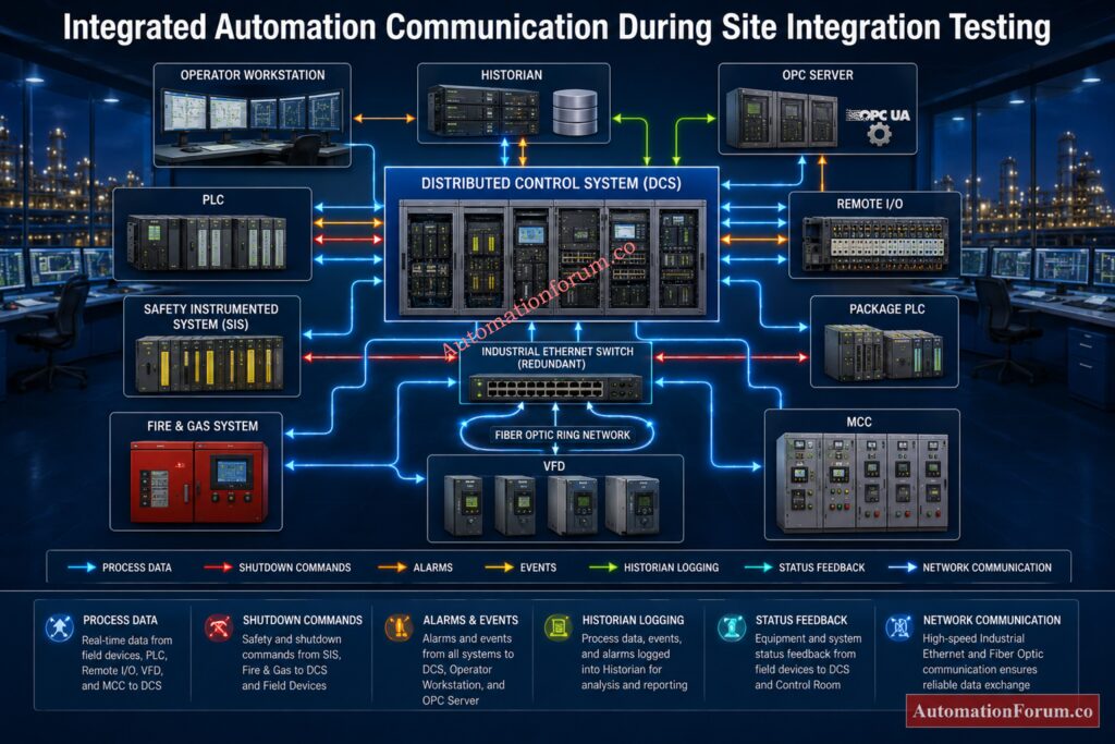

Detailed Site Integration Test (SIT) Procedure
The Site Integration Test is the final automation verification before cold commissioning and plant startup. Its purpose is to confirm that every automation subsystem communicates and operates together according to the approved control philosophy.
Unlike FAT and SAT, which operate at the device level, SIT operates at the level of whole operational scenarios. Engineers review the connection between PLCs, DCS controllers, Safety Instrumented Systems, Fire and Gas Systems, Motor Control Centers, Variable Frequency Drives, package equipment, electrical protection systems, historians and operator interfaces.
Common SIT activities include PLC to PLC communication validation, PLC to DCS interfaces, DCS to SIS Shutdown commands, Fire and Gas integration, Compressor package interfaces, Boiler package controls, Tank gauging systems, Utility packages and Electrical control systems. Alarm management, event logging, historical recording, OPC communication, time synchronization and industrial network redundancy are also validated.
Avoid Cable Tray Installation Mistakes That Cost Thousands: Instrumentation Cable Tray Installation Checklist and Inspection Procedure
Integrated startup and shutdown simulations are performed using realistic operating conditions. For example, engineers may simulate a high pressure event on a reactor.
Only after all integrated scenarios have been successfully completed and punch list items closed is the automation system considered ready for commissioning.

One LNG export terminal had a Distributed Control System from one vendor, compressor control PLCs from another vendor, a separate Safety Instrumented System, Fire and Gas System, Motor Control Centers, and various packaging skids. All vendors performed Factory Acceptance Testing satisfactorily prior to shipment and all systems passed Site Acceptance Testing following installation.
However, during the Site Integration Test, engineers found a mismatch in communication between the compressor PLC and the DCS. The compressor controller sent suction pressure in bar gauge and the DCS calculations expected bar absolute. The engineering unit system mismatch was the reason of the wrong anti surge calculations during the integrated startup simulations even if both systems were working as expected during FAT and SAT.
The solution to the problem was upgrading the communication mapping and engineering calculations before introducing natural gas into the operation. Had this problem been found at startup, repeated compressor flights could have delayed the commissioning by several days, adding significantly to project expenses. This example shows why SIT is a required verification phase rather than an optional project activity.

Factory Acceptance Test (FAT) is a validation of the automation system at the vendor site before shipping. Site Acceptance Test (SAT) establishes that the installed system functions correctly at the project site, and Site Integration Test (SIT) shows that all automation subsystems can function together as an integrated plant prior to commencement.
FAT helps find hardware problems, software bugs, configuration errors and documentation difficulties before shipping equipment. Getting these concerns early lowers commissioning delays, eliminates costly site adjustments, and enhances overall project quality.
SAT shall be performed following completion of equipment installation, cable termination, power energization and instrument loop checks. It is generally done prior to cold commissioning and integrated system testing.
The main aim of SIT is to validate the communication and interaction between PLCs, DCS, SIS, Fire and Gas Systems, package equipment, Motor Control Centers and other automation systems to ensure safe and reliable operation of the whole plant.
Typical documents required for FAT are Functional Design Specification (FDS), Control Philosophy, Cause and Effect Matrix, P and ID, I O List, Logic Diagrams, Instrument Datasheets, Panel Drawings and FAT Test Procedures.
The FAT is normally attended by the system vendor, EPC contractor, client representatives, automation engineers, quality inspectors, project engineers and commissioning engineers to ensure that the automation system meets all the technical and contractual criteria.
FAT usually covers testing of PLCs, DCS controllers, SIS hardware, SCADA systems, Human Machine Interfaces, control panels, communication networks, power supply, software logic, alarms, interlocks and operator visuals with simulated field signals.

SAT tests installation of panels, field wiring, power supply, communication networks, instrument loops, transmitter calibration, control valve operation, alarm functions, interlocks and operator displays using genuine field equipment.
It is not suggested to skip FAT, since problems found after the equipment has arrived at the site are much more expensive and time-consuming to fix than those found during factory testing.
Automation engineers frequently test industrial communication protocols such as Modbus RTU, Modbus TCP, PROFINET, EtherNet/IP, FOUNDATION Fieldbus, PROFIBUS, HART, OPC UA, and Industrial Ethernet during acceptance tests.
A FAT punch list is a list of observations, flaws, software changes, hardware issues and documentation revisions found during Factory Acceptance Testing that must be fixed before shipment is approved.
After successful SIT, project continues for cold commissioning, hot commissioning, performance testing, plant restart and eventually formal handover of automation system to plant owner for commercial operation.
