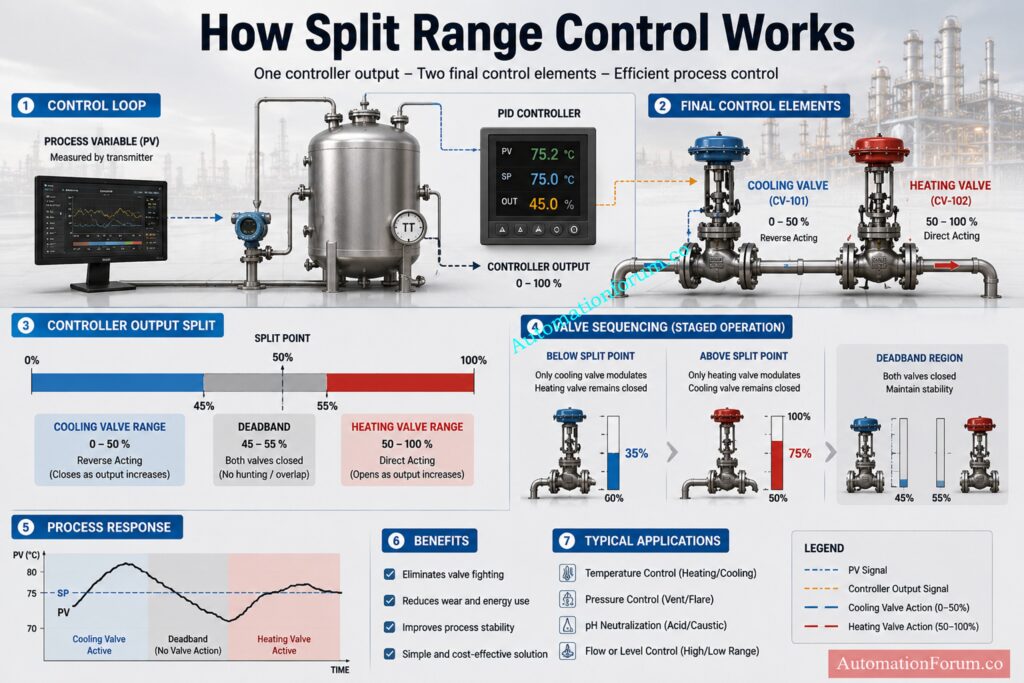

Split range control is a control strategy where a single PID controller output is divided among two or more control valves or final control elements.
Single PID Controller Operating Multiple Control Valves
Instead of one valve operating across the full controller output range from 0 percent to 100 percent, multiple valves operate over assigned sections of that range.
For example:
- Cooling valve operates from 0 percent to 50 percent
- Heating valve operates from 50 percent to 100 percent
When the controller output is low, the cooling valve responds.
When the output increases above the split point, the heating valve begins operating.
This arrangement allows one control loop to manage opposing process requirements such as:
- Heating and cooling
- Acid and caustic dosing
- Inlet and outlet pressure regulation
- Small and large flow valves
- Vent and recycle systems
The concept sounds simple, but successful implementation requires deep understanding of process gain, valve sizing, deadband, and loop dynamics.

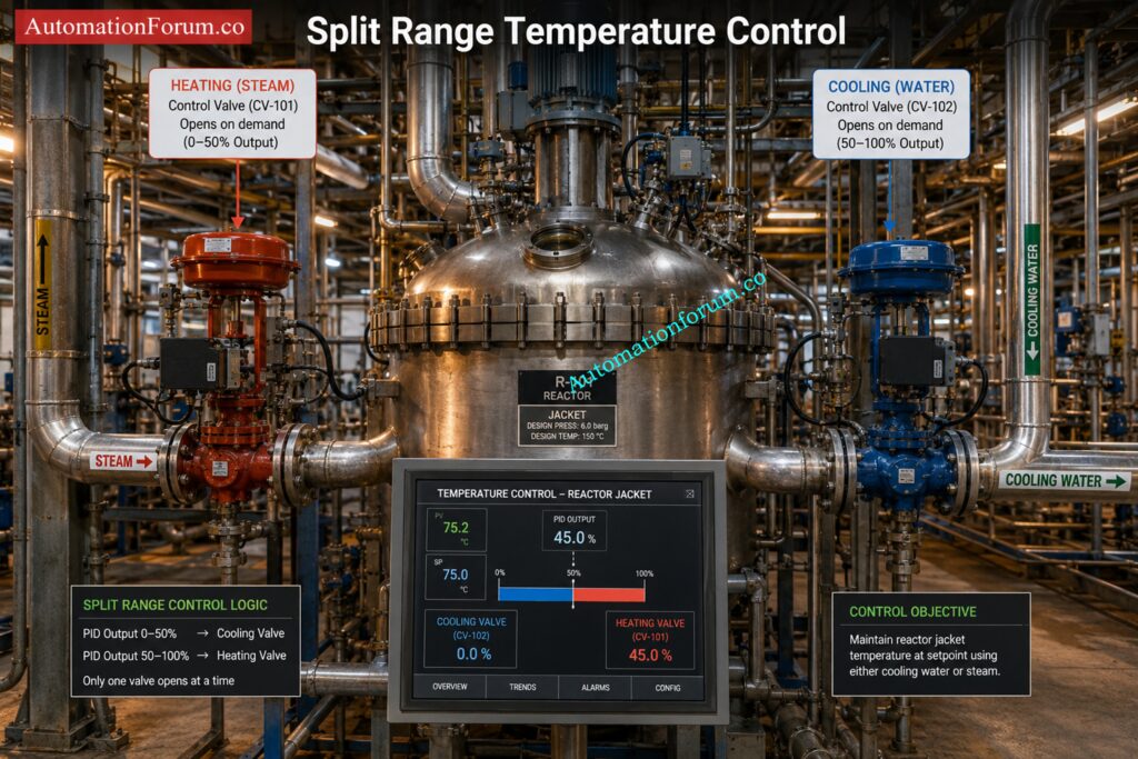

How Split Range Control Improves Energy Efficiency
Temperature control is the classic split range application.
Consider a reactor jacket.
During startup, the process may require steam heating. Later, the same process may require cooling water because the reaction becomes exothermic.
A single valve cannot provide both heating and cooling.
Split range control allows:
- Cooling valve operation in one output range
- Heating valve operation in another range
The controller automatically selects the required utility based on process conditions.

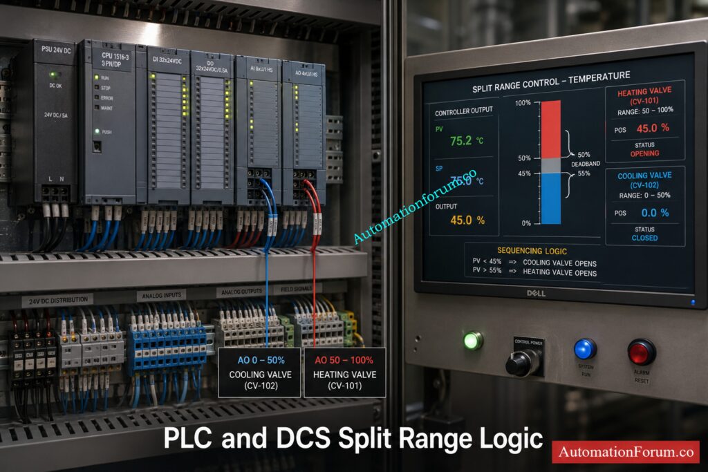

How Split Range Control Works in DCS and PLC Systems
A split range control loop starts with a standard PID controller.
The difference is how the output signal is distributed.
Instead of sending 4 to 20 mA to one valve, the control system divides the signal into multiple operating regions.
Example of Basic Split Range Operation
Cooling Valve
- Operates from 4 to 12 mA
- Fully open at 4 mA
- Fully closed at 12 mA
Heating Valve
- Operates from 12 to 20 mA
- Fully open at 20 mA
At the midpoint, one valve closes while the other starts opening.
Modern DCS systems usually implement split ranging through software function blocks instead of pneumatic bench set adjustments.

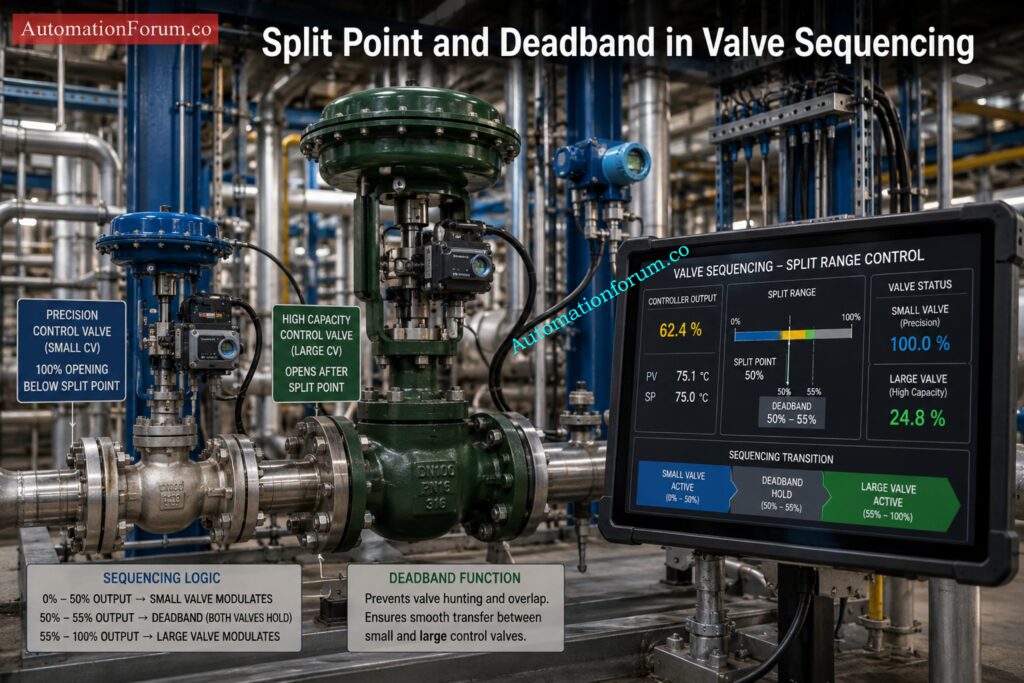

Why Deadband is Important in Split Range Control
Deadband is one of the most misunderstood topics in split range control.
Without deadband, the loop may continuously switch between valves near the split point.
This creates:
- Valve hunting
- Oscillation
- Excessive actuator movement
- Utility waste
- Mechanical wear
For example:
- Cooling valve active from 0 percent to 49 percent
- Deadband from 49 percent to 51 percent
- Heating valve active from 51 percent to 100 percent
This small inactive region prevents constant switching near midpoint operation.
However, excessive deadband can also create poor control response.
This is why deadband tuning requires practical plant experience.

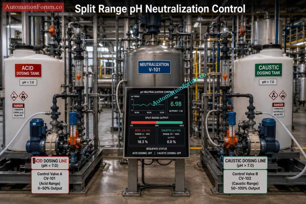

Split Range Control in pH Neutralization Systems
pH control loops often use:
- Acid dosing valve
- Caustic dosing valve
Both utilities cannot operate simultaneously without causing instability.
Split range control sequences acid and caustic addition based on controller output.
This prevents reagent fighting and improves chemical efficiency.

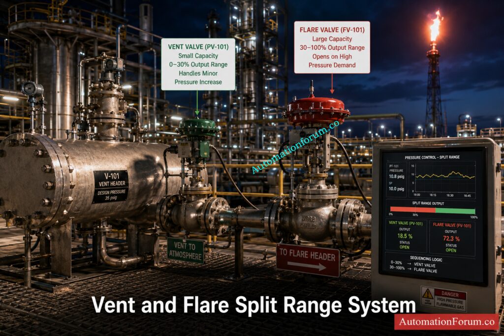

Vent Valve and Flare Valve Split Range Example
In refinery flare systems:
- Small vent valve handles minor pressure variations
- Large flare valve activates during major pressure rise
This arrangement improves safety while reducing unnecessary flaring.
