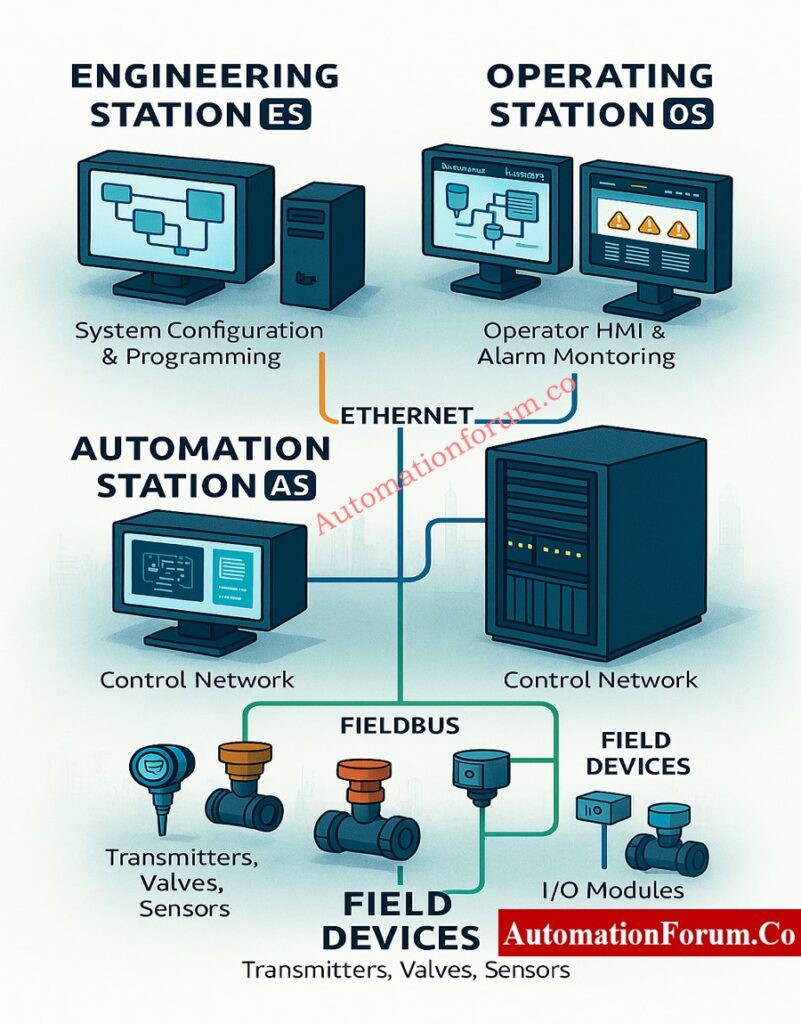

Engineering Station (ES): The Heart of DCS Configuration
The Engineering Station (ES) is where the whole DCS is built on. Engineers use it as their main workstation to set up, program, and keep the control system running. There would be no control strategy, no communication mapping, and no parameter adjustment if there were no ES.

Operating Station (OS): The Operator’s Window to the Process
The Operating Station (OS) is the control room interface that links operators to the process. It gives operators a real-time graphical view of how the plant is running, letting them see data, handle warnings, and operate process equipment.

Automation Station (AS): The Brain of the DCS
The Automation Station (AS), which is also called the Controller or Process Station, is the DCS’s real execution engine. It controls things in real time and talks directly to field equipment like sensors, transmitters, and actuators.

Comparison Between ES, OS, and AS in DCS
Here’s a full comparison to help you understand how these three DCS parts work together:
Summary Table – Roles and Responsibilities
| Feature | Engineering Station (ES) | Operating Station (OS) | Automation Station (AS) |
| Primary Users | Engineers | Operators | Control System |
| Main Function | System configuration, logic programming, diagnostics | Real-time monitoring, alarm handling, control actions | Logic execution, process control, field communication |
| Interface Type | Configuration tools, programming environment | HMI, process graphics, trends | Control algorithms, I/O connections |
| Critical Role | Design and maintenance | Operation and supervision | Execution of control strategies |
| Data Interaction | Defines control logic and parameters | Displays and controls live process data | Acquires and acts on process data |
This structure makes it clear who is responsible for what:
- ES focuses on what should happen (design).
- AS focuses on how it happens (execution).
- OS ensures who monitors and controls it (operation).
