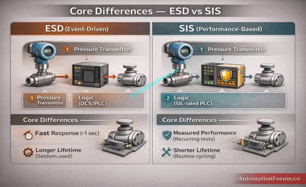

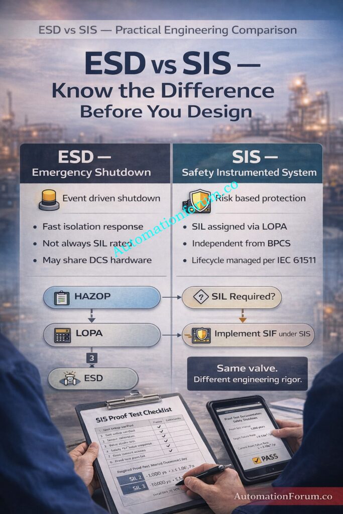

Core Difference Between ESD and SIS
The confusion arises because both systems may close valves or trip equipment.
The difference lies in:
| Aspect | ESD | SIS |
| Primary Objective | Emergency response | Quantified risk reduction |
| SIL Assignment | Not mandatory | Mandatory when required |
| Lifecycle Documentation | Limited | Full functional safety lifecycle |
| Proof Testing | Functional check | Reliability-based proof testing |
| Independence Requirement | May or may not be independent | Must be independent from BPCS |
| Risk Credit in LOPA | Not automatically credited | Credited as IPL if SIL justified |
The shutdown valve may be identical in both cases.
What changes is the engineering rigor behind it.

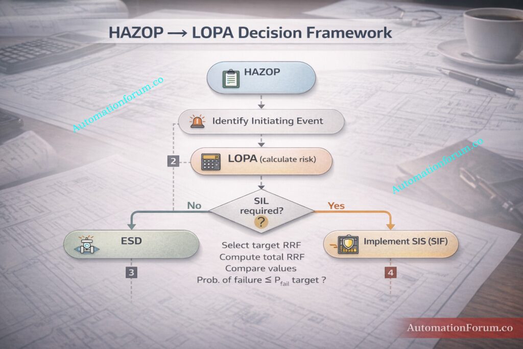

HAZOP and LOPA Decision Framework for ESD vs SIS
Using LOPA to Determine SIL Requirement
When a HAZOP identifies an initiating scenario, LOPA is used to determine whether existing protection is adequate:
- Identify initiating event and consequences.
- List existing layers of protection alarms, operator response, ESD, relief devices, SIS, physical barriers.
- Assign risk and required risk reduction.
- If existing protective layers do not achieve required risk reduction, design or upgrade SIFs, assign SIL targets, or modify operating procedures.
Refer the below link for the SIF PFDavg / SIL Verification – Complete Guide + Online Calculator (IEC 61508 / 61511)
When to Formalize ESD as SIS
Practical example: A pressure excursion is currently handled by ESD isolation via DCS. LOPA shows the ESD alone doesn’t achieve the needed risk reduction. The project team then determines whether to:
- Formalize the ESD as a SIF and apply SIL requirements (hardware architecture, diagnostics, proof testing), or
- Add additional independent protective layers (e.g., pressure relief, physical interlocks, operator procedural changes) until risk target met.

Practical Engineering Decision Framework
Step 1: Conduct HAZOP
Step 2: Identify hazard scenarios
Step 3: Perform LOPA
Step 4: Determine required risk reduction
Step 5: Assign SIL if required
Step 6: Determine independence needs
Step 7: Define proof test interval
Step 8: Document lifecycle requirements
If no SIL required → ESD sufficient
If SIL required → Implement SIS
