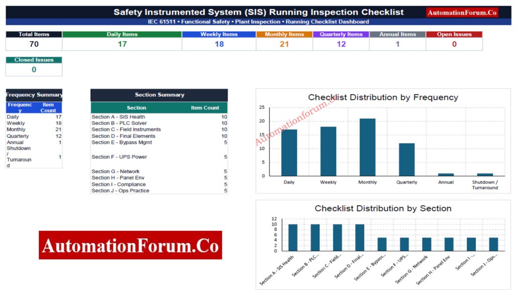

- Recommended SIS Inspection Frequencies
- Advanced SIS Inspection Checklist Excel Workbook
Professional and fully editable Safety Instrumented System (SIS) running inspection checklist workbook designed for IEC 61511 compliance, plant audits, shutdown reliability, safety PLC monitoring, field instrument inspection, and functional safety management. Includes dashboard, master checklist, section-wise inspection tabs, corrective action tracking, filters, dropdowns, conditional formatting, and due-date monitoring.
