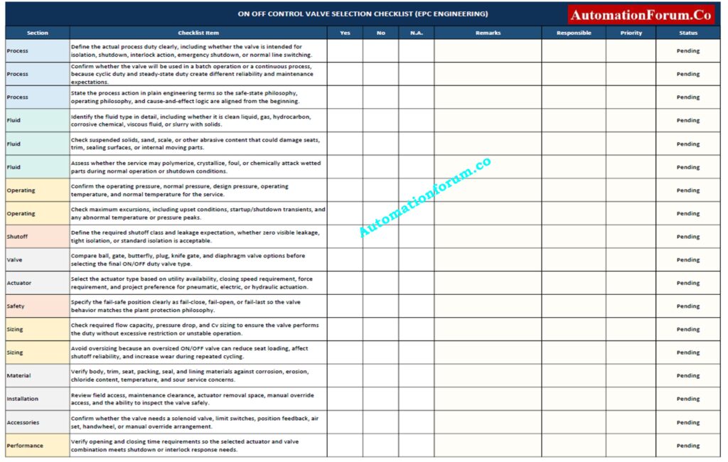

Engineering Checklist for ON OFF Valve Selection
| Parameter | Checked | Remarks |
| Fluid type | Yes or No | |
| Pressure rating | Yes or No | |
| Temperature | Yes or No | |
| Shutoff class | Yes or No | |
| Actuator type | Yes or No | |
| Fail position | Yes or No |
Additional checklist items: You should also verify line size, valve class, body material, seat material, limit switches, solenoid valve, manual override, response time, and maintenance space.
Practical rule
Do not begin with the valve catalog. Begin with the process safe state. First define what must happen during normal operation, trip, and utility failure. Then choose valve type, actuator, and fail position. This sequence reduces rework and improves reliability.

Download: Checklist for ON OFF Control Valve Type Selection Procedure for EPC Engineer
A ON OFF control valve selection checklist for EPC engineering, designed to help instrumentation and process engineers evaluate process duty, fluid condition, shutoff class, actuator type, fail-safe position, material selection, installation access, and vendor compliance in a clear and structured format.
