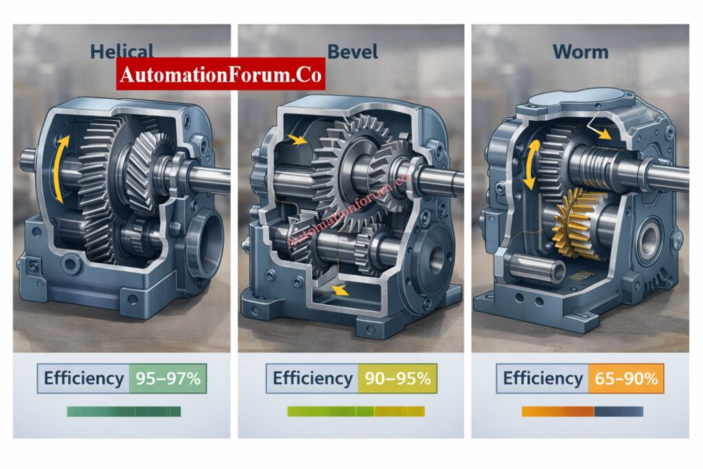

Gearbox Efficiency – The Hidden Loss
Gearboxes never transmit 100% of motor torque to the valve stem.
Typical efficiencies:
- Helical gearbox: 95-97%
- Bevel gearbox: 90-95%
- Worm gearbox: 65-90%
The calculator explicitly divides required torque by gearbox efficiency, ensuring that usable torque at the valve shaft is sufficient.
Ignoring efficiency can undersize actuators by 20-35%.

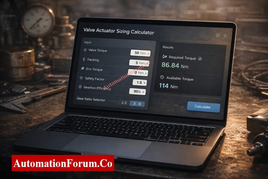

Ball Valve Actuator Sizing Example – Step-by-Step Calculation
Input Data for Actuator Sizing
- Valve torque: 50 Nm
- Packing friction: 5 Nm
- Environmental torque: 0 Nm
- Safety factor: 1.5
- Gearbox efficiency: 95%
- Actuator continuous torque: 20 Nm
- Motor speed: 1500 RPM
Step 1: Total Torque Calculation
Total Torque = 50 + 5 + 0 = 55 Nm
Step 2: Required Torque Calculation
Required Torque = (55 × 1.5) ÷ 0.95 = 86.84 Nm
Step 3: Gear Ratio Evaluation
Available torque is checked against standard ratios:
- 4:1 → insufficient
- 6:1 → acceptable
Available Torque = 20 × 6 × 0.95 = 114 Nm
Refer the below link to understand valve flow characteristics importance in EPC Instrumentation and Control Engineering
Step 4: Final Actuator Selection Output
- Required torque: 86.84 Nm
- Available torque: 114 Nm
- Practical torque margin: ~27%
- Output speed: 250 RPM
This confirms a safe and efficient actuator selection.
