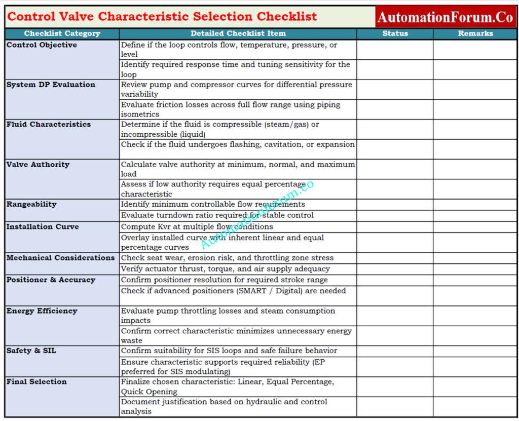

Practical Checklist for EPC Engineers Before Finalizing Valve Characteristics
Downloadable Excel Checklist for EPC Projects
Refer the below link to Download the Detailed Control Valve Characteristic Selection Checklist (Excel)
