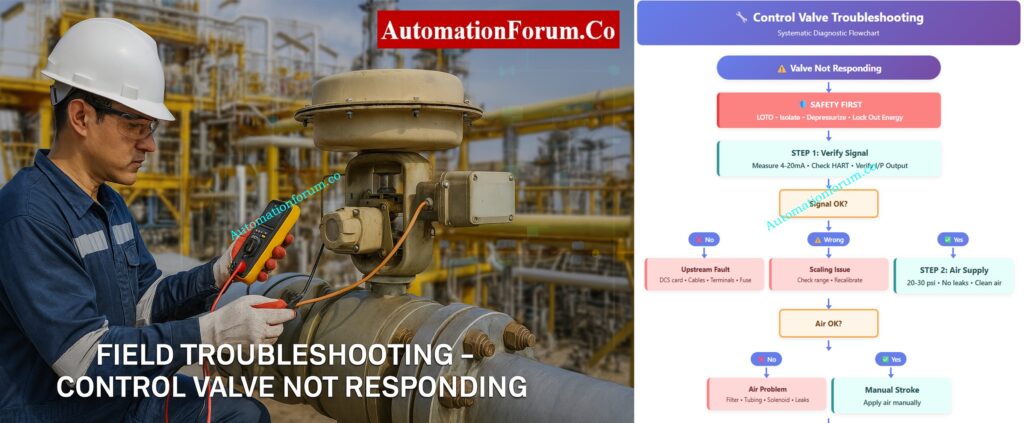

Reported Issue: A control valve in the process area does not move or respond to control system commands.
Objective: To safely and quickly find out if the problem is with the instrument signal, actuator, or valve body, and then fix the valve so that it works properly again without putting plant safety at risk.
Control Valve Not Responding – Troubleshooting Flowchart
🔧 Control Valve Troubleshooting
Systematic Diagnostic Flowchart
Repair/Replace
Workshop Repair

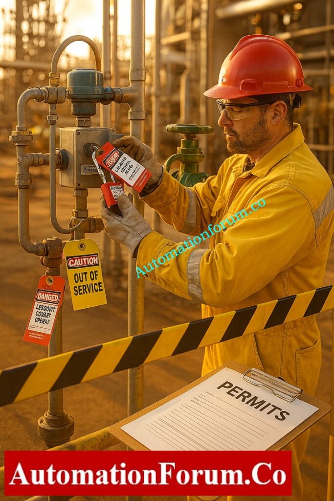

Safety First – Isolation and Preparation Steps
Coordination and Permits
Safety is the first and most important thing to do before touching the valve or any of the equipment that is attached to it. Control valves deal with process fluids that may be under high pressure, temperature, or even dangerous circumstances. Accidents can happen if you don’t handle things right.
Isolate the Process
Next, cut off the valve from the process line. You can achieve this by closing the block valves upstream and downstream or by going around the valve. Before you start any inspection, be sure that the length of pipe is not under pressure and has cooled to a safe working temperature.
Secure Energy Sources
Shut off and lock off any electrical, air, or hydraulic sources that are linked to the valve or positioner. Make sure these isolation locations are easy to find.
Warning: Never attempt to troubleshoot, stroke, or force a control valve that is still in service or pressurized. Doing so can cause mechanical damage or result in serious injury.

Step-by-Step Diagnostic Procedure
A organized diagnostic sequence makes it easy to find the issue location fast, without having to take things apart or stop working. Let’s go through each step carefully.
Must-Have Control Valve Accessories: Essential Control Valve Accessories for Reliable Process Control
Step 1: Verify the Control Signal
Purpose:
Before you touch the valve, make sure that the problem isn’t in the control command chain, which goes from the DCS/PLC to the valve positioner.
Action
Make sure that the electrical or pneumatic signal from the control system is getting to the valve positioner correctly.
How to Do It
- Use a calibrated digital multimeter (DMM) or loop calibrator to measure the 4–20 mA analog signal at the input terminals of the valve positioner.
- Look at the DCS faceplate to see the controller output and compare it to the measured signal.
- If the valve has a HART positioner, utilize a HART communicator or field communicator to make sure that the setpoint (SP) and feedback (PV) are what you anticipate them to be.
- Use a pressure gauge to check the output pneumatic signal for I/P (current-to-pressure) converters. It should be a straight line with the input current, such 4 mA = 3 psi and 20 mA = 15 psi.
- Check the junction box for loose or corroded terminals, broken wires, or water getting in.
Key Control Valve Performance Parameters: Essential Control Valve Performance Parameters
Findings and Interpretation
- There is no control signal, hence the problem is upstream. A bad DCS output card, an open circuit in the field cable, a shorted loop, a loose terminal, a blown fuse, or wrong marshalling could all be to blame.
- Signal is there but wrong: Check to see whether the DCS and field device have different signal scales or ranges.
- Signal is present and correct, so go on to Step 2: Check the health of the air supply and actuator.
