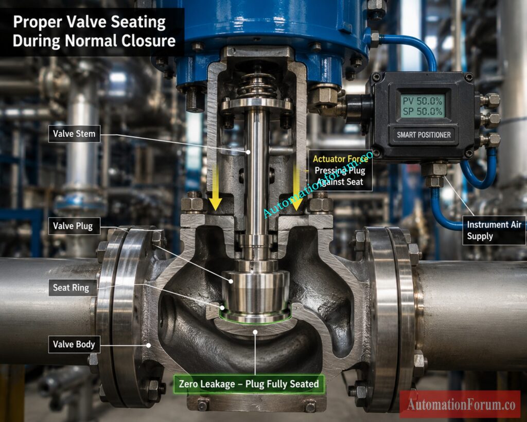

How a Control Valve Should Close Under Normal Conditions
If you understand the regular closing sequence it helps engineers determine where things go wrong.
When the process controller commands the valve to close, the positioner receives the command and changes the actuator pressure. Depending on the design of the actuator, the actuator stem is moved downwards or upwards by air pressure or by spring force.
The actuator transmits this movement to the valve stem, moving the plug toward the seat ring. The sealing surfaces form a tight barrier to stop process flow when the plug meets the seat.
In the last step of travel the actuator must produce sufficient force to overcome process pressure and positively seat the plug. If the closing force is too low, leakage may continue even after the valve position indicator reads zero percent.
The final seating force in the case of spring return actuators is provided by the spring in fail safe operation. Air powered actuators need instrument air pressure so that they have appropriate travel. Ball valves and butterfly valves are examples of rotary valves . They use the torque of the actuator to rotate the closure element to the fully closed position .
Within the valve, the last few millimetres of travel are the most essential. Even slight damage to the plug, seat ring, or stem alignment can hinder proper sealing and allow continued process flow.

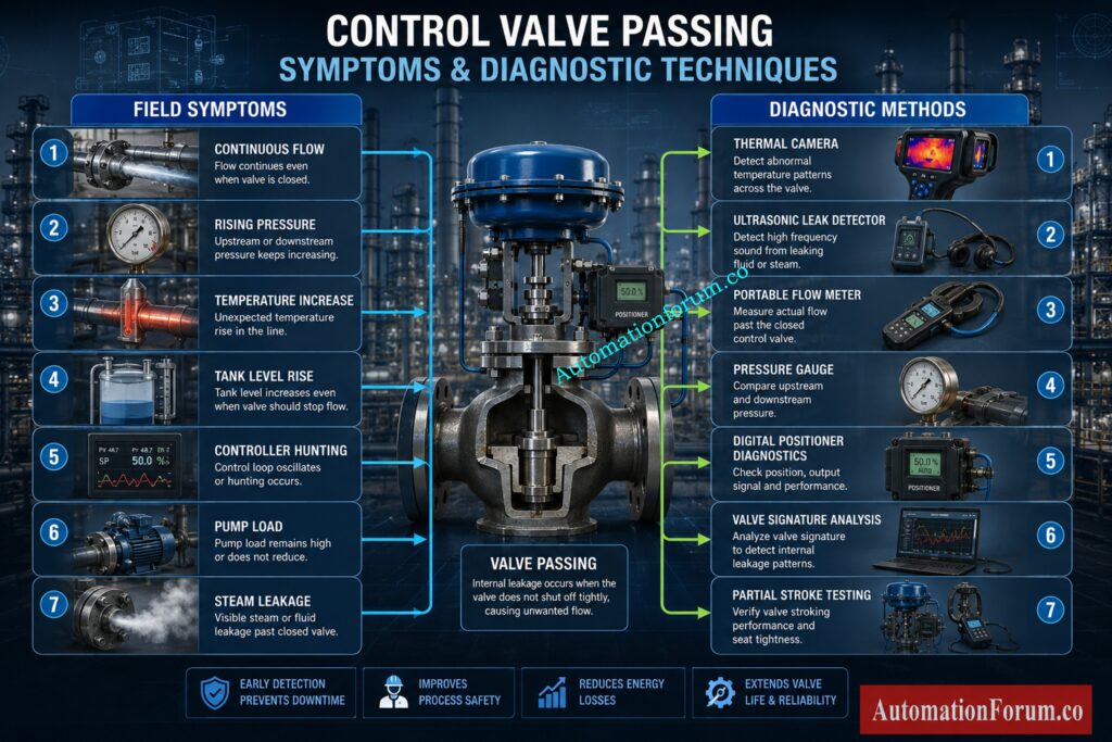

Common Symptoms of a Passing Control Valve
Recognizing field symptoms can allow engineers to discover valve passage before it causes major production losses.
The most visible indication is a constant flow when the controller is commanding the valve fully closed. Flow indicators may suggest a low flow rate, which is always more than zero.
In pressure control or isolation, downstream pressure may continue to increase after the valve is shut. This generally means seat leaking or no shutoff.
Steam control valves with internal leaks nevertheless transport heat to exchangers, reactors or process lines. This means that the temperatures stay above the desired operating point even with the valve fully closed.
Stop Expensive Valve Failures Using These Proven Engineering Practices: Control Valve Body Material Selection Guide for EPC Design Instrumentation Engineers
A passing relief valve admits undesired flow that prevents the pumps from unloading effectively. Typical results are increased power usage and excessive wear on equipment.
Poorly closed gas control valves may allow compressors to stay loaded longer than planned, lowering efficiency and raising operating costs.
A little seat leakage in steam systems can add up to a lot of heat energy. Operators can see steam traps cycle continually or equipment remain hot long after shutdown.
Valve passing means uncontrolled flow into the process and leads to changes in pressure, temperature or flow which are hard for the control system to stabilize.
Since the process never reaches the target state, the controller will keep changing the valve position. Constant movement leads to wear on the valve and the actuator.
Closed valves may allow process fluid to pass, making it impossible for maintenance staff to properly separate pipes or equipment. This leads to delays in operations and possibly safety issues.
While valve leakage may seem insignificant, persistent product loss, high steam consumption, control problems, and process adjustments eventually lead to the steady decline in plant efficiencies and the increase in operating costs.

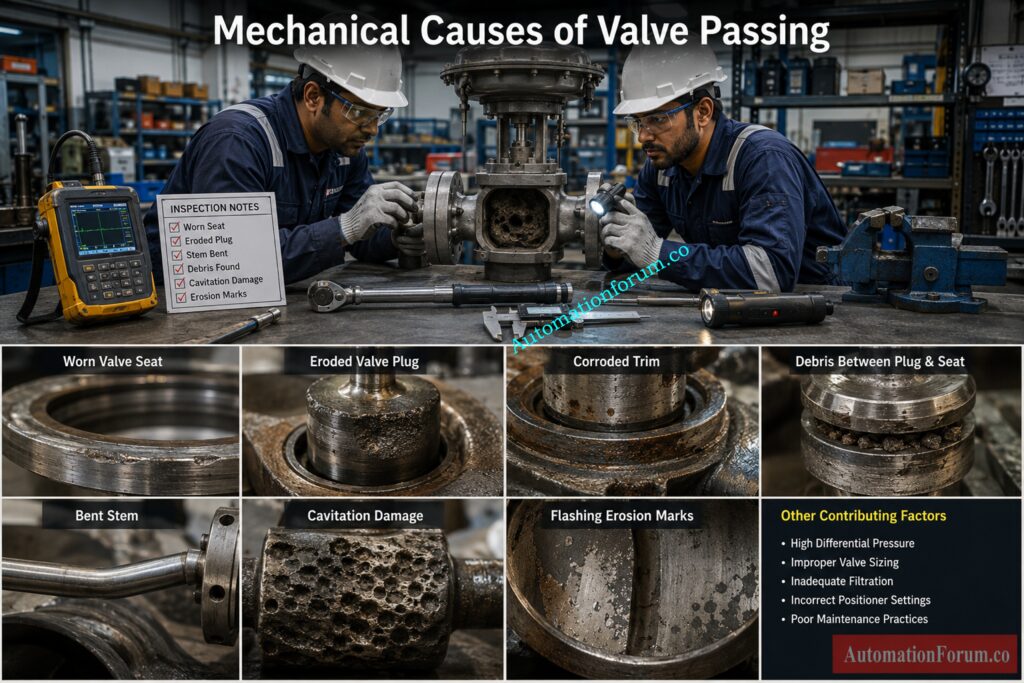

Major Causes of Control Valve Passing
What is the main sealing surface in the control valve? Valve seat. Over time, service that is continuous might cause the seat to wear, dissolve or corrode, impeding tight shutdown. The most common place where wire drawing occurs in steam systems is where high velocity steam slowly grooves the sitting surface. In slurry applications the abrasive particles impact the seat continually and the erosion increases. Other reasons for the plug not sealing correctly could be mechanical damage during maintenance or incorrect assembly.
The valve plug must seal the seat tightly to stop flow. Uneven contact between plug and seat is caused by scratches, corrosion, impact damage or bent stems. Under high differential pressure, any minor surface flaw can cause significant leakage. Misalignment might be caused by worn guides or incorrect installation; this can further impair sealing efficacy.
Decode Cv and Kv Relationships for Smarter Valve Engineering Decisions: Relationship Between Cv and Kv in Control Valves
During closure, rust flakes, welding slag, scale, sand, packing pieces or other process debris are often caught between the plug and seat. The plug never fully seats but sits on the trash and there is a leak channel . Cycling or flushing the valve will clear the obstruction in certain circumstances, but normally the problem will return until the process line is properly cleaned.

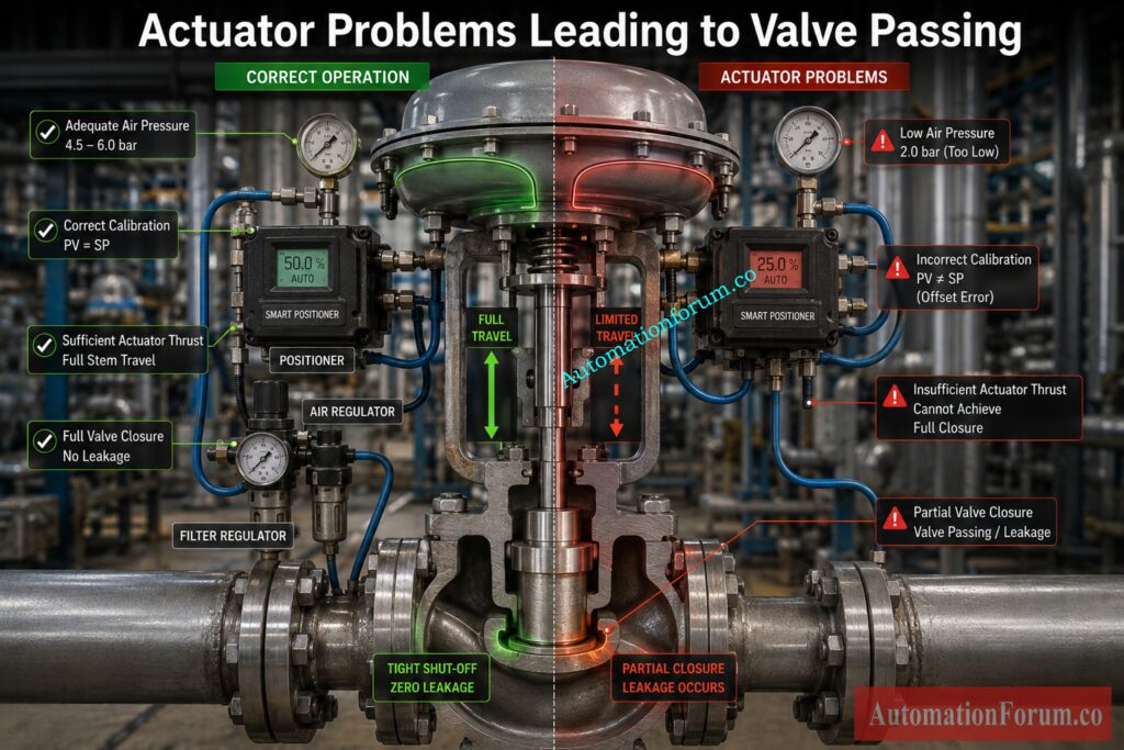

The valve may not reach its designed closed position if the stem is improperly adjusted, if the travel limits are incorrect, if the mechanical stop settings are incorrect, or if the actuator thrust is insufficient. The position indicator reads zero percent, yet the plug may still be slightly above the seat, and a continual leak may occur. Accurate calibration and travel confirmation are required following maintenance or actuator change.
Major Causes of Control Valve Passing - Incorrect Actuator Adjustment
Pneumatic control valves require clean, dry instrument air at the proper pressure. Low air pressure lowers the thrust of the actuator and prevents the valve from sitting correctly. Air leaks in tubing or fittings, clogged air filters, a malfunctioning regulator and moisture contamination may affect actuator operation. Engineers should not assume a valve is faulty until they have checked the air supply pressure.
If the positioner is not adjusted properly it can prematurely stop the actuator before the valve is fully closed . Worn mechanical linkages, loose feedback arms, pneumatic leaks and wrong digital positioner settings all contribute to imprecise valve positioning. Most smart positioners today save diagnostic data that can help you spot excessive friction, trip deviation or calibration drift.
In regular service a large control valve is generally operated close to the closed position. Thus, small stem movement causes huge flow variations and proper shut-off is difficult. Low valve authority leads to decreased control stability and increased trim wear. Proper valve sizing during design is important for optimum control performance and reliable cutoff.
The greater the pressure differential across a closed valve, the greater the force on the plug and seat. The actuator might not create sufficient seating force for tight shutdown if the valve is not made for such conditions. Some harsh service applications require pressure balanced trim or specifically constructed valves to accommodate the high differential pressure.
Near the vapor pressure , liquid services can encounter cavitation or flashing.  Cavitation causes the formation of vapor bubbles which collapse violently on the internal valve surfaces creating severe pitting. It occurs when a liquid is permanently changed to vapor . This causes continued erosion . Both slowly erode away at the seat and plug and ultimately cause interior leaks.
High velocity process fluids containing abrasive particles constantly erode valve trim components. Trim erosion is common in power plants, mining activities and slurry handling systems. As the sealing surfaces degrade, leakage increases until the valve no longer provides satisfactory shutdown performance.
The packing is supposed to seal around the valve stem . Too much packing compression can increase stem friction . High friction inhibits the stem from moving smoothly and may keep the valve from reaching its final seating position. The correct packing adjustment will ensure a reliable seal without limiting the travel of the valve.
Unlock Superior Valve Accuracy Using Advanced Positioner Technologies: Why You Should Use Control Valve Positioners?
Bent stems, worn stem guides, severe pipe tension, or improper installation procedures can cause the plug and seat to become misaligned. Even minor misalignment hinders uniform seating and generates leakage routes. Check the guide condition and the stem straightness when overhauling valves.
Internal mechanical faults in the actuator can greatly diminish the closing force. When springs are broken, diaphragms are ruptured, pistons are damaged, seals are worn or mechanical elements are sticking, the actuator cannot accomplish its entire stroke. A routine inspection of an actuator can catch these problems before they impede process performance.
Selecting the wrong valve type for the application often leads to persistent leakage problems.

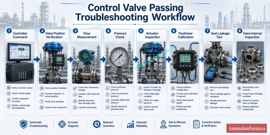

How to Troubleshoot a Passing Control Valve
A systematic troubleshooting approach prevents unnecessary valve replacement.
  1. Confirm valve command. confirm that the control system is truly directing the valve to zero percent
  2. Check Valve Position Feedback. Check the position of the valve against the controller output. Differences may suggest difficulties with the positioner or actuator.
  3. Measure in use flow. Do not rely just on valve position. Check for leaks using the process flow meter or a portable flow meter.
  4. Check upstream and downstream pressure Abnormal pressure circumstances can imply too much differential pressure or unanticipated process modifications.
  5. Verify actuator travel. Check that the actuator moves smoothly to its mechanical stop without sticking or hesitating.
  6. Do a stroke test. Slowly cycle the valve through its full trip checking for smooth operation .
  7. Check the instrument air pressure. Measure the supply pressure to the actuator while the valve is moving.
  8. Perform a seat leakage test Compare measured leakages with shutdown class of valve as given.
  9. Check-valve internals. During shutdown check the plug, seat, stem, guides and trim for wear or damage.
  10. Check valve sizing, process conditions. Confirm that the valve is suitable for current operating conditions and required shutoff performance.
Field experience shows that combining process data with physical inspection usually identifies the true root cause much faster than replacing components one by one.

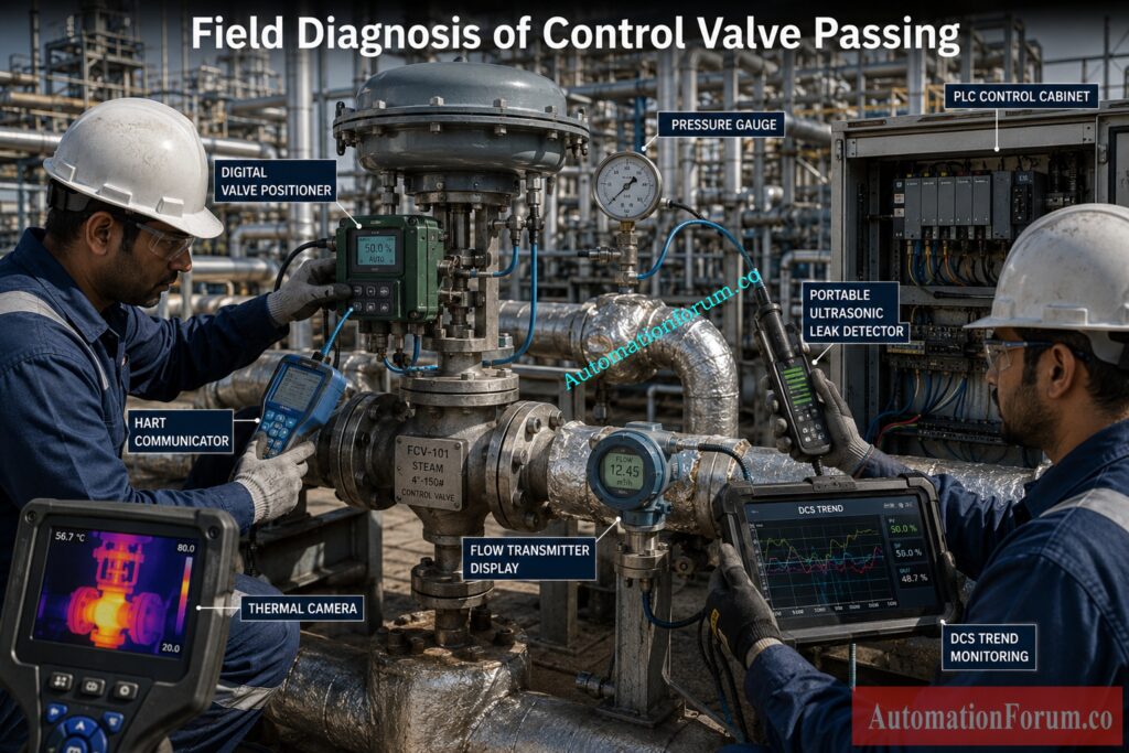

Field Diagnostic Techniques for Detecting Control Valve Passing
Modern plants use several diagnostic methods to confirm internal valve leakage.
  • Pressure gauges reveal unexpected pressure changes across a closed valve.
  • Leaking steam valves can be detected using temperature readings which show unwanted heat transfer.
  • Portable flow meters are used to verify that fluid continues to flow after a valve is shut.
  • An ultrasonic leak detector listens for the high-frequency sound that is produced by an interior leak.
  • Thermal cameras detect hot regions and can immediately find faulty steam valves.
  • Valve signature analysis evaluates the features of friction, seating force and travel.
  • Digital valve controller diagnostics indicate travel deviation, hysteresis and excessive friction.
  • Partial stroke testing confirms the actuator is moving without stopping the plant.
  • Acoustic monitoring detects the noise from a leak before it shows up in the process measures.
  • Vibration analysis can detect aberrant mechanical behavior induced by the unstable operation of valves.
  • Online condition monitoring provides continuous monitoring of valve health and facilitates predictive maintenance strategies.

Yeah. A mis-calibrated or failing positioner can allow the actuator to stop short of fully closing the valve. With proper calibration and verification of the position feedback this can be promptly identified.
