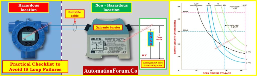

Practical Checklist to Avoid IS Loop Failures
To make sure that intrinsically safe loops are built, installed, and kept up, a thorough verification approach is needed. The following checklist goes into further detail about the six stages that every engineer should take.
| Step | What to Verify | Detailed Explanation | Standard / Best Practice |
| 1 | Ensure Zener barrier ground resistance is less than 1 Ohm | There must be a separate ground for each Zener barrier that has a resistance of less than 1 Ohm. This makes sure that if there is a problem, too much current is securely sent to the ground without creating dangerous voltages in the dangerous area. Grounding should not depend on structural steel or lightning systems. To find rust, loose lugs, or broken ground conductors, it is important to check them regularly. | IEC 60079 / EN 60079 |
| 2 | Keep IS and non-IS circuits at least 50 mm apart from each other. | Wiring, terminals, and devices that are intrinsically safe must be at least 50 mm away from non-IS circuits or separated by barriers. This stops electrical problems or wiring mistakes from sending dangerous energy into IS loops. Long-term dependability and compliance depend on proper separation in junction boxes, panels, and cable trays. | EN 60079-14 |
| 3 | Label all Ex enclosures with light blue identification | Permanent light blue labels, plates, or tags must be used to clearly indicate all enclosures that hold IS circuits. This stops people from accidentally changing things, mixing things up, or doing risky maintenance. Using engraved or long-lasting labels that can handle tough industrial settings is standard practice. For simple recognition, blue color coding must be the same across the building. | IEC/EN labeling rules |
| 4 | Use only light blue-sheathed cables for IS circuits | Light blue sheathing or insulation must be used to wire intrinsically safe circuits so that they can be easily seen. To avoid confusion, these wires should not be used for anything other than IS. To prevent wires from mechanical stress and gland damage, junction boxes should be placed so that the bend radius is correct. In places where the weather is bad, it’s best to use protective conduit or tray routing. | EN 60079-14 |
| 5 | Select and install certified cable glands, seal unused entries | Cable glands must be able to handle explosions, fit the cable’s diameter, and be put in according to the manufacturer’s torque specifications. This makes sure that the seal is still good and that there is less mechanical stress. All empty enclosure entries must be sealed with certified blind plugs or bushings. Regular checks should make sure that the glands are still intact, tight, and undamaged. | IEC 60079 / Manufacturer guidelines |
| 6 | Keep full descriptive documentation for all IS loops | All documentation must be complete, including loop diagrams, certificates of conformity, datasheets, and calculation reports. This makes guarantee that each installed IS loop is the same as the approved design and can be checked during audits or maintenance. After changes are made, records should be updated and kept in a central system that EPC, QA/QC, and commissioning teams can all access. | IECEx / IEC 61508 / IEC 61511 |
