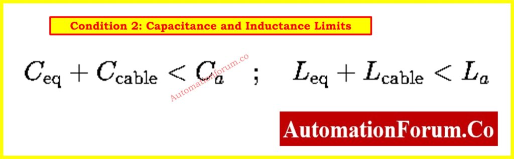

Condition 2: Capacitance and Inductance Limits
Where:
- Ceq = Internal capacitance of the field device
- Ccable = Capacitance introduced by the connecting cable (μF/km)
- Ca = Maximum allowed external capacitance at device terminals
- Leq = Internal inductance of the field device
- Lcable = Inductance introduced by the cable (mH/km)
- La = Maximum allowed external inductance at device terminals
Purpose: This condition limits the total stored electrical energy in the circuit. If the combined capacitance and inductance exceed the device’s limits, even a small current interruption could generate a high-energy spark, leading to ignition in hazardous areas.
Tip: Cable specifications typically include C and L per meter. Multiply by total length and compare against the allowable values.
