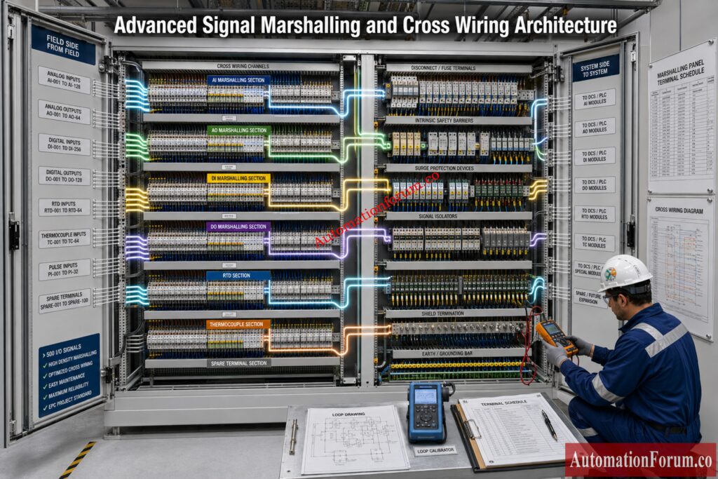

What Is a Marshalling Panel in Instrumentation?
A Marshalling Panel is the organized signal routing point between field terminations and the control system. It is where incoming signals are redistributed so they match the layout and channel order of the DCS or PLC system.
A Marshalling Panel is a signal arrangement enclosure used to receive field wiring and route it toward the correct control system inputs and outputs.
Why Marshalling Panels Are Used in EPC Projects
Field wiring is arranged by physical location, equipment grouping, or cable pull convenience. Control system wiring is arranged by I O card type, signal type, loop design, and system architecture. These two arrangements usually do not match. Marshalling exists to bridge that gap.
What Is Signal Marshalling?
The purpose of marshalling is to sort, segregate, identify, and route each signal correctly. It also allows a design team to separate analog, digital, RTD, thermocouple, pulse, and special purpose circuits in a disciplined way.
A good marshalling design creates a clear path from the field side to the control side. It reduces confusion during commissioning and supports long term maintenance. It also allows engineers to trace every loop from field device to controller channel.

Cross Wiring Concept in a Marshalling Panel
Cross wiring is the practice of taking a field side termination and connecting it to a different outgoing termination that matches the controller or I O system requirement. This is essential when field cable order does not match control system card order.
Signal Segregation in Marshalling Panels
A robust marshalling panel keeps the following signal groups properly separated:
- Analog Inputs
- Analog Outputs
- Digital Inputs
- Digital Outputs
- RTD signals
- Thermocouple signals
- Pulse signals
This separation reduces noise problems, avoids wiring errors, and makes troubleshooting much easier.

Internal Components of a Marshalling Panel
Typical Marshalling Layout
The incoming side receives field cables or cables from Junction Boxes. The outgoing side sends organized signals toward the system cabinet or controller I O arrangement. Each signal should be traceable through the panel without ambiguity.
