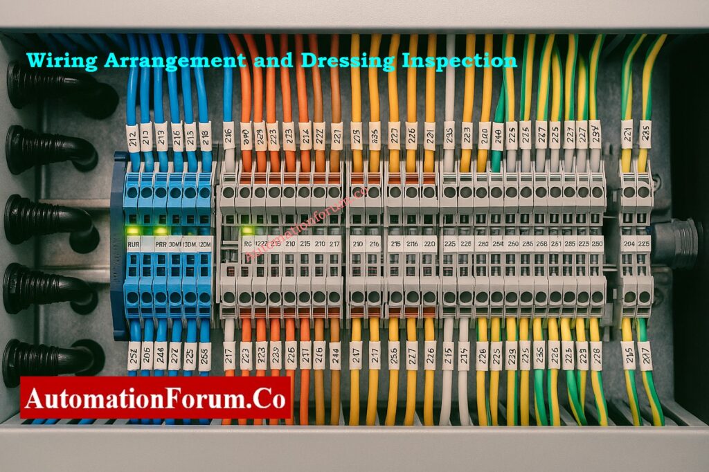

Section 6: Wiring Arrangement, Dressing, and Glands
| Inspection Point | Observation Details | Acceptable Condition | Action / Remarks |
| Wiring arrangement | Inspect internal routing and terminations. | Neat, segregated per voltage level. | Re-route during shutdown if needed. |
| Trunking and ducts | Check for cracks, missing covers, or debris. | Covers intact, no loose wires. | Replace damaged sections. |
| Cable ties and dressing | Observe tie condition and spacing. | No strain, no over-tight ties. | Replace brittle or broken ties. |
| Cable glands | Check for tightness and sealing. | No dust or oil ingress. | Re-torque during shutdown. |
| Ferrule and label visibility | Ensure all wire IDs match drawings. | All legible, matching I/O list. | Reprint faded ferrules. |
| Deviation check | Identify non-standard routing or open ducts. | None acceptable. | Raise SAP notification. |
Caution: Don’t try to make mechanical changes while the machine is running. All physical fixes must be scheduled for the next time maintenance is due.
