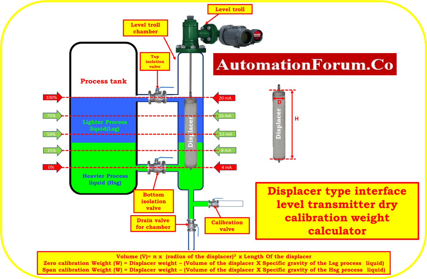

Formula for the calculation
Formula for the volume of the displacer
Volume of the displacer V = ?r2h
Where,
r = Radius of the displacer.
h = Length of the displacer.
D = Diameter of the displacer
Formula for calculating the displacer weight loss due to process liquid
Displacer weight loss due to process liquid =Volume of the displacer X Specific gravity of the process liquid
Formula for zero apparent weight calibration
Weight for zero calibration = Displacer Actual Weight(W) – (Displacer Actual Volume X specific gravity of the Lsg liquid)
Where
Lsg = Specific gravity lighter process liquid
W = Actual weight of the displacer
Formula for span apparent weight calibration
Weight for Span calibration = Displacer Actual Weight(W) – (Displacer Actual Volume X specific gravity of the Hsg liquid)
Where
Hsg = Specific gravity heavier process liquid
Example calculation
Displacer and process liquid characteristics:
W = Displacer weight is 2400 Gram
D = Displacer diameter is 7.0 Centimeter
H = Length of Displacer is 32.42 Centimeter
Lsg = Specific gravity of lighter process liquid is 0.7
Hsg = Specific gravity of Heavier process liquid is 1.0
V = Volume of displacer.
So,
Radius of the displacer r = 7.0/2 = 3.5 centimeters
Displacer Actual volume V = ?r2h
Volume V = 3.14 × r² × h
= 3.14 × 3.5 × 3.5 × 32.42 = 1247.04 cubic centimeter
Zero calibration weight value calculation (0%)
Displacer weight loss due to lighter process liquid = Displacer Actual Volume X Specific gravity of the Lsg liquid
Weight for zero calibration = Displacer Actual Weight (W) – (Displacer Actual Volume X Specific gravity of the Lsg liquid
Weight for zero calibration = 2400 – (1247 X 0.7)
= 2400 – 872.9
Weight for zero calibration =1527.1 grams
Span calibration weight value calculation (100%)
Displacer weight loss due to heavier process liquid = Displacer Actual Volume X Specific gravity of the Hsg liquid
Weight for Span calibration = Displacer Actual Weight (W) – (Displacer Actual Volume X specific gravity of the Hsg liquid)
Weight for Span calibration = 2400 – (1247 X 1.0)
= 2400 – 1247
Weight for Span calibration =1153 grams
Weight for each 25% calibration check of linearity
Actual span weight is calculated by subtracting the weight lost by the displacer due to the heavier process liquid (Hsg) and the lighter specific gravity liquid (Lsg).
Actual span weight = 1247 – 872.9
Actual span weight = 374.1
For each 25% = Actual span weight/4
= 374.1/4
For each 25% = 93.525 grams
