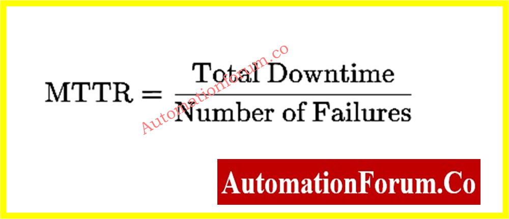

MTTR Calculation Formula
Where:
- MTTR = Mean Time To Repair (in hours or minutes)
- Total Downtime = Sum of time spent repairing over a defined period
- Number of Failures = Number of repairable failure events in that period
Note: MTTR does not include scheduled shutdowns or maintenance that is done to prevent problems. It only talks about what to do following an unanticipated failure.
