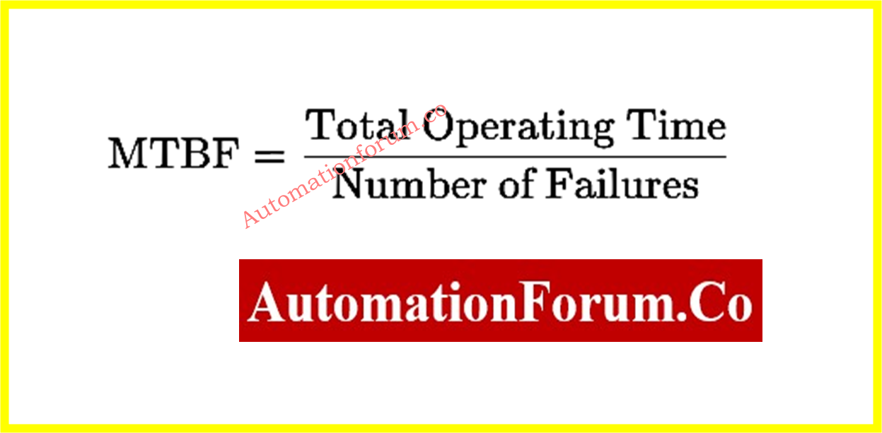

What is the MTBF formula?
Formula used in MTBF Calculation
The MTBF is calculated using a below simple formula:
Where:
- MTBF = Mean Time Between Failures (in hours)
- Total Operating Time = The cumulative operational time of the system (in hours)
- Number of Failures = Count of observed breakdowns or malfunctions during that time
Designed mostly for repairable systems, this formula assumes a constant failure rate. MTBF offers no indication of time to first failure. It shows the typical interval between two successive failures in regular running.
