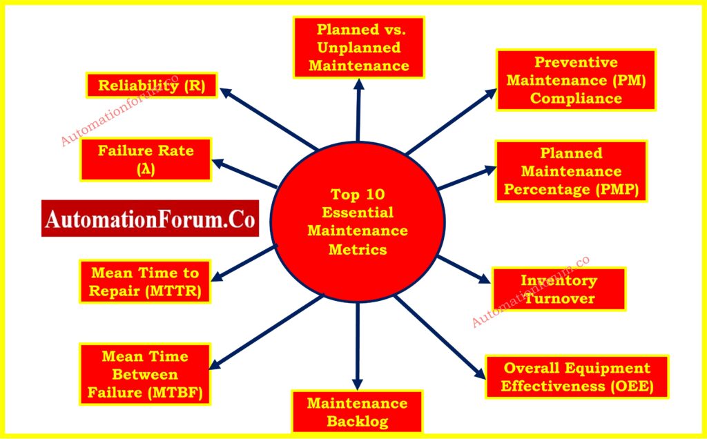

In today’s competitive business world, it’s very important for equipment to be up and running, reliable, and perform well. Tracking, optimizing, and improving maintenance operations are key to keeping productivity high in any type of business, whether it’s a factory, a utility company, or a facilities management company. Maintenance KPIs, or maintenance metrics, let businesses measure how well their maintenance plans are working and make better decisions.
The following guide goes into great detail about the most significant maintenance metrics used in all industries, using the attached infographic as a reference. It also discusses how each one is essential for ensuring operational excellence.

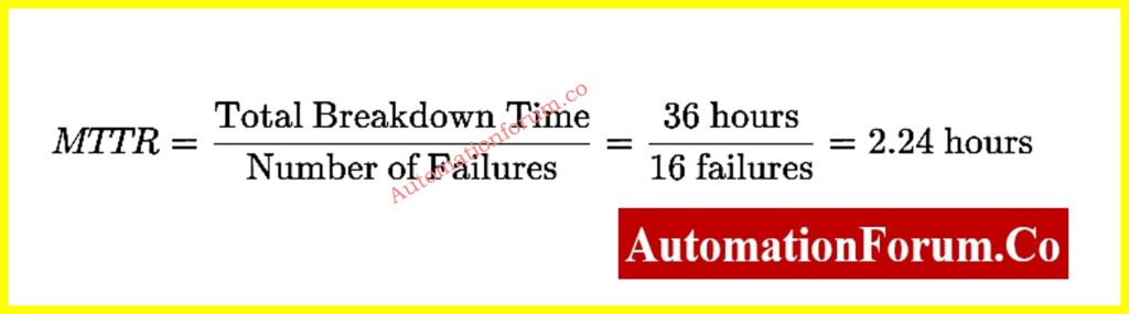

2. Mean Time to Repair (MTTR)
Definition:
MTTR is the average time it takes to find out what’s wrong with a broken part or system and fix it so it works again.
Formula:
Explanation:
This indicator measures how soon repair crews can get broken equipment back in working order. It covers the time it takes to fix something after it breaks down and get it back to full operation.
Importance:
A reduced MTTR means that maintenance can respond more quickly and effectively, which cuts down on downtime and productivity losses. Regularly checking MTTR can also show where procedures aren’t working well or where people need further training.

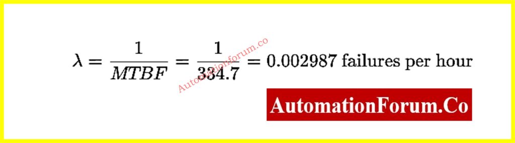

3. Failure Rate (?)
Definition:
The failure rate indicates you how often a part or system fails in a certain amount of time. It’s the opposite of MTBF.
Formula:
Explanation:
This tells you how likely it is that something will fail in a certain amount of time (for example, the hourly failure rate).
Importance:
Knowing the failure rate helps engineers and reliability experts figure out how risky an operation is. A higher failure rate can make it necessary to rebuild, update, or change maintenance programs.

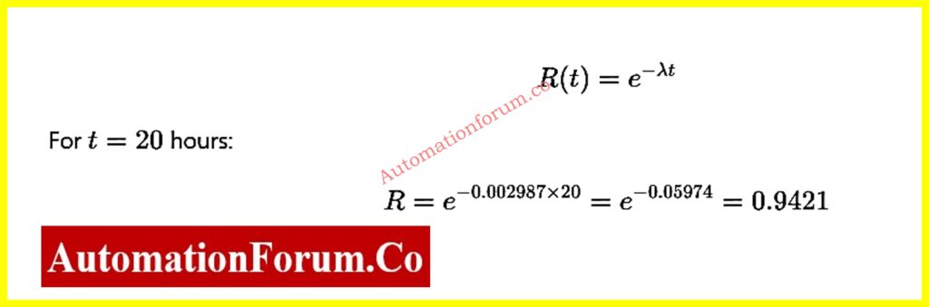

4. Reliability (R)
Definition:
Reliability is the chance that a system will work without breaking down for a set amount of time under certain conditions.
Formula:
Explanation:
In this case, the chance that the system will work without breaking down for 20 hours is 94.21%.

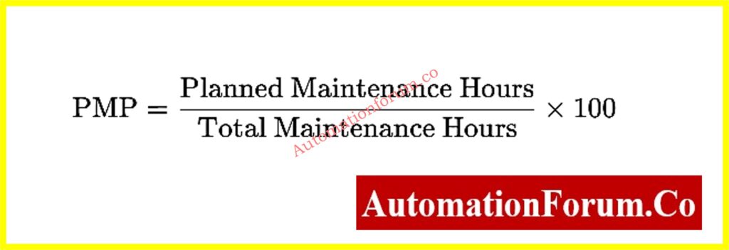

7. Planned Maintenance Percentage (PMP)
Definition:
The planned maintenance percentage is the number of hours spent on planned chores compared to the overall number of hours spent on maintenance.
Formula:
Explanation:
This displays how much of your maintenance plan is proactive instead of reactive.
Importance:
A maintenance department with high PMP values is doing a good job. Organizations are less likely to have unexpected failures or downtime if more than 90% of their maintenance activity is planned.

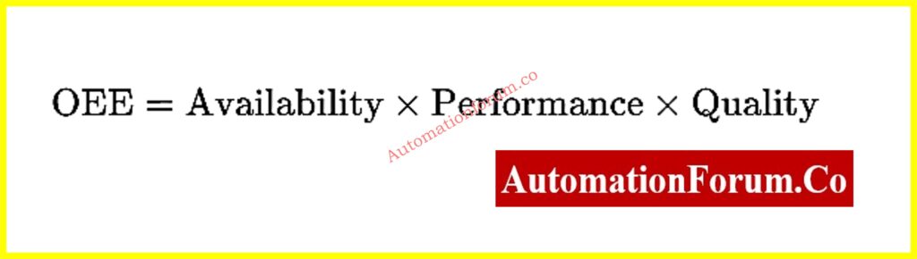

9. Overall Equipment Effectiveness (OEE)
Definition:
OEE is a measure of how well a machine is being used. It is made up of three main parts: availability, performance, and quality.
Formula:
Explanation:
It shows the percentage of time spent on manufacturing that is actually
Importance:
A low OEE could mean that there are difficulties like machines that break down often, cycles that take a long time, or errors in quality. A world-class OEE is 85% or greater.
