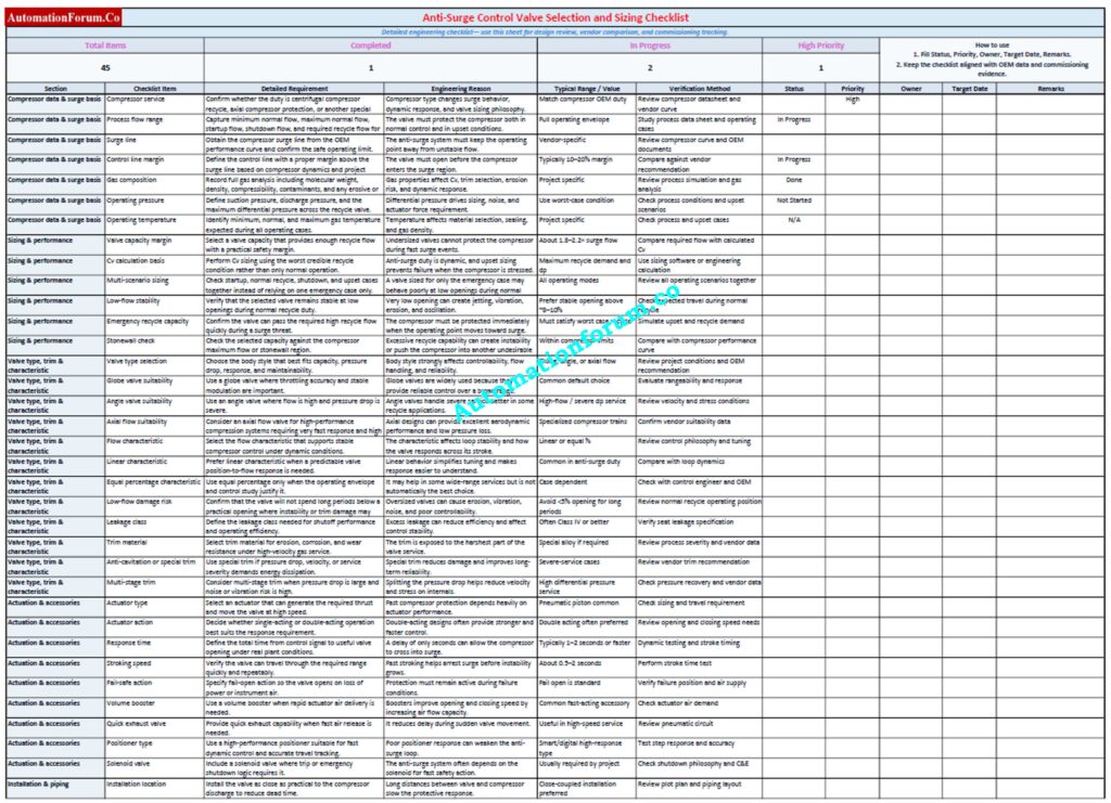

Anti-Surge Valve Selection Checklist (Detailed Table)
| Parameter | Detailed Requirement | Engineering Reason | Typical Range or Value | Verification Method | Remarks |
| Compressor service | Define whether the valve is for centrifugal compressor recycle duty, axial compressor protection, or a special high performance compression system. | The compressor type directly affects surge behavior, response demand, and valve sizing philosophy. | Centrifugal service is most common. | Review compressor datasheet and vendor performance curve. | This is the first selection point. |
| Process flow range | Identify minimum normal flow, maximum normal flow, startup flow, shutdown flow, and recycle flow requirement. | The valve must handle both normal control and emergency recycle duty. | Full operating envelope must be available. | Study process data sheet and operating cases. | Do not size only for one operating case. |
| Surge line | Obtain the compressor surge line from the OEM curve. | The valve must keep the operating point safely away from surge. | Vendor specific. | Review compressor curve and OEM technical documents. | This is mandatory for selection. |
| Control line | Define the control line with proper safety margin above the surge line. | The anti surge system must open before the compressor enters unstable operation. | Usually 10 to 20 percent above surge line, depending on project philosophy. | Compare with compressor vendor recommendation. | Margin should be based on dynamic study. |
| Gas composition | Record full gas analysis including molecular weight, density, compressibility, and contaminants. | Gas properties affect Cv, trim selection, erosion risk, and dynamic response. | Project specific. | Review process simulation and gas analysis report. | Accuracy is very important. |
| Operating pressure | Define suction pressure, discharge pressure, and maximum differential pressure across the valve. | Differential pressure controls valve sizing, noise, and actuator force requirement. | Wide variation possible. | Use worst case operating condition. | High differential pressure service needs careful review. |
| Operating temperature | Identify minimum, normal, and maximum gas temperature. | Temperature affects material selection, sealing, and gas density. | Project specific. | Check process conditions and upset scenarios. | High temperature may require special materials. |
| Valve capacity margin | Select a valve capacity that provides enough recycle flow with safety margin. | Undersized valves cannot protect the compressor during surge events. | Typically 1.8 to 2.2 times the surge flow requirement. | Compare calculated Cv with required recycle flow. | Do not oversize without analysis. |
| Cv calculation basis | Perform Cv calculation using the worst credible recycling condition, not just normal operation. | Anti surge duty is dynamic and worst case based sizing prevents failure in upset conditions. | Based on maximum recycle demand and pressure drop. | Use valve sizing software or engineering calculation. | This is a core design step. |
| Valve type | Choose the valve body style based on capacity, speed, and pressure drop. | Different valve types provide different controllability and flow capacity. | Globe valve, angle valve, or axial flow valve. | Review project conditions and OEM recommendation. | Globe is common for general use. |
| Globe valve suitability | Use globe valve where good throttling and stable control are required. | Globe valves provide reliable modulation and good controllability. | Standard choice in many compressor systems. | Evaluate required flow range and response. | Common in many anti surge applications. |
| Angle valve suitability | Use angle valve where high flow and severe pressure drop are expected. | Angle valves can handle flow more efficiently and reduce some stress conditions. | Large flow and severe service cases. | Review pressure drop and velocity. | Useful in demanding recycle services. |
| Axial flow valve suitability | Use axial flow design for high performance applications requiring very fast response and high capacity. | Axial designs can provide excellent aerodynamic performance and fast stroking. | Specialized compressor systems. | Check OEM or specialist valve vendor data. | Often used in advanced compressor trains. |
| Flow characteristic | Select the valve characteristic that matches the compressor control strategy. | Characteristic affects controllability, loop stability, and response quality. | Linear often preferred, equal percentage in some cases. | Review control philosophy and tuning study. | Characteristic should suit dynamic response. |
| Linear characteristic | Prefer linear characteristic when predictable valve travel to flow response is needed. | It provides stable behavior and simplifies control tuning. | Frequently used in anti surge service. | Compare against loop dynamics. | Very common in compressor recycle duty. |
| Equal percentage characteristic | Use equal percentage only when system dynamics justify it. | It can provide better control over a wide operating range in some services. | Case dependent. | Check with control engineer and OEM. | Not always the first choice. |
| Actuator type | Select actuator based on required thrust and response speed. | Anti surge valves need powerful and fast actuators. | Pneumatic piston actuator is common. | Check sizing calculations and travel requirement. | Actuator selection is critical. |
| Actuator action | Determine whether single acting or double acting design is needed. | Double acting designs often provide better speed and stronger movement control. | Double acting preferred in many systems. | Review opening and closing speed requirements. | High performance service often needs double acting. |
| Response time | Define the total valve response time from signal to full useful opening. | Surge can develop within seconds, so delay can destroy protection. | Often 1 to 2 seconds or faster, depending on project. | Dynamic testing and stroke timing. | This is one of the most important criteria. |
| Stroking speed | Check how fast the valve moves through the full travel range. | Fast stroking improves ability to arrest surge quickly. | About 0.5 to 2 seconds in many applications. | Perform stroke time test. | Must match compressor dynamics. |
| Fail safe action | Ensure the valve fails open on air or power loss. | Compressor protection must remain active during failure conditions. | Fail open is standard practice. | Verify spring or air failure action. | Mandatory for protection duty. |
| Volume booster | Provide a volume booster where rapid air delivery is needed. | Boosters improve opening and closing speed. | Common accessory in fast acting valves. | Check actuator air demand and flow rate. | Strongly recommended for fast loop response. |
| Quick exhaust valve | Include quick exhaust capability where fast air release is required. | It helps the valve move faster during sudden action. | Used in high speed service. | Review actuator pneumatic circuit. | Helps reduce delay in motion. |
| Positioner type | Use a high performance positioner suitable for fast dynamic control. | Accurate signal tracking is essential for surge protection. | Smart or digital high response positioner. | Test step response and positioning accuracy. | Basic slow positioners may not be suitable. |
| Solenoid valve | Provide solenoid valve for trip and shutdown functions. | Required for safety logic and emergency operation. | Project dependent, but usually required. | Check shutdown philosophy and cause and effect. | Important for trip integration. |
| Noise control | Evaluate noise generation caused by high pressure drop and high velocity gas. | Excessive noise indicates severe energy loss and possible trim damage. | Severe service may need special trim. | Perform acoustic or velocity review. | Noise is often high in recycle duty. |
| Vibration control | Check vibration risk in trim, piping, and supports. | Vibration can damage valve internals and surrounding equipment. | Depends on flow and pressure drop. | Review piping stress and dynamic analysis if needed. | Ignore only at high risk. |
| Anti cavitation trim | Use special trim when service conditions demand energy dissipation and damage control. | It reduces erosion and protects internal parts. | Needed in severe pressure drop service. | Review vendor trim recommendation. | More common in difficult services. |
| Multi stage trim | Consider multi stage trim for high differential pressure and noisy service. | It distributes pressure drop and reduces velocity. | Severe service application. | Check pressure recovery and vendor data. | Improves reliability in harsh conditions. |
| Installation location | Install the valve as close as possible to compressor discharge. | Shorter distance reduces dead time and improves system response. | Close coupled installation preferred. | Review plot plan and piping layout. | Long recycle lines reduce protection speed. |
| Recycle line volume | Minimize trapped volume between valve and compressor. | Excess volume delays the effect of valve movement. | As low as practical. | Review line size, length, and routing. | Important for response performance. |
| Piping arrangement | Avoid unnecessary elbows, restrictions, and dead legs in the recycle line. | Bad piping increases pressure loss and response lag. | Smooth, direct routing preferred. | Check piping isometric and layout. | Often ignored during construction. |
| Leakage class | Select proper leakage class for shutoff performance and operating stability. | Excess leakage can reduce efficiency and affect control. | Class IV or better in many cases. | Verify seat leakage specification. | Depends on project requirement.Installation Location and Piping Consideration |
| Body material | Choose body material based on gas chemistry, pressure, and temperature. | Wrong material causes corrosion, cracking, and early failure. | Carbon steel, stainless steel, or alloy material. | Review metallurgy specification. | Material choice must match service. |
| Trim material | Select trim material for erosion, corrosion, and wear resistance. | The trim sees the most severe fluid velocity and pressure drop. | Special alloy if needed. | Review process severity and vendor recommendation. | Very important for long life. |
| Maintenance accessibility | Ensure the valve can be inspected, removed, and repaired easily. | Anti surge valves are critical equipment and must be maintainable. | Project dependent. | Check access space and maintenance plan. | Good access reduces downtime. |
| Dynamic testing | Verify valve performance by stroking test and response test during commissioning. | Selection is not complete unless the real response meets the design target. | Test required before startup. | Commissioning test and loop validation. | Final proof of performance. |
| Control loop tuning | Tune the anti surge controller to match valve response and compressor dynamics. | Even a good valve will not protect properly if the loop is poorly tuned. | Project specific. | Perform loop tuning and disturbance test. | Valve and controller must work as one system. |
| Vendor coordination | Confirm all final selections with compressor vendor and control valve vendor. | Compressor protection requires coordination between equipment suppliers. | Always required. | Review datasheets and dynamic studies. | Never rely on one document alone. |
