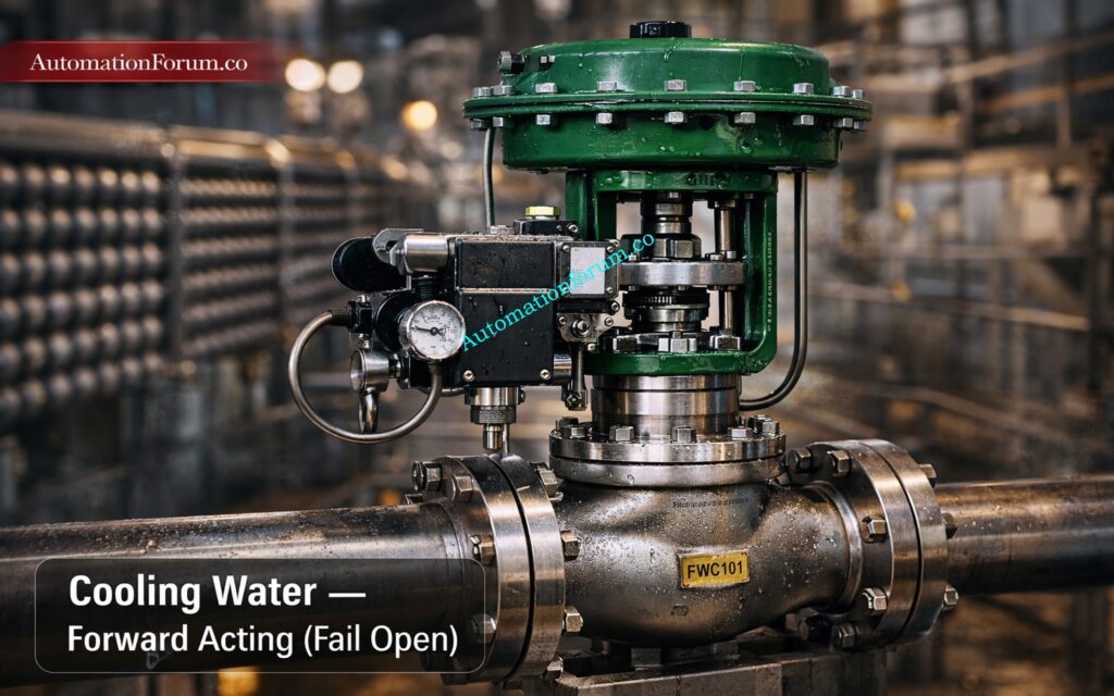

When to Use Forward Acting Control Valve in Process Industries
Forward Acting Control Valve in Cooling Water Systems
A forward acting control valve is selected when an increase in the control signal must result in an increase in flow or process effect. In simple terms, the valve movement follows the direction of the signal, meaning signal up leads to valve opening up. This direct relationship between controller output and valve position is fundamental in many process applications where increasing the manipulated variable helps correct the process deviation.
From an instrumentation design engineering perspective, forward acting valves are preferred in systems where the process requires immediate reinforcement of flow or removal of energy as the process variable increases.
Cooling System Control Logic Temperature Increase Flow Increase
In cooling applications, the process variable is typically temperature, and the objective is to remove heat efficiently.
- Increase in temperature requires more cooling
- Controller detects high temperature and increases output
- Valve must open to allow more cooling medium
Why Fail Open Valve is Preferred in Cooling Applications
This makes forward acting control valves highly suitable for cooling water circuits, heat exchangers, and jacket cooling systems.
In practical plant design:
- Reactor temperature rises
- Controller output increases
- Cooling water valve opens further
This ensures that heat removal increases proportionally with temperature rise.
From field experience, incorrect valve action in cooling loops often results in dangerous scenarios. If the valve closes when temperature rises, the system will move toward thermal runaway instead of stabilizing.

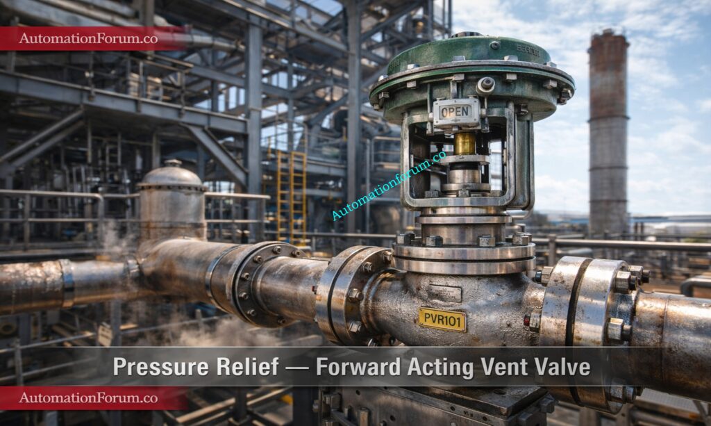

Pressure Increase Vent Valve Opening Strategy
In pressure control situations where venting or relief is needed:
- More discharge or venting is needed when the pressure goes up.
- As pressure goes up, the controller output goes up.
- To alleviate too much pressure, the valve must open.
Forward Acting Valve in Flare and Vent Gas Systems
Forward-acting valves make sure that pressure is lowered promptly and effectively.
Typical applications include:
- Flare systems
- Vent gas systems
- Compressor anti surge lines
To stop pressure from building up in these systems, there must be a direct link between the signal and the valve opening.

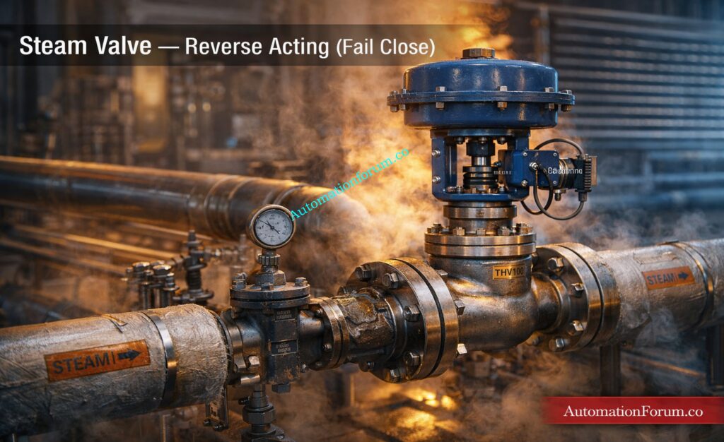

Reverse Acting Control Valve in Heating Systems
In heating applications, the goal of the process is to keep the temperature stable by managing the amount of energy that goes in.
- If the temperature goes up, the heating needs to go down.
- The output of the controller goes up.
- To lower the amount of heat coming in, the valve must close.
Reverse acting control valves are ideal for such systems.
- Heat exchangers
- Furnaces
- Thermal oil systems
Temperature Control Logic Reduce Heat Input
- Temperature exceeds setpoint
- Steam or fuel valve closes
This reduces heat input and stabilizes the process.
Refer the below link for the What are the main causes of control valve hunting?
Steam Flow Control Based on Temperature Feedback
Steam is one of the most common heating media in process industries.
- Steam adds energy to the process
- High temperature requires reduction in steam flow
- Valve must close as signal increases
Reverse acting valves are therefore widely used in:
- Steam flow control
- Temperature control loops
- Reboilers and distillation columns
From engineering experience, steam valves are almost always configured as air to open valve with fail close behavior to ensure safety.

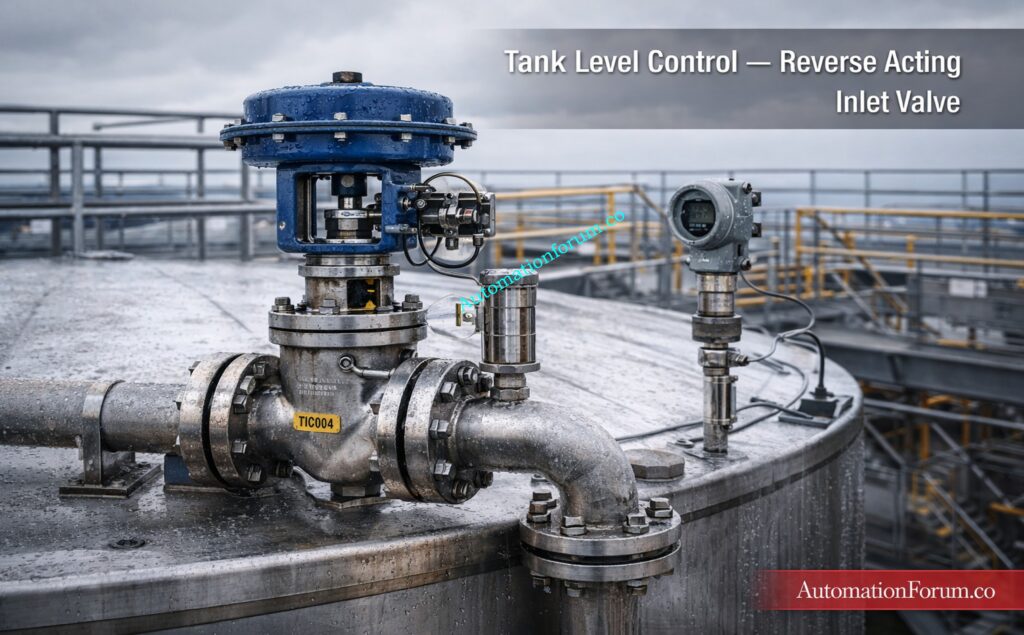

Reverse Acting Control Valve in Level Control Systems
In tank level control applications:
- High level requires reduction in inlet flow
- Valve must close
Reverse acting valves are commonly used for inlet control in:
- Storage tanks
- Process vessels
- Separator units
In this case:
- Signal up leads to flow down
- Prevents overflow conditions
Safety Considerations for Reverse Acting Control Valve
Reverse acting control valves are typically associated with fail close valve configuration, meaning:
- Loss of air supply causes valve to close
This is critical in systems where continued flow can create hazards.
- Steam lines
- Fuel gas systems
- Chemical injection systems
If air supply fails:
- Valve closes
- Energy addition stops
- Hazard is minimized
This aligns with the fundamental safety principle of isolating the source of risk.

Fail Open Valve Applications in Cooling and Safety Systems
Used when flow must continue during failure:
- Cooling water systems
- Fire protection systems
- Pressure relief systems
These systems prioritize safety over process efficiency.

Reactor Cooling Water Control Valve Example
The goal is to cool down the reactor.
- Valve type: air to close
- Fail position: open
Reason:
- If the temperature goes up, the cooling has to go up also.
- Fail open keeps the cooling going.
If you choose the wrong one:
- Cooling stops when there is a failure.
- The temperature of the reactor rises quickly.
- Danger of a runaway reaction

Steam Temperature Control Valve Example
The goal is to control the heating.
- Type of valve: air to open
- Position of failure: closed
Reason:
- Steam makes things hotter
- Fail near stops things from becoming too hot.
If you choose the wrong option:
- Even when it fails, steam keeps flowing.
- The temperature is too high.
- There is a chance of damage to the equipment.

Tank Level Control Valve Example
Objective is to maintain tank level.
Typical configuration:
- High level → valve closes
- Valve type: reverse acting
Fail position depends on process:
- Overflow risk → fail close
- Pump protection → fail open
If incorrectly selected:
- Tank overflow
- Loss of product
- Environmental hazards
