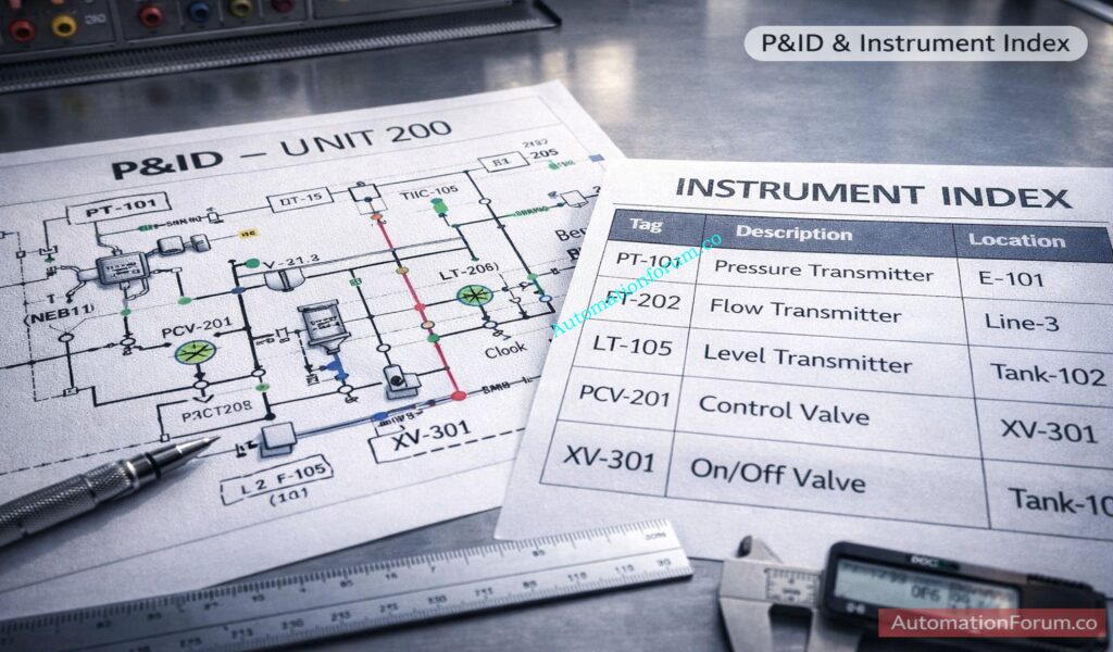

Responsibilities of the EPC Instrumentation Engineer
During HAZOP, the instrumentation engineer has to:
- Review Piping and Instrumentation Diagrams and instrument index before sessions
- Confirm measurement ranges and accuracy
- Evaluate alarm coverage and interlocks
- Propose additional sensors or logic when required
- Document recommended changes clearly
The engineer must make sure that actions are added to datasheets, control narratives, cause and effect charts, and loop diagrams after the session.

Pre-HAZOP Engineering Checklist
Before HAZOP, instrumentation engineers can utilize these list to get ready:
- Verify instrument index completeness
- Confirm measurement ranges match process design
- Review alarm set points
- Cross check safety instrumented functions
- Ensure loop diagrams are updated

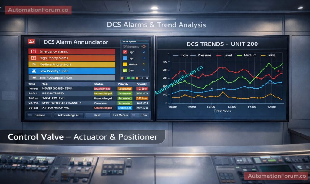

Human Factors and Alarm Management in HAZOP
Alarm Classification and Rationalization
HAZOP regularly points to warnings and manual operator actions as important safety measures. Technical safeguards can fail if alarms are poorly designed or if people anticipate them to work in ways that aren’t possible. Set up an alarm system that sorts alarms into groups, determines priorities, stops flooding, and organizes alerts that are connected to each other.
Operator Response Time Evaluation
Use HAZOP scenarios to run operator-in-loop simulations so that control room staff may practice emergency steps and diagnostic workflows. Give operators clear fast cards and checklists that list HAZOP-derived set points and activities, and plan regular drills to make sure people can do their jobs well when they are under stress.

What Documents Should Instrumentation Engineers Bring to a HAZOP?
Instrumentation engineers should have the latest P&IDs, instrument index, cause-and-effect matrix, control narratives, and alarm philosophy papers with them.
They also need to check datasheets, SIL studies (if they exist), and loop diagrams to make sure that the talks are technically correct..
