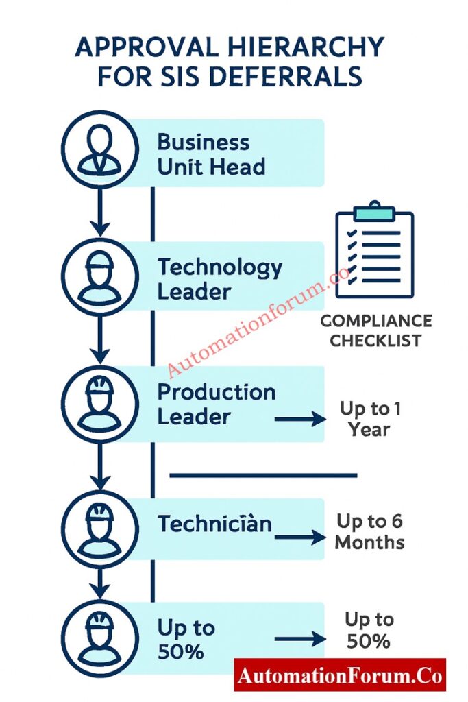

Approval Hierarchy for SIS Deferrals
Depending on how long the delay lasts and how risky it is, the deferral procedure has different roles and levels of approval. An approval matrix usually has:
Deferral LevelDeferral PeriodApproval Required From
Up to 50% beyond the scheduled intervalShort-termProduction Leader, Safety Leader, Technology Leader
Beyond 50% but not exceeding 100% (max 1 year)**Long-termTechnology Center In-charge, Plant Operations Leader, Business Unit Operation Leader
The IEC and best industry practice say that the longest time you can wait to test SIS evidence is one year. If you keep working without testing after this point, you are breaking the rules and exposing yourself in risk.
IEC 61511-1 says that any change from the set proof test or repair interval must be thoroughly explained and recorded.
Key points include:
  • For each deferment, write out a risk assessment.
  • Make changes to the records for the Functional Safety Lifecycle.
  • Use a formal Management of Change (MOC) process to handle things.
  • Put all approvals and risk assessments in the SIS file and LOPA documentation.
Deferrals that don’t have a good reason or a way to track their lifecycle are not compliant during safety audits.

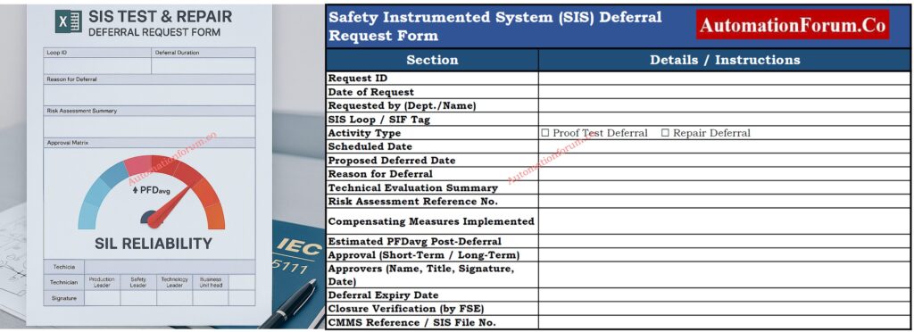

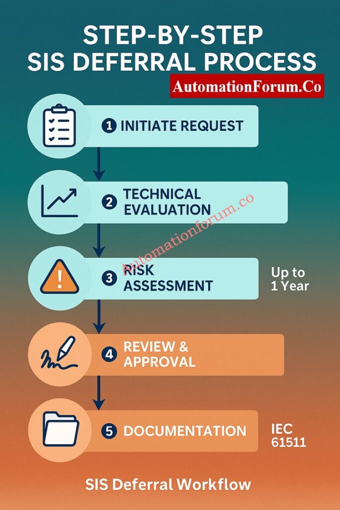

Step-by-Step SIS Deferral Process
When a test or repair cannot be completed as per the schedule, a formal SIS Test Deferral Process must be initiated. The following steps outline the best practice:
  • Find the exact SIS loop or part that can’t be tested.
  • Give a reason for the delay, such as the state of the process, the equipment being used, or production limits.
  • Put the due date and rationale in the maintenance management system.
  • Check the history of the device and any past failures.
  • If you can, do a visual check or a test of some of the functions.
  • Do new PFD calculations to see how extending the interval may affect the risk.
  • Check how the postponed testing affects the Safety Integrity Level (SIL) goals.
  • Put in place temporary fixes, like more alerts, monitoring of operators, or duplicated loops.
  • Get the necessary approvals from the people listed in the Deferral Authorization Matrix.
  • Make sure that the risk assessment is agreed upon by safety specialists, maintenance leaders, and production chiefs.
  • Tell all the departments that will be affected (Operations, Maintenance, Safety, and Engineering).
  • Include the postponement in both the SIS File and the LOPA (Layer of Protection Analysis) papers.
  • Make a clear recovery plan to make sure that testing is done in the time frame that was set aside.

Download SIS Deferral Procedure Template (IEC 61511 Compliant)
Make sure that all of your Safety Instrumented System (SIS) testing and repair delays are completely documented and meet IEC 61511 standards. This professionally designed template lets you ask for, evaluate, approve, and keep track of all SIS proof test or repair deferrals. It has fields for risk assessment, approval matrix, and closure verification. Great for Functional Safety Management (FSM) and preserving records that are ready for an audit.
