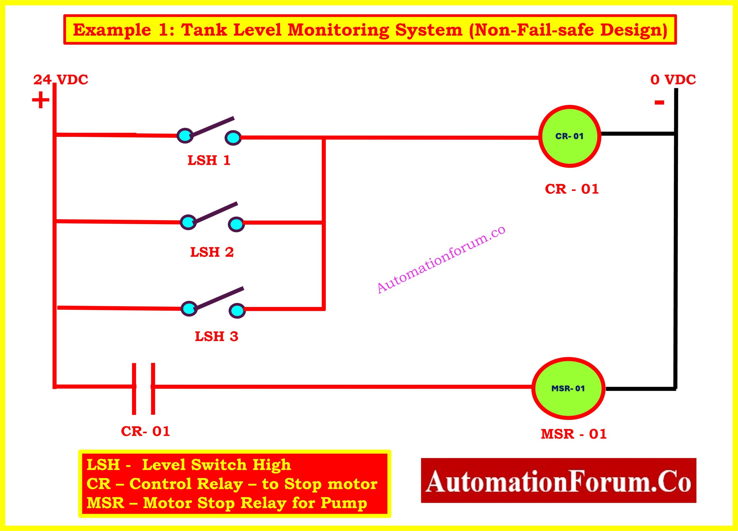

Example 1: Non-Fail-Safe Tank Level Monitoring System Using NO Switches (Parallel Logic)
Application: Level switch based overflow protection in a storage tank.
Description:
Three level switches (LSH1, LSH2, LSH3) in this example are connected in parallel and all have normally open (NO) type of creation. Directly connected to a control relay (CR-01), the switches power a motor stop relay (MSR-01), therefore stopping the pump supplying the tank.
How it Works:
- Normal conditions see all switches open and the pump running continuously.
- Should any level switch detect a high level that is, floats up it closes and completes the path from the 24VDC supply to the relay coil (CR-01).
- MSR-01 is triggered and energised by CR-01, therefore stopping the motor.
Weakness in Design (Non-Fail-Safe):
This is a non-fail-safe circuit because:
- This is not a fail-safe circuit as, should any wire connection break shown image below), the relay will never be energized even in case of tank overfills.
- The system assuming the switch or wiring will always be functioning. Should a breakdown occur, the pump runs nonstop, running at the risk of an overflow.

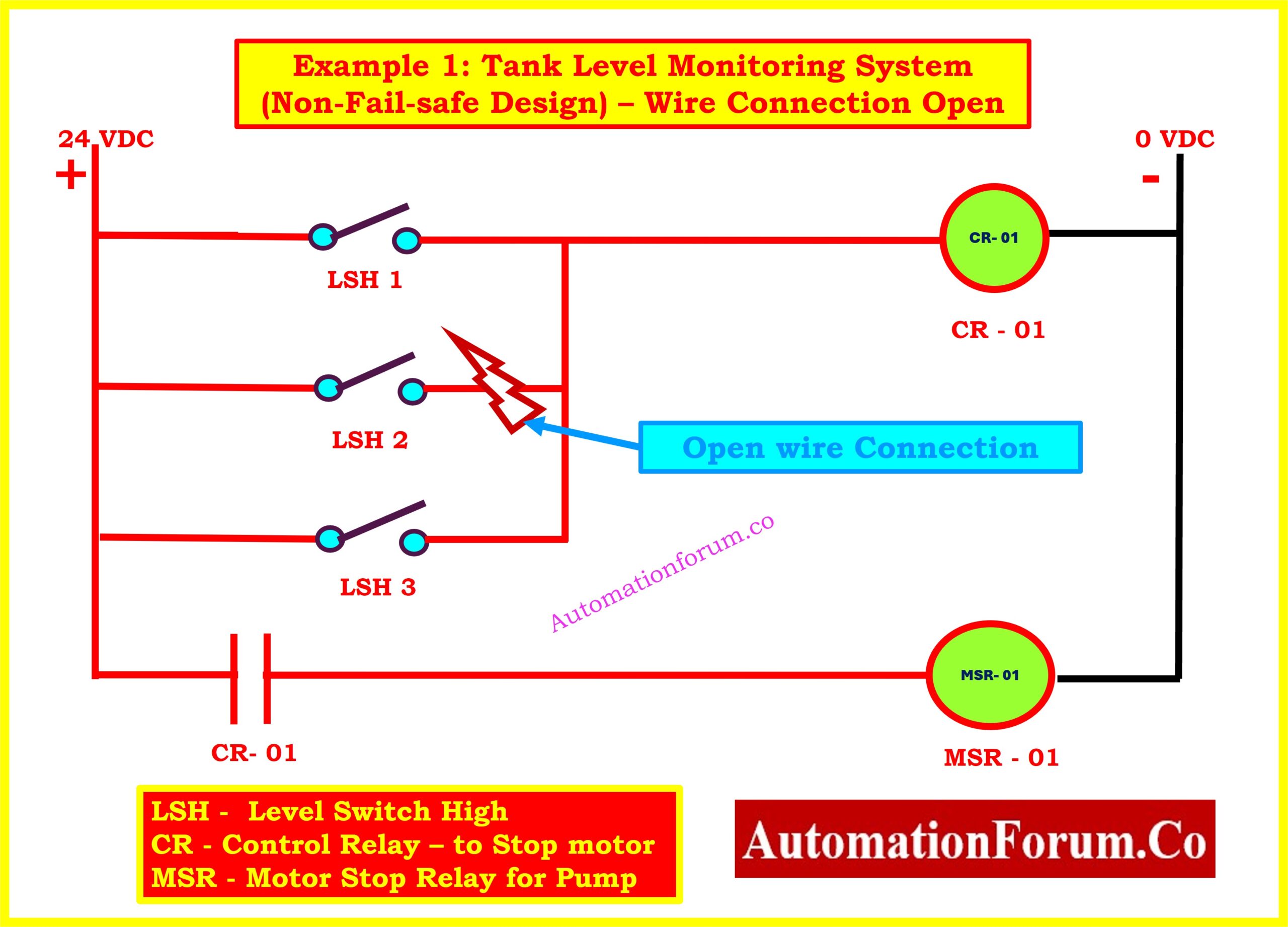

Open Wire Issue:
An open wire ((highlighted in blue) in LSH2 keeps the relay from energizing even if LSH1 or LSH3 finds a high level. Silent failing makes the process potentially hazardous.

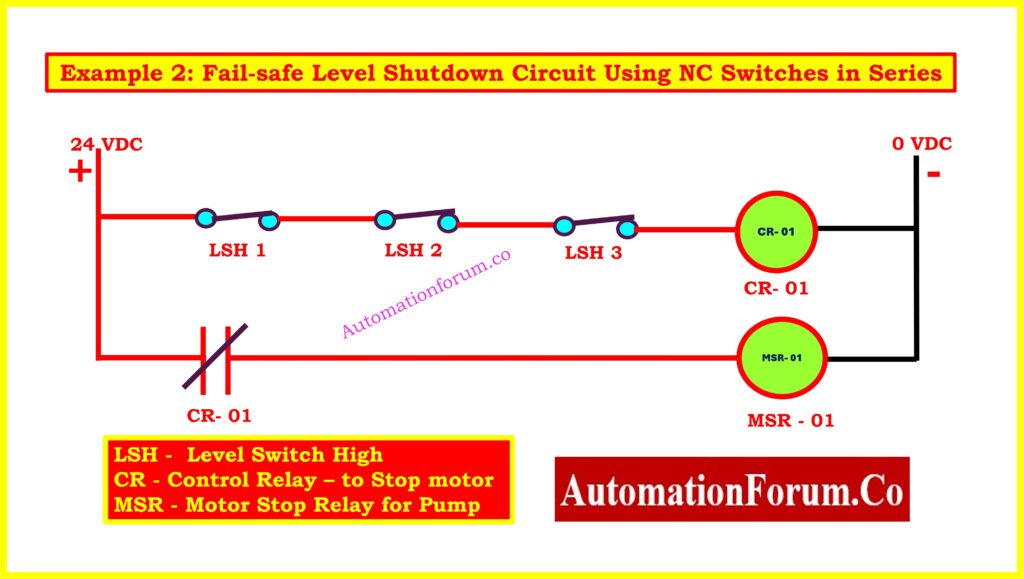

Example 2: Fail-Safe Level Shutdown Circuit Using NC Switches in Series
Application: Designed with a fail-safe philosophy, the application is pump cutoff on high-level detection in a sump or tank.
Description:
Three usually closed (NC) level switches (LSH1, LSH2, LSH3) wired in sequence make up this example. The control relay (CR-01) powered by the series circuit energizes MSR-01 to maintain the pump running.
How it Works:
- Under normal level conditions, all NC switches remain closed, and the relay is energized. The motor continues to run.
- If any one of the switches opens due to:High level being reached (actuation), Switch failure, Open wire fault, then the CR-01 gets de-energized, which in turn de-energizes MSR-01 and immediately stopping the motor.
Why this is Fail-Safe:
- The pump will be turned off even from a power outage or a wire failure at any switch.
- It does not rely on a working signal to stop the motor instead, the absence of signal causes a shutdown.
- This approach detects faults by default and acts safely.

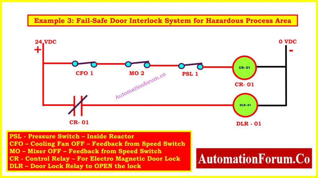

Example 3: Fail-Safe Door Interlock System for Hazardous Process Area
Reference Circuit Diagram:
Component Legend:
| Symbol | Label | Description |
| PSL | PSL-1 | Pressure Switch (inside reactor) NC contact used |
| CFO | CFO-1 | Cooling Fan OFF feedback – NC contact from fan’s speed switch |
| MO | MO-2 | Mixer OFF feedback – NC contact from mixer’s speed switch |
| CR | CR-01 | When all conditions are safe, CR-01 Control Relay activates DLR relay. |
| DLR | DLR-01 | Door Lock Relay – opens the electromagnetic lock when energized |
| 24VDC | Power Supply Typical industrial 24VDC control voltage |
Explore why 24VDC is the preferred voltage in industrial automation environments: Why is 24 Volts Mostly used in Industrial PLC Systems?
Working Principle:
Using normally closed (NC) contacts, this series fail-safe circuit addresses all three safety criteria:
- Power Source: When all is safe, the 24VDC supply powers the circuit.
- Safety Chain:
- CFO-1 (Cooling Fan OFF): This switch is closed when the fan is stopped.
- MO-2 (Mixer OFF): This switch is closed when the mixer has fully stopped.
- PSL-1 (Low Pressure): This switch is closed when the pressure is within the safe range.
- All three switches must be closed for CR-01 to be energized.
- Control Relay (CR-01):
- When CR-01 is energized, its auxiliary contact closes and allows current to flow to DLR-01, the Door Lock Relay.
- DLR-01 Function:
- Energizing DLR-01 opens the electromagnetic door lock (fails in the locked position by default).
- This means the door can only be opened when all process parameters are safe.
Learn the foundational elements of Ladder Logic used in PLC programming: Understanding Basic Parts of Ladder Diagram (LD) in PLC Programming
What Happens on Fault or Unsafe Condition?
This is where the fail-safe design comes into play.
| Condition | Result |
| Any one switch (CFO, MO, PSL) opens | CR-01 de-energizes |
| CR-01 de-energized | DLR-01 de-energizes then Electromagnetic lock stays locked |
| Open wire or power failure to any switch | Same as unsafe condition then door stays locked |
| Relay coil failure (CR-01 or DLR-01) | Door remains locked due to loss of energization |
So, even if a wire breaks or a relay fails, the door does NOT unlock, which is the essence of fail-safe behavior.
